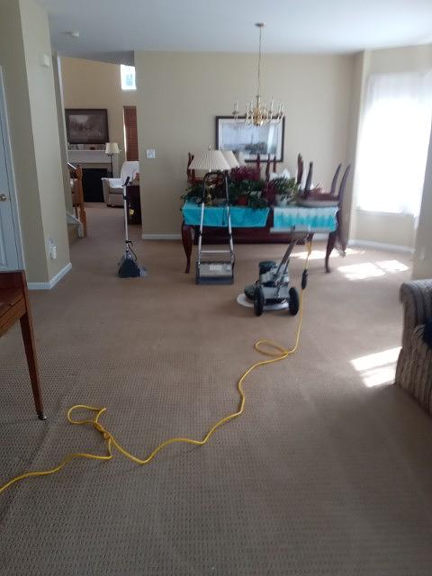

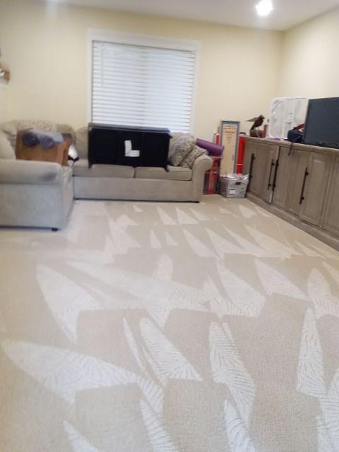

Vacuum
Prespray with Worx Sprayer and Carpet Details
Scrub with Brush Master Pro 35 14'' CRB
Extract with Trinity Odyssey
Groom

Vacuum
Prespray with Worx Sprayer and Silver Solution and Detonator (Peroxide)
Extract with Orbot Vibe TL and Cotton Bonnets
Groom with 10'' CRB
