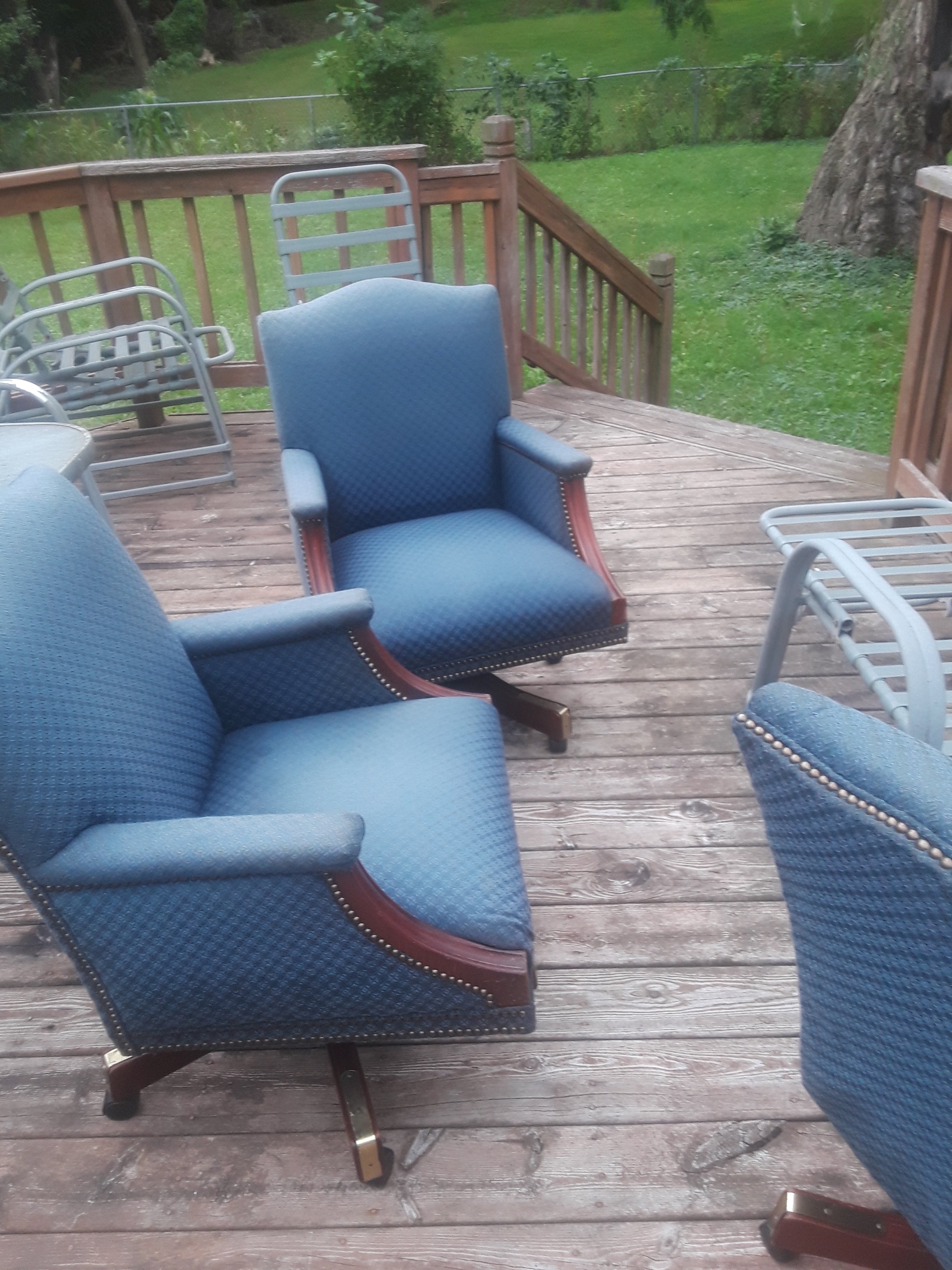

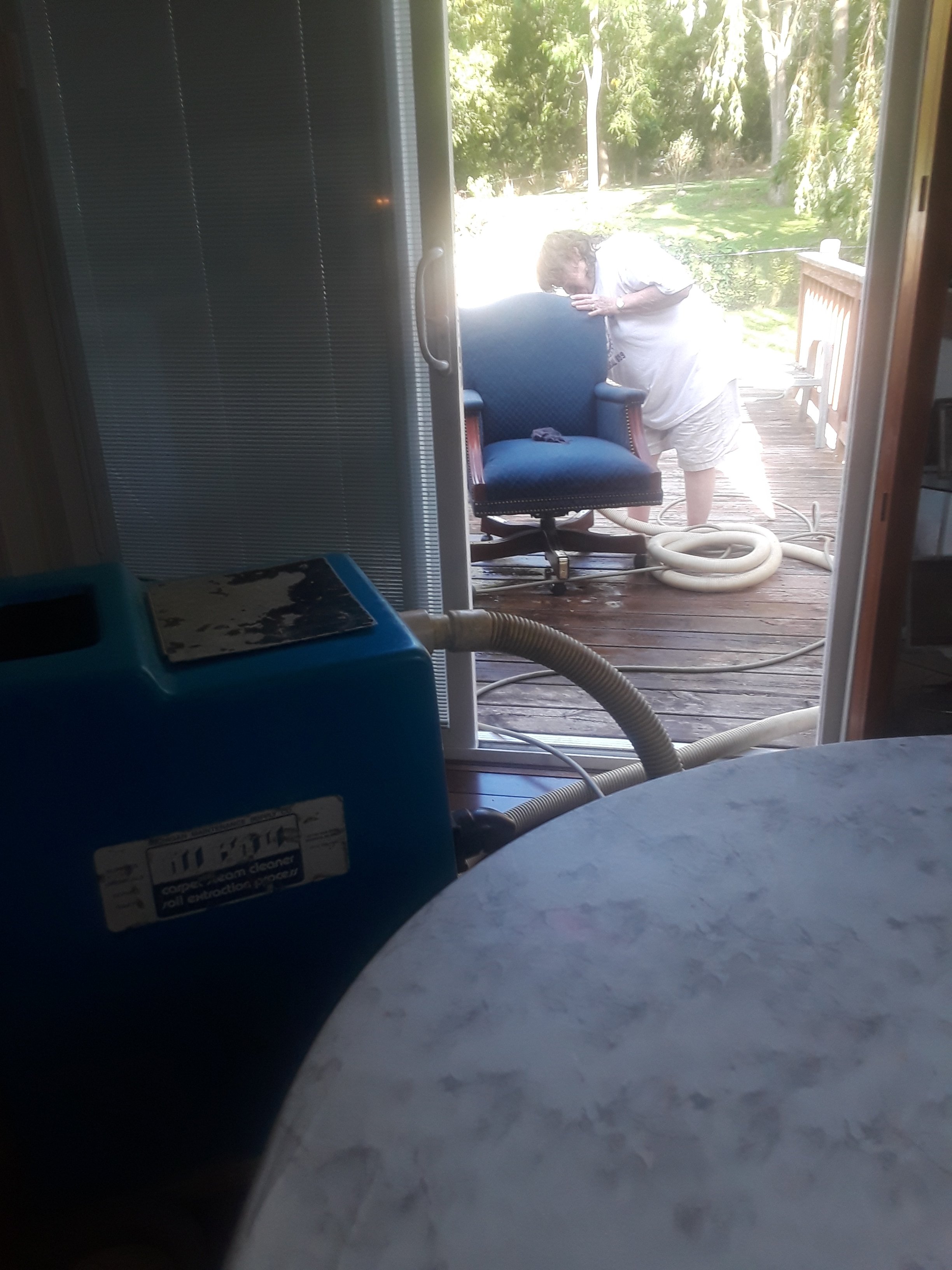

Art Kelly gave me this: I have no idea
What it is but it does a great job on the hen chairs...

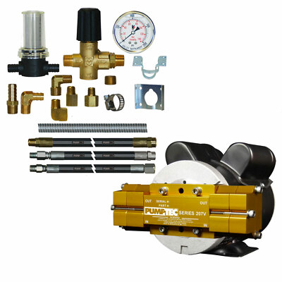

Put a bigger low amp pump in it. Kleenrite has a cat 1xp for $300. You will need an unloader but the boost in psi will put a smile on your face. Total with shipping and customs etc. was around $500. Add the unloader on to that. And then we can talk about getting those vacuums in parallel.with a manifold.
