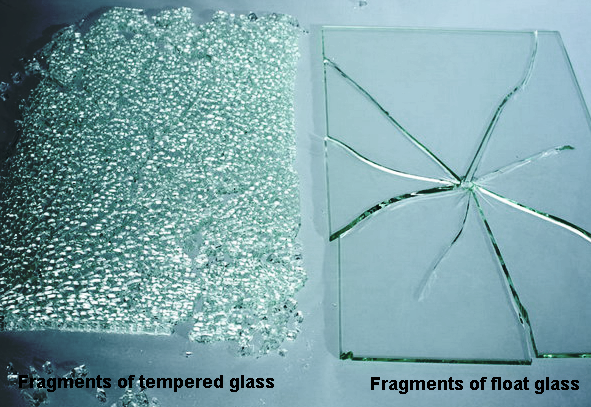

tempered glass shatters into a kabillion little pieces and tiny shard slivers
and if a slider, it was tempered glass ..it's the law
If cut pile, no way in hell you'll get it all out ...to give any kind of assurance of such, you'd be either stupid or ignorant ...or both

anyone that's seen and cleaned up shattered temped glass would know the challenge of vac'ing 40 pounds of rice scattered on a cut pile
