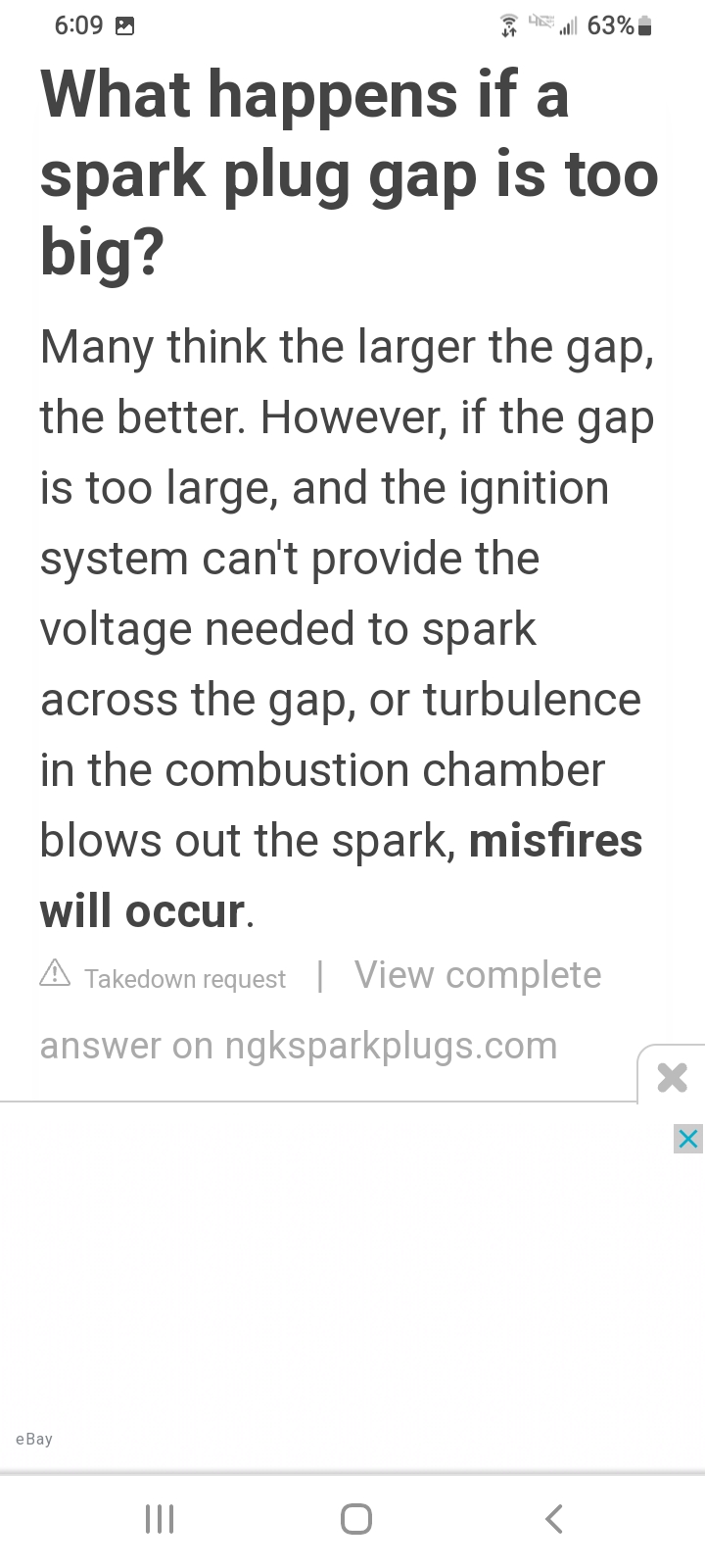

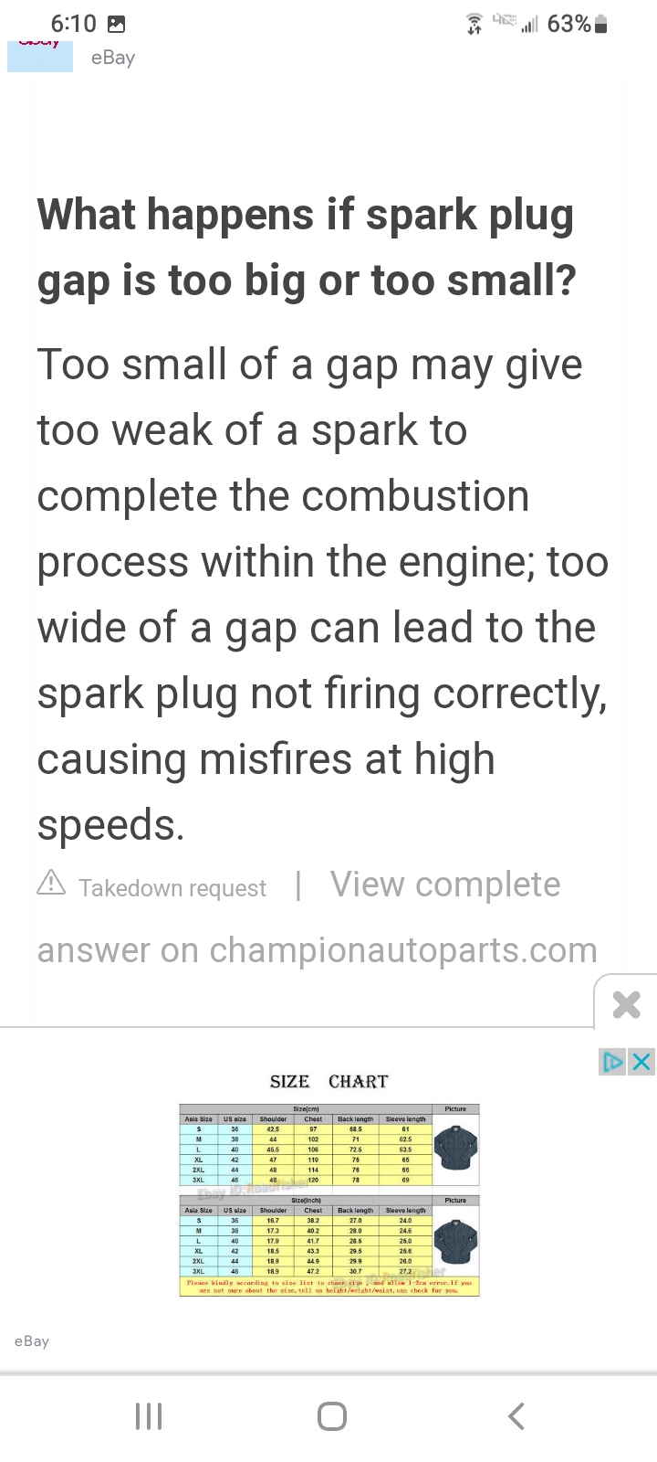

It's possible the engine wasn't producing the power needed....how far off was the gap
I'm assuming the two times it was checked they at least ran it through the rpm range where this would usually be evident
