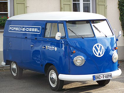

20 HP honda motor powering a 45 blower and general pump, 40 gallon waste tank with an apo that never fails, one of Bob Savages propane heaters with a properly installed belly tank. Installed in a mini van that has yet to be built. 1 ton chassis with a fuel efficient 4 cylinder engine, not taller than 6' 4" with a long wheel base. Imagine an extended Chevy Astro van. My perfect city carpet cleaner.
This setup in one of these. Or a TCS Chief would work.
