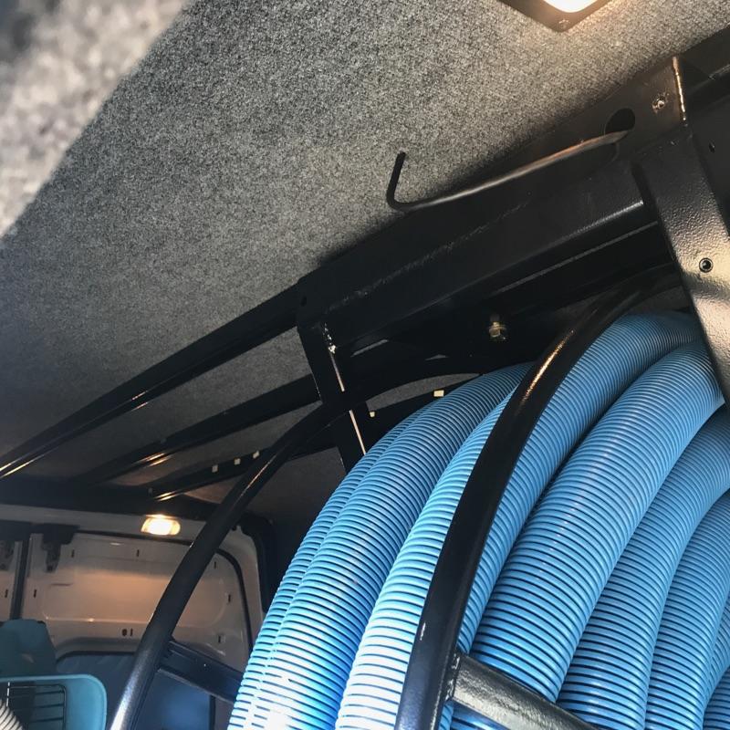

:headscratch: I was expecting to see the solution hose reel on the ceiling !!
I would have thought the vac hose and reel would be too heavy for the roof or mounting bolts.:eekk:
with all the bumps and pot holes in SF streets I don't think this would work for us.:dejection:
Jim Martin
10,877
Jim Martin

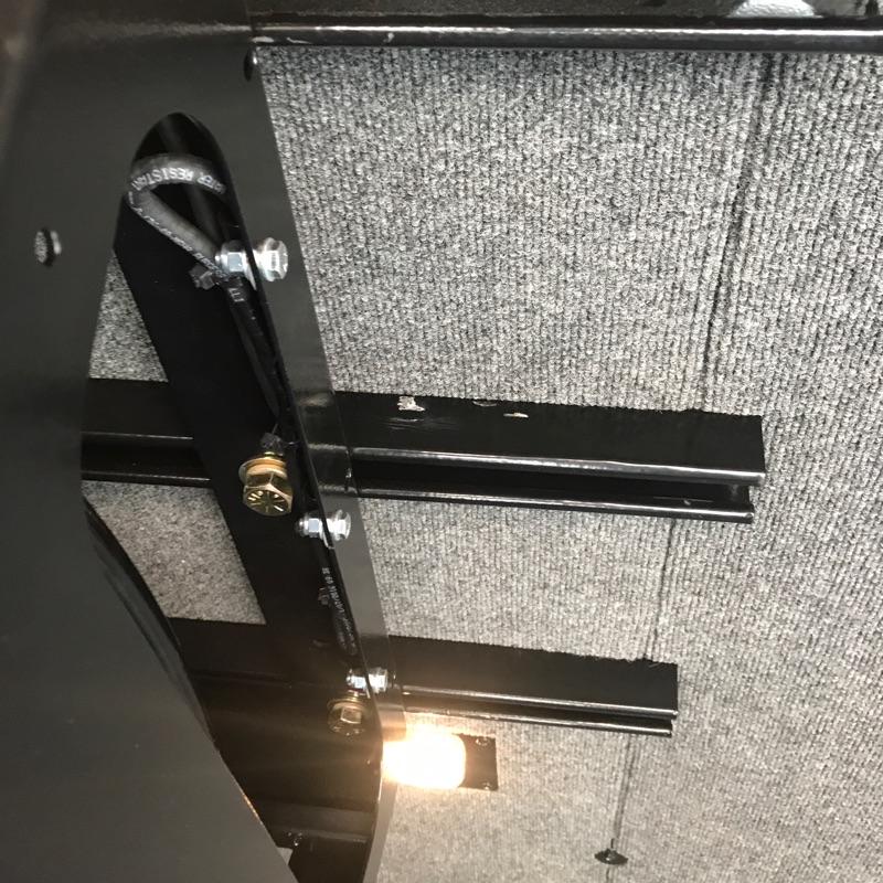

I like it...looks like a good space saver......but on the flip side...that seems like a lot of weight to be hanging off the top with no vertical supports to help pick up the weight...looks like they have the channel running across the ribs on the roof.....but all that reel and hose weight is concentrated in on spot...stop and starting...it is going to flex from front to rear...and all the jolting around...unless it is seriously braced and we just can't see it..I would be afraid that in time the roof would start to sag.........
14,634
I've never seen this specific reel up close, but the majority of them are wobbly, due to how thin the skeleton is. If that reel is the same way, just think about how that thing wobbles and sways 1/2 inch constantly back and forth. It looks good, and is using wasted space very well. I'm just concerned about how long it'll last like that with the way we drive our vehicles
117,323
Sapphire/Prochem reels are the real deal. I had one in my Judson set up. Very stout.

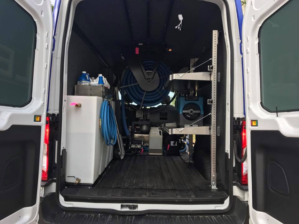

Looks very secure. I always wonder if the space you save is worth the effort of flipping it.
I've thought about it when putting a unit together. The last one we just went with the extra tall and narrow reel to get maximum use of the space. I also thought about the box beneath and mounting the reel on top of the box like Lee did.
In the end all but the the one with the extra tall reel are conventional installs.
18,851
Lee Stockwell
Had 10" of dead space over the reel, so when we took it out to convert to electric I built the box to fit. To install had to suspend the reel and slide the box under it.
Had to credit Jim Bethel and his dad.
narrow on the roof of a hi-top would be the cat's azz I think (less/little no value in a standard height van)
This contingent on solid enough support w/roof mounts
On a raised box/shelf/pedestal would be second best (and certainly easier/less roof support concern )
Only reason I say "second best" is due to having supports/frames/side walls on floor instead of wide open/nothing in the way floor space
Duane's gives you a 300 foot in the space of a 200. Its a nice reel and love the space savings while still getting the extra hose.
