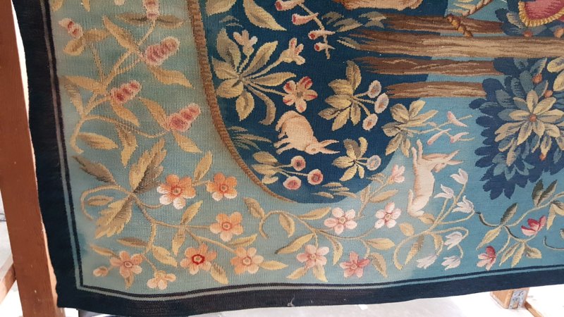

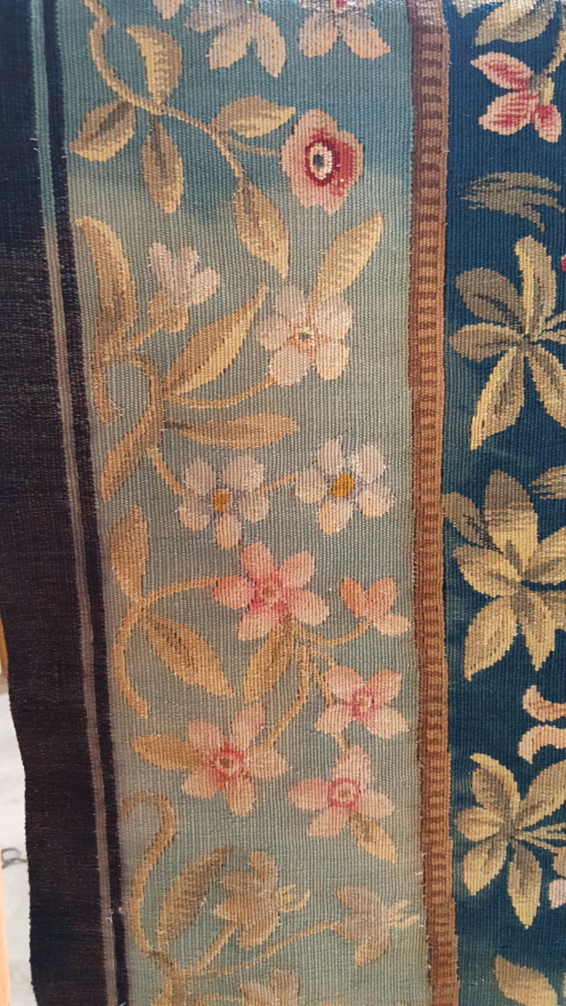

Could your rug shop fix this peroxide damage?
117,380
Owner user peroxide to remove a urine spot..
@Chris Howell could you air brush around all those flowers?

I did witness Chris air brush the field of a faded blue Chinese rug with some intricate designs. I believe the flowers in the photo would be no obstacle. It just requires time and patience and a good eye for color. None of which I possess.

Yes, we would have no problem to airbrush the color back in around the patterns of this rug. Any one of my trainees could also do it as I teach Persian Rug color restoration in our trainings. Here's a video of our trainees restoring the field areas of a Persian Rug at one of our recent trainings.

Where is this rug located? Does the guy need someone to repair it for him so that he doesn't have to buy it?
