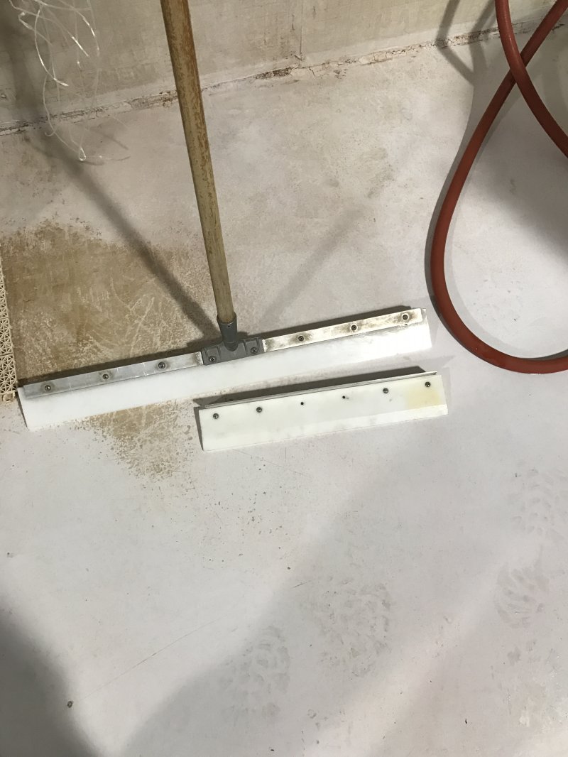

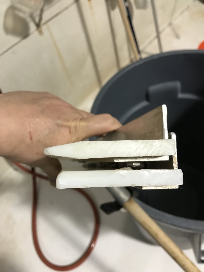

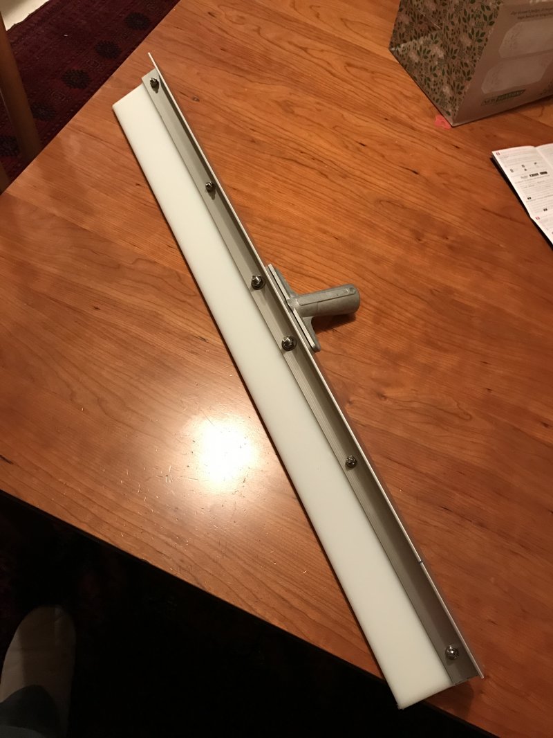

Different strokes for different pokes. A glided wand reduces agitation by allowing a fat piece of plastic to skim over the carpet surface. A wide scraper tool also might have a tendency to skim the surface without much compression. A narrow plastic under a heavier tool on a soaked and lubed up rug...
(We have roll-a-jet washer, so don't need this tool. I was thinking of all the people that could use a better method of soil removal until they have enough work to spend the 350k.) Knowing how the compression roller works in the machine, I believe a roller head would be better, as it would be less likely to damage a fragile rug (be more idiot proof). This is the "urban/backwoods/quick and easy/we have one of those" version.

Teflon is DuPont's brand name for PTFE, but HDPE and PTFE are interchangeable for this purpose. Thanks for the accuracy check.
