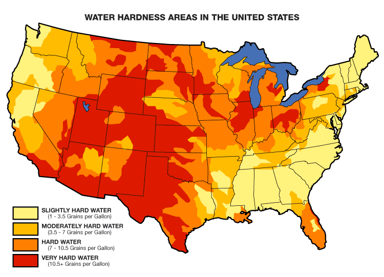

Nice to see my location in MI is Very hard water eekThe higher the heat of the truckmount gets you closer to vapor, the more the minerals want to separate from the water attaching to metals in your truckmount system. So 7 grains with high heat could act more like 10 grains. Water is soluble, vapor is not soluble. We get reports that high heat truckmounts are impacted more by minerals forming hard water than typical truckmounts. Of course an operator can choose when he needs high heat and turn it down when he does not need high heat.

Seattle is very soft water, less than 70ppm
