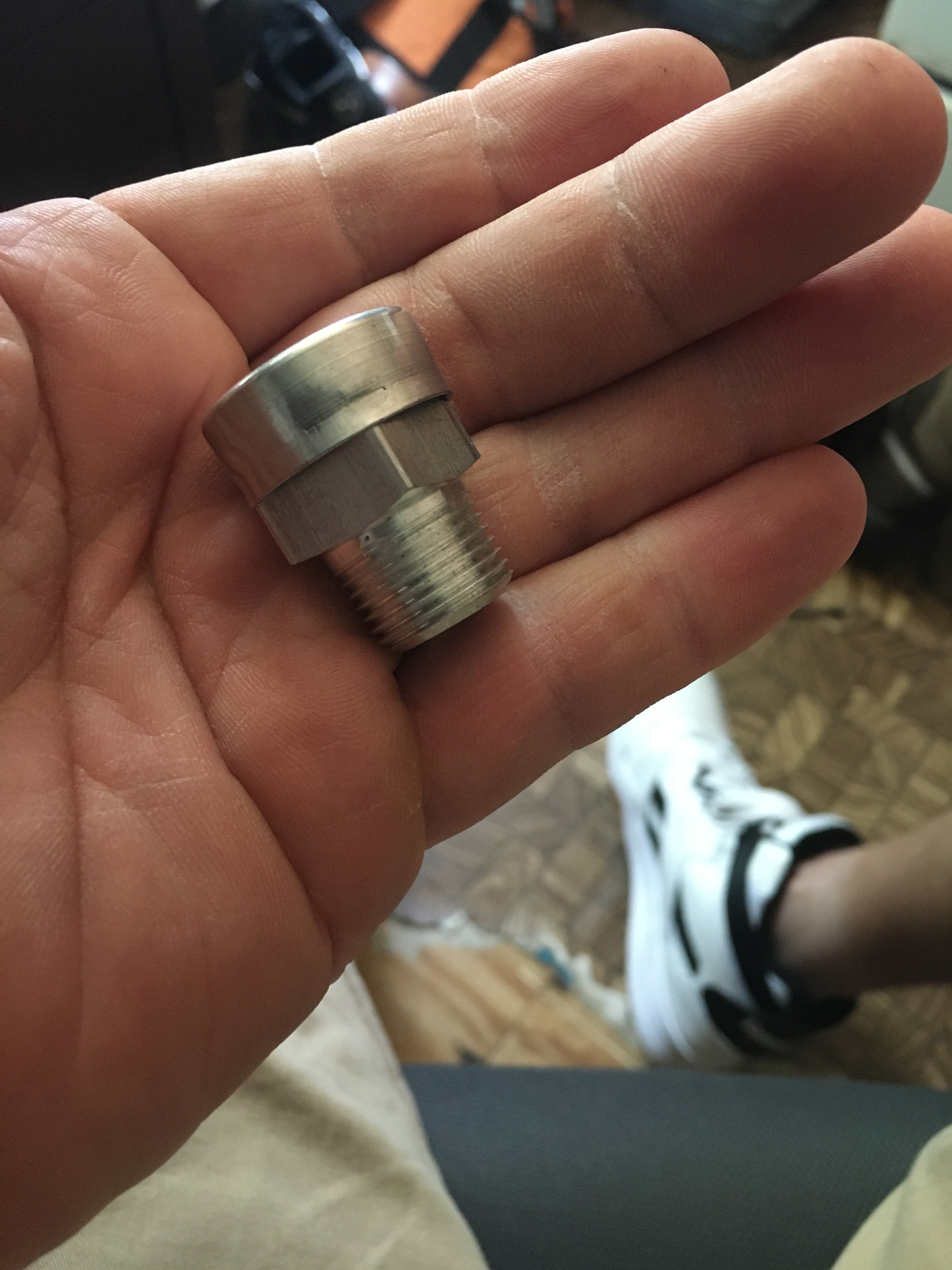

I contacted gardner Denver on getting these brass filters. I can’t find them anywhere

I like to replace with original parts. It seems prochem made the decision to put this type of breather cap on the blower, because my conversation with GD this morning informed me that they put just a hex plug in that hole.
I got in touch with CleanSource in Columbia and they’ve been replacing that overpriced part with a grainger breather cap they’ve been using for over 6 years with no problems. I ordered 2 of them and I’ll show the part number and pic as soon as it gets here.

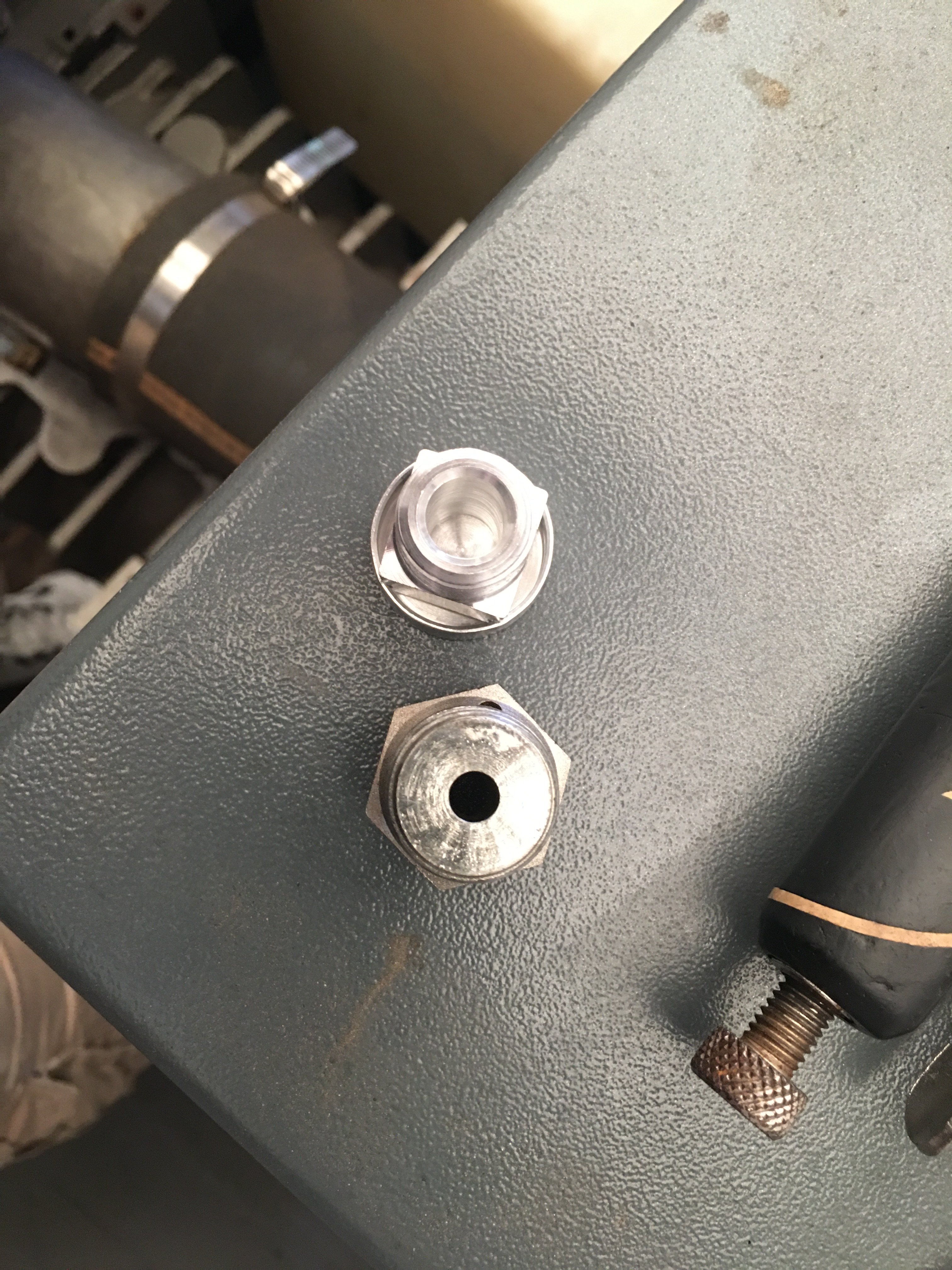

This is what CleanSource in Columbia has been putting on the blowers for 6 years. He told me he’s seen no problems.
A pinhole breathing tube on the one with the stone or a 1/4” breathing hole on this one helping the heat escape makes more sense.

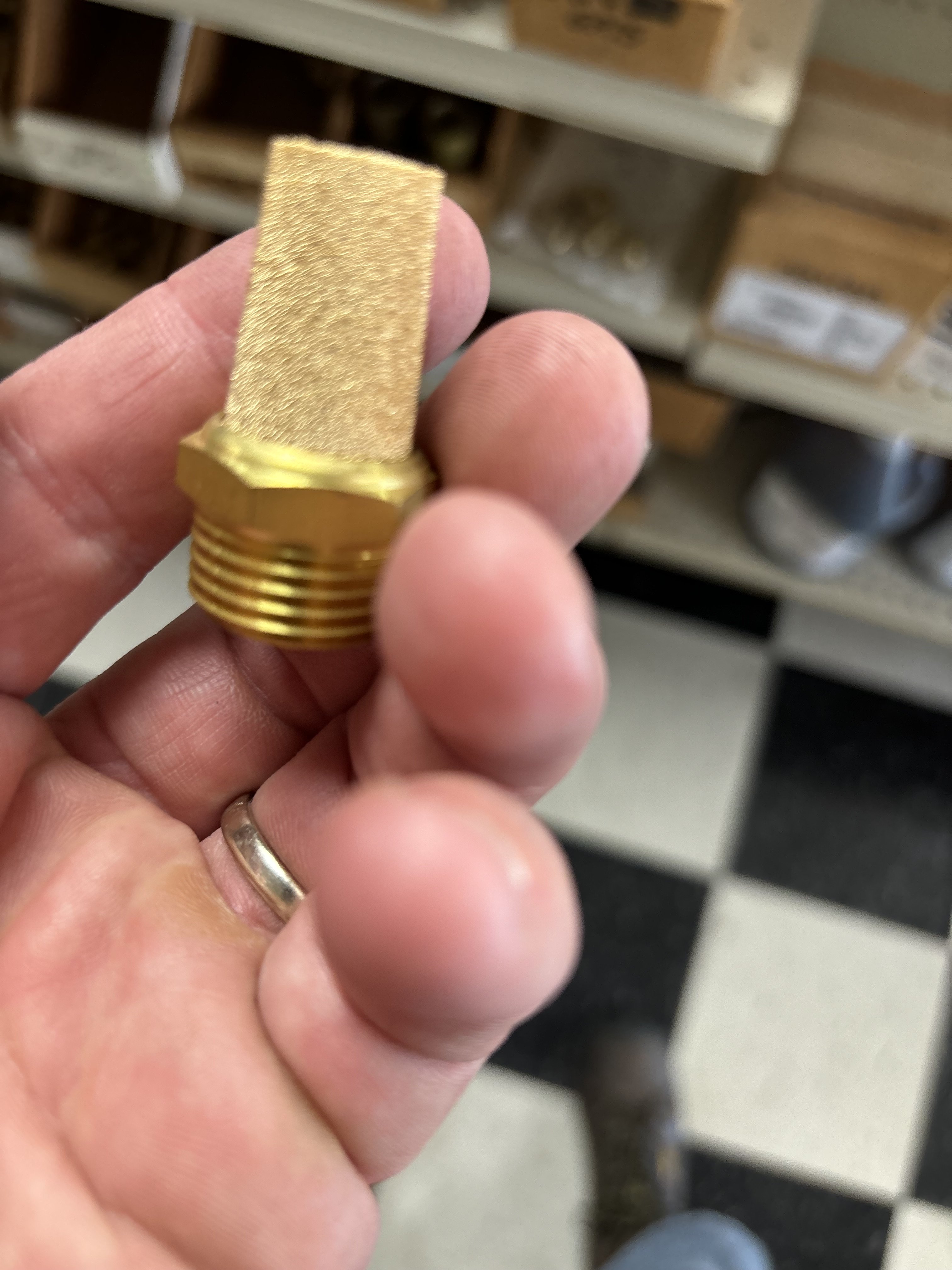

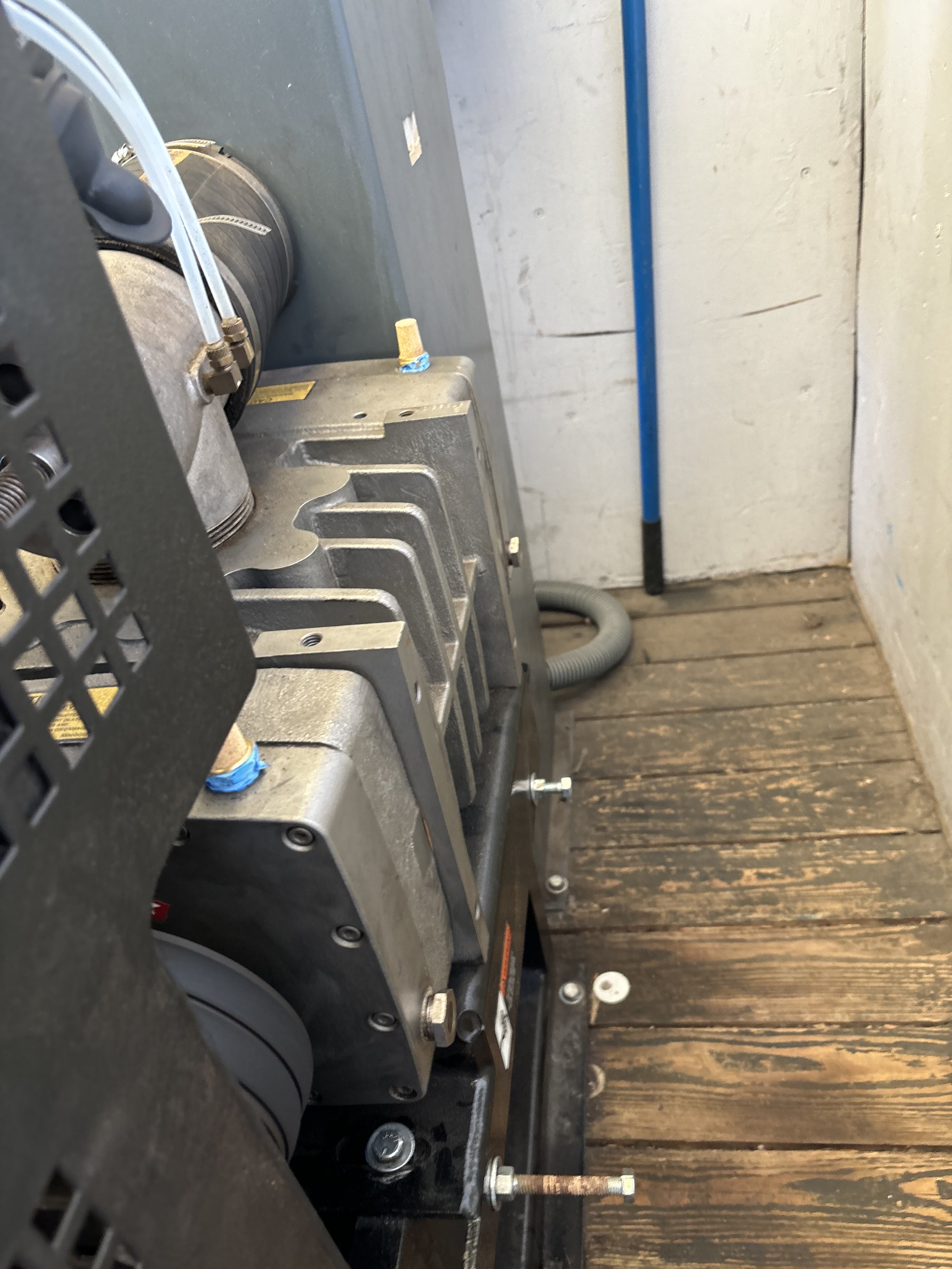

I found these brass mufflers on the shelf of my industrial supply store today when I was buying some new belts today. I figured I'd get a couple and see how well it works. I made a couple calls from the 2 guys I trust for these kind of technical questions and they both said yes.
It went through 5jobs today (9hrs) and it seems to work great
The hole to breathe is 10time bigger diameter than the tiny hole in the stock cap
And I don’t see any way for this brass filter to get wet with oil like the little filter does so it shouldn’t build up pressure in the blower since it’ll breathe better
9hrs and the filter stayed dry. I’ll update more about a month from now
