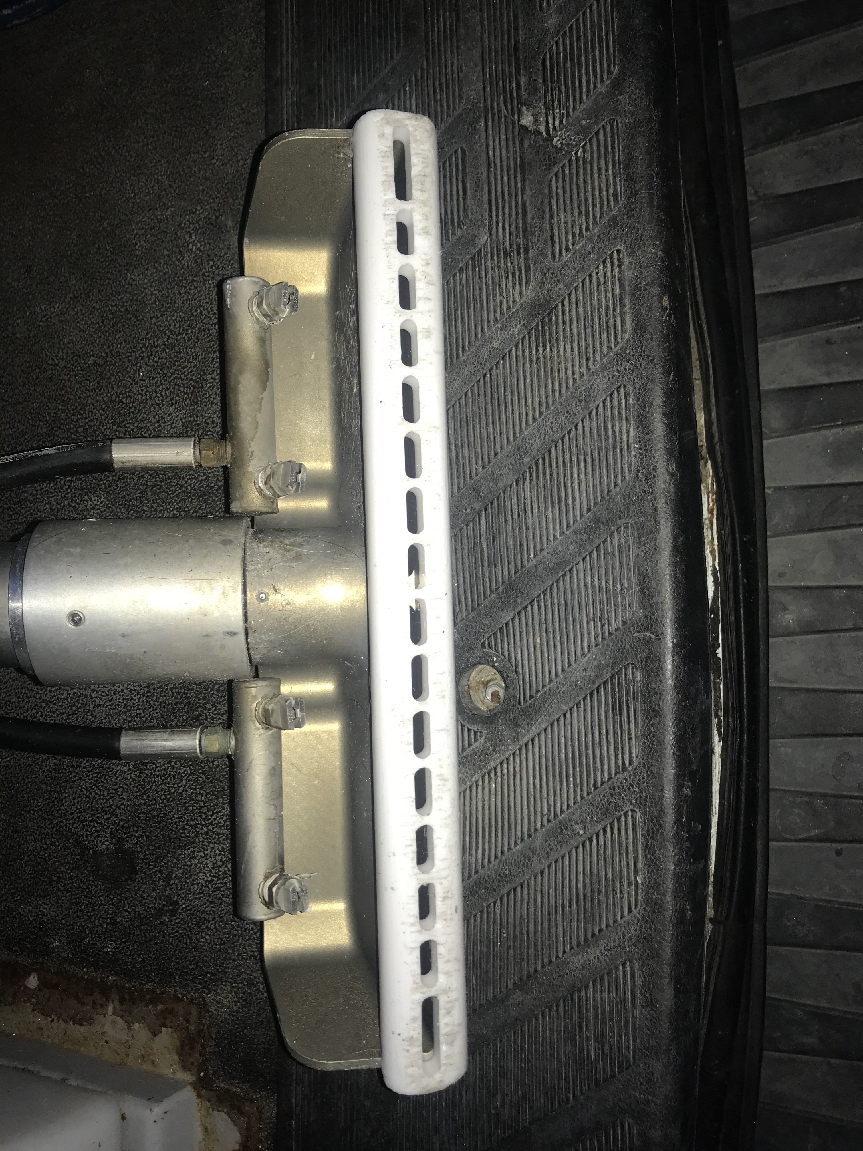

You need a controlled air leak at the wand.
I take my 2" to 1.5" hose cuff and drill 4, 1/4" holes spaced evenly, at the beginning of the 2" to 1.5 " conversion point, and can push it onto the wand further to stop the leak, or back off and create a controlled air leak.
Your dry times will get much better, and you will eliminate the lock-down. This also works great for using an upholstery tool to create a small air leak so the tool doesn't lock to the fabric.

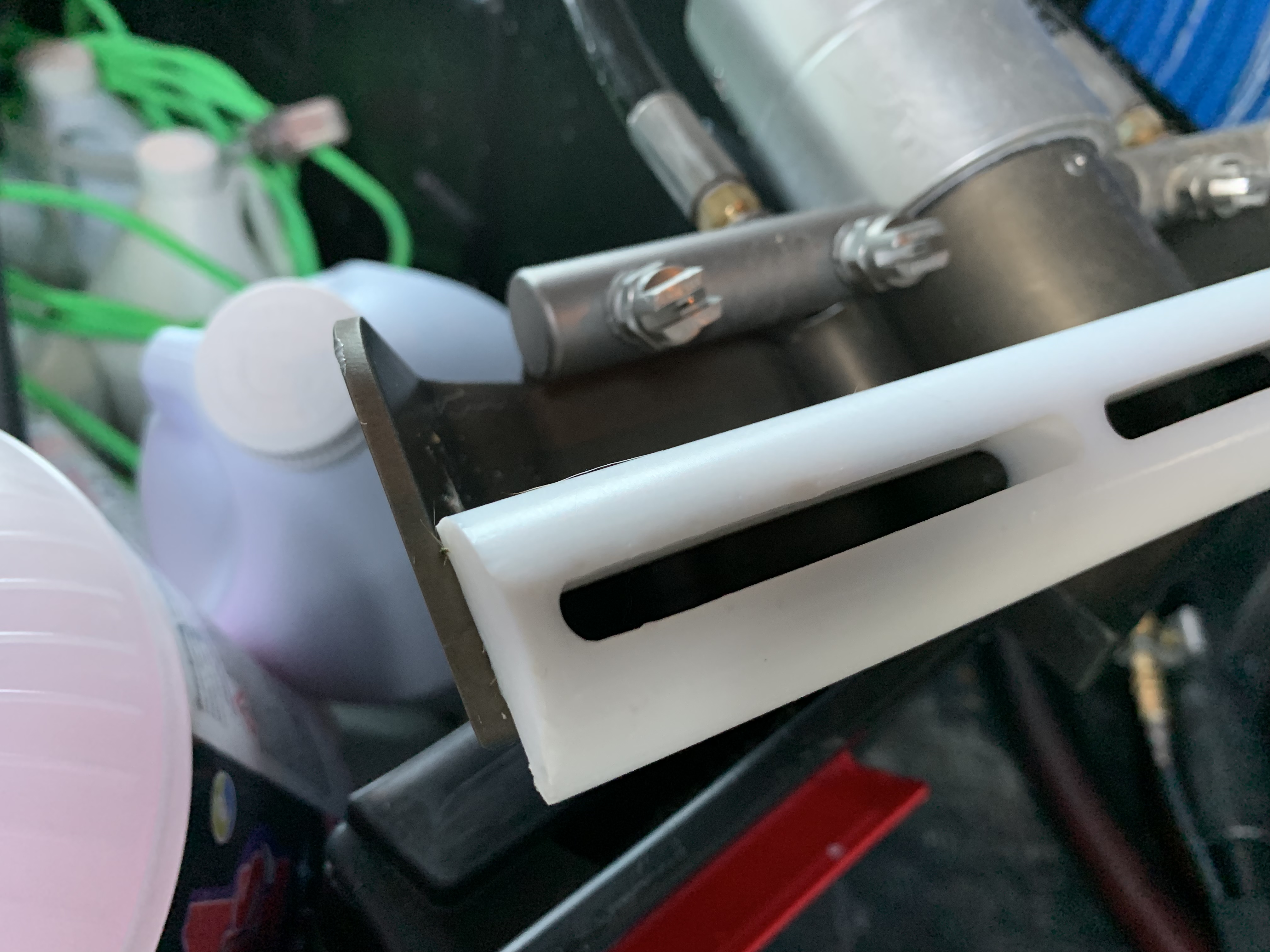

Makes sense. When the Devastator is locked down, all goes silent. Definitely no airflow. At least not on longer yarned carpet.

Greenie told me, many years ago, not to seal the ends of glides because they need a leak there.
How does an intentional leak anywhere upstream of the glide help?
Reactions: Trip Moses
117,330

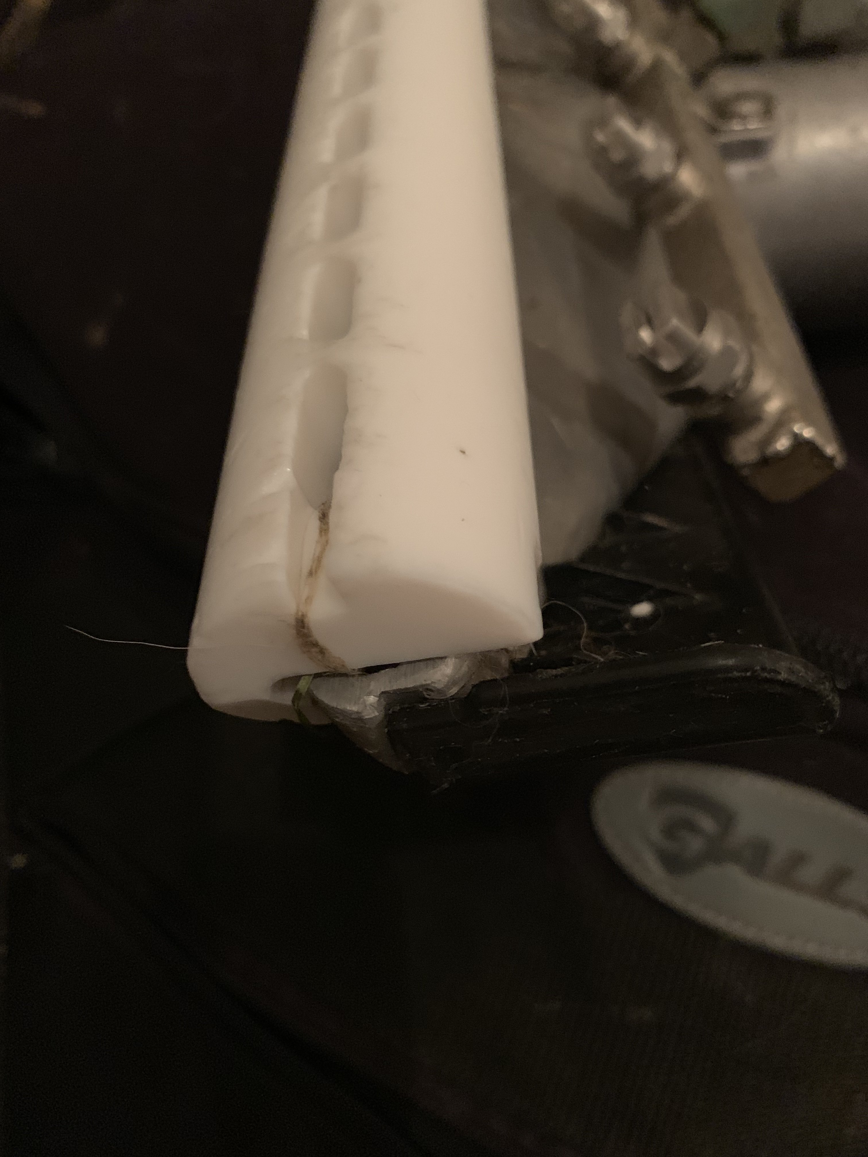

Take a Dremel or box knife and cut a channel on both ends
And try that 8 ft whip hose, that wand has too much suck to go 2" all the way
Or get a bitty mount instead of a big mOunt that has too much performance for such a remarkable wAnd....
Or just choke down your TM to Bane specs......

I tried the whip. Still locks. I’ll carve out some channels - I bet that’ll do it. The wand probably needs to breath.
