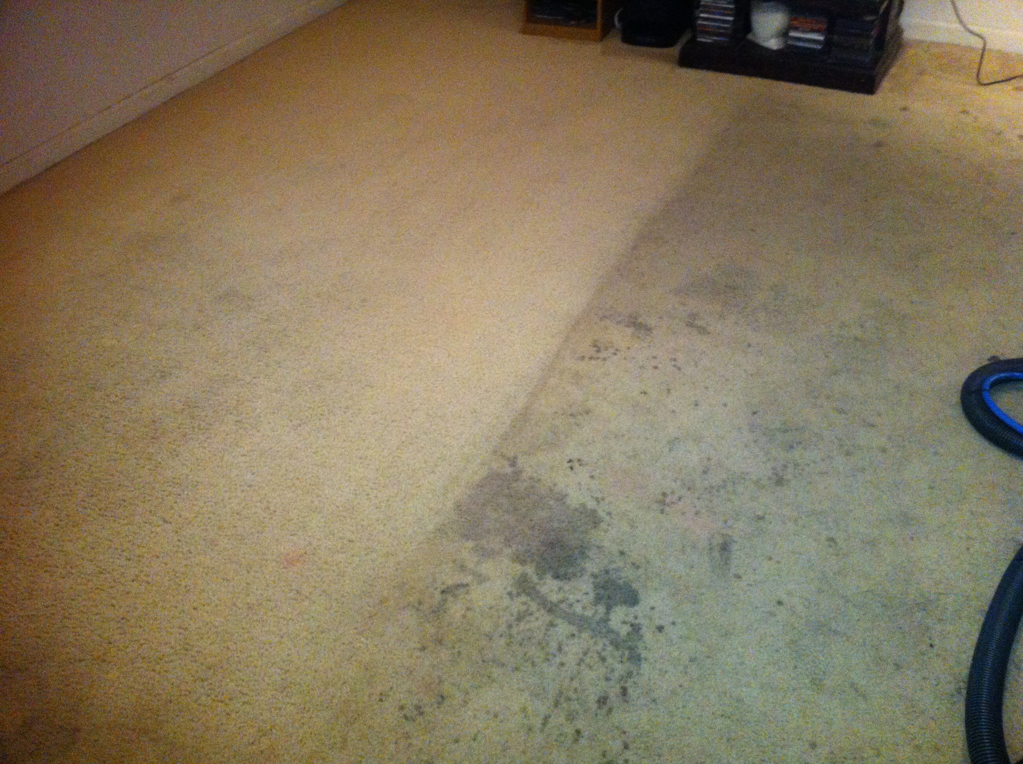

I had 4 jobs today that I had to use my triple 30/10 on. I then added some d-Lim in, broke out the 17” Brushpro, and went to town.... I inherited a contract from the prior owner when I bought the second company. It’s the Canadian version of section 8..... they were frickin gross.... I was gagging in one of them..... I then cranked the temp up, turned the pressure up to 650, and went to town....

I hate those too... it never cleans well at all if at all. That's why I be been using the powerburst. It help, just a little bit.

I’ve been using this stuff called Big Guns by PureForce on poly and heavy wear areas. I’ve had pretty good results with it.

I top my HF about 1/3rd with cheap industrial kitchen degreaser on top of my prespray mix (costs about a $1 extra) scrub it clean with the 175 and rinse with high flow burner heat.. its poly you can hardly make it worse
