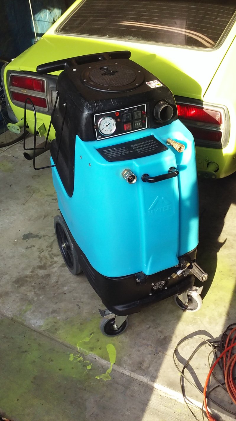

I'll only use this when I cant get there with my tm. Picked her up today for $500. Mytee 1003hx.
When I first puchased the old 1003 I had to run descaler to get it operating. Unit had been sitting for many years. Do you think its time for that again?
This time I lost pressure while cleaning. I used Flowade last time.
27,876
Rather than running descaler periodically, I run double strength vinegar through mine, usually once a week. Not only does it help to descale, it gets rid of any detergent residue. Check your regulator to make sure there's no trash in there and any o rings are in good shape, grease it up. Make sure any filters are clean. You may have an inline filter between the sol tank and pump. Make sure you are bleeding any air out of the system before you start cleaning. Use an open ended hose back to your sol tank. If you get good flow but no pressure when hooked up to a wand, it's either clogged or broken, you'll have to figure it out. Test the wand on another unit to make sure it works. Look at your quick connects and check valves.
