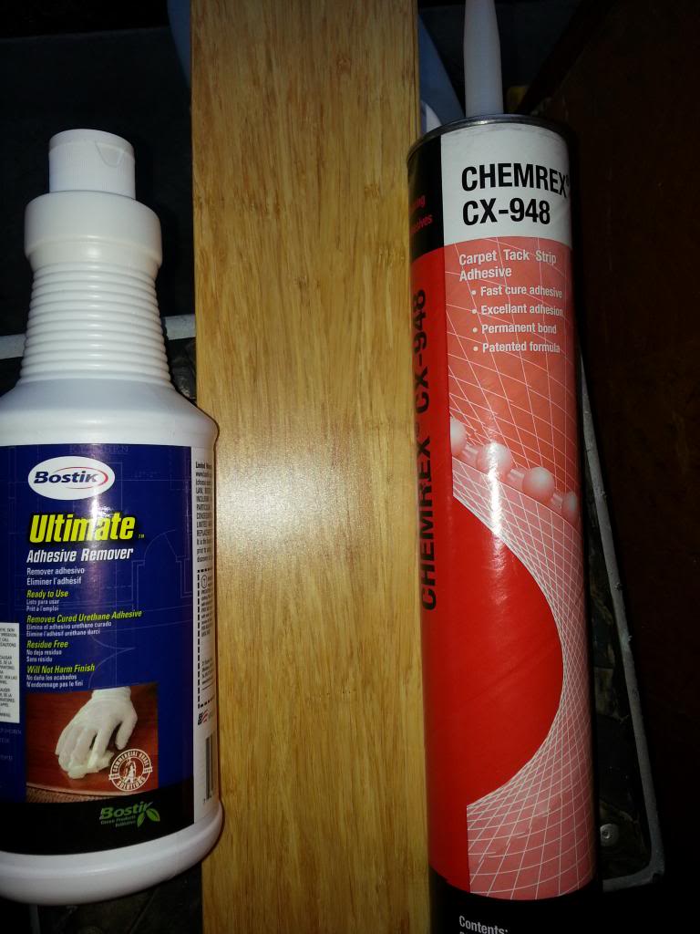

The installer (my best retailer) got glue all over a freshly laid staircase and in just enough other spots that the home owner wants all 3100 (now furnished
) feet rid of the glue and haze she THINKS she see from the installers failed cleaning attempt.
they used WD40 first wiht no luck than the solvent in the photo (Bostik's Best Adhesive Remover) to get some off but when the cleaned the solvent off (all by hand) whit Bona neutral cleaner followed by Basic IFT (Intensive Floor Treatment Aggressive Wood Floor Cleaner followed by Basic Squeaky rinse. All of which left a slight hazy less than new look.

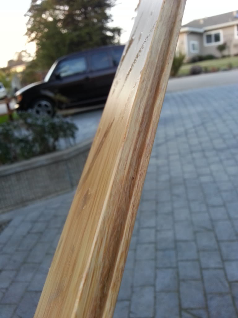

I'm testing a spare slat right now to see just how long I can leave the Bostik Solvent on with out messing up the finish. Tomorrow Ill test some glue I applied today.
Any ideas or suggestions?
) feet rid of the glue and haze she THINKS she see from the installers failed cleaning attempt.they used WD40 first wiht no luck than the solvent in the photo (Bostik's Best Adhesive Remover) to get some off but when the cleaned the solvent off (all by hand) whit Bona neutral cleaner followed by Basic IFT (Intensive Floor Treatment Aggressive Wood Floor Cleaner followed by Basic Squeaky rinse. All of which left a slight hazy less than new look.
