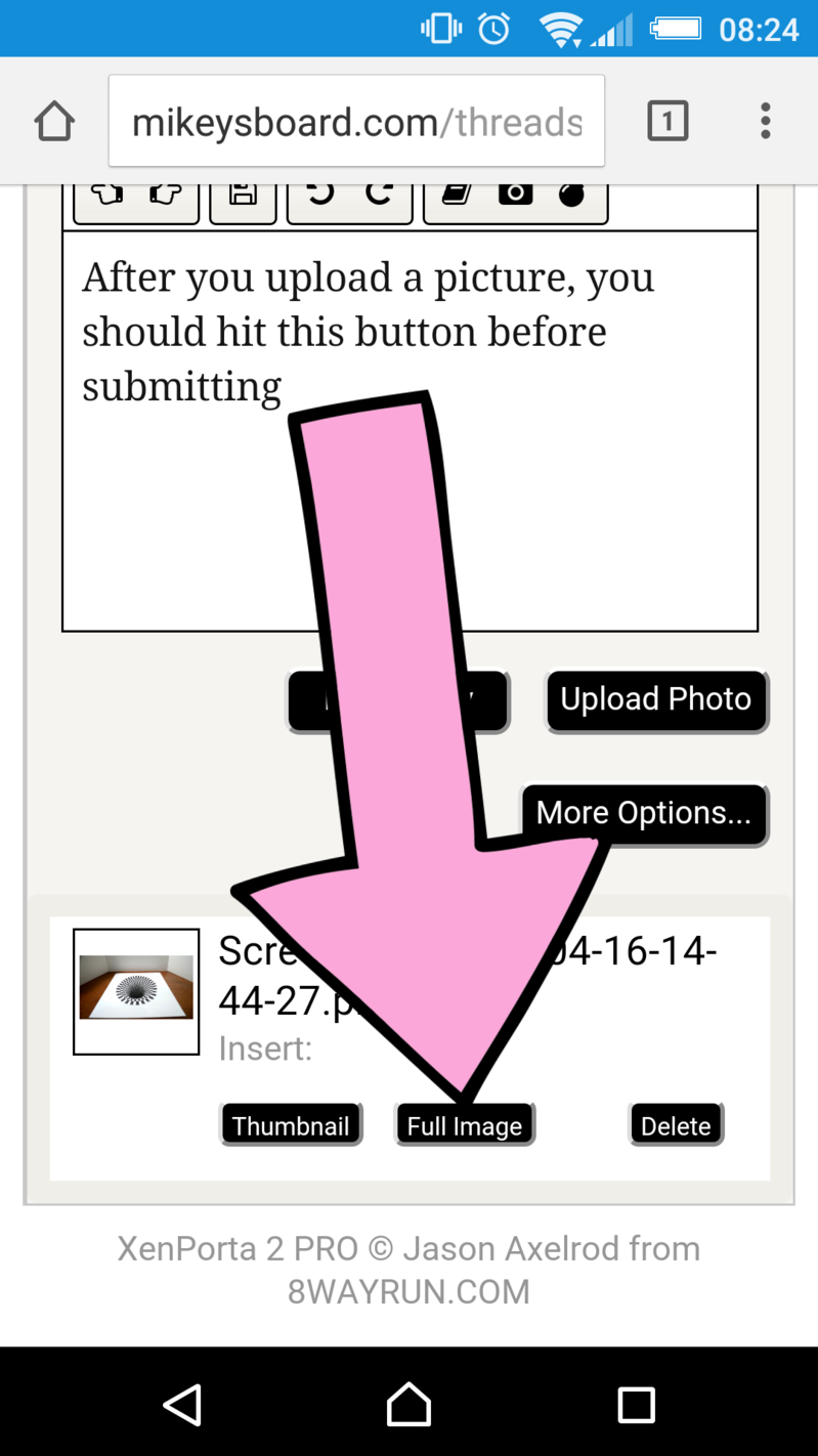

After you upload a picture, you should hit this button before submitting:
14,624
That wasn't my problem. It was how it recorded it. I laid the phone on it's side to make it record full screen, instead of laying it upright, but it still recorded like it was on upright position
Zee
Nov 2, 2007
6,193
I meant for you to show your pictures... I didn't even look at the video.
