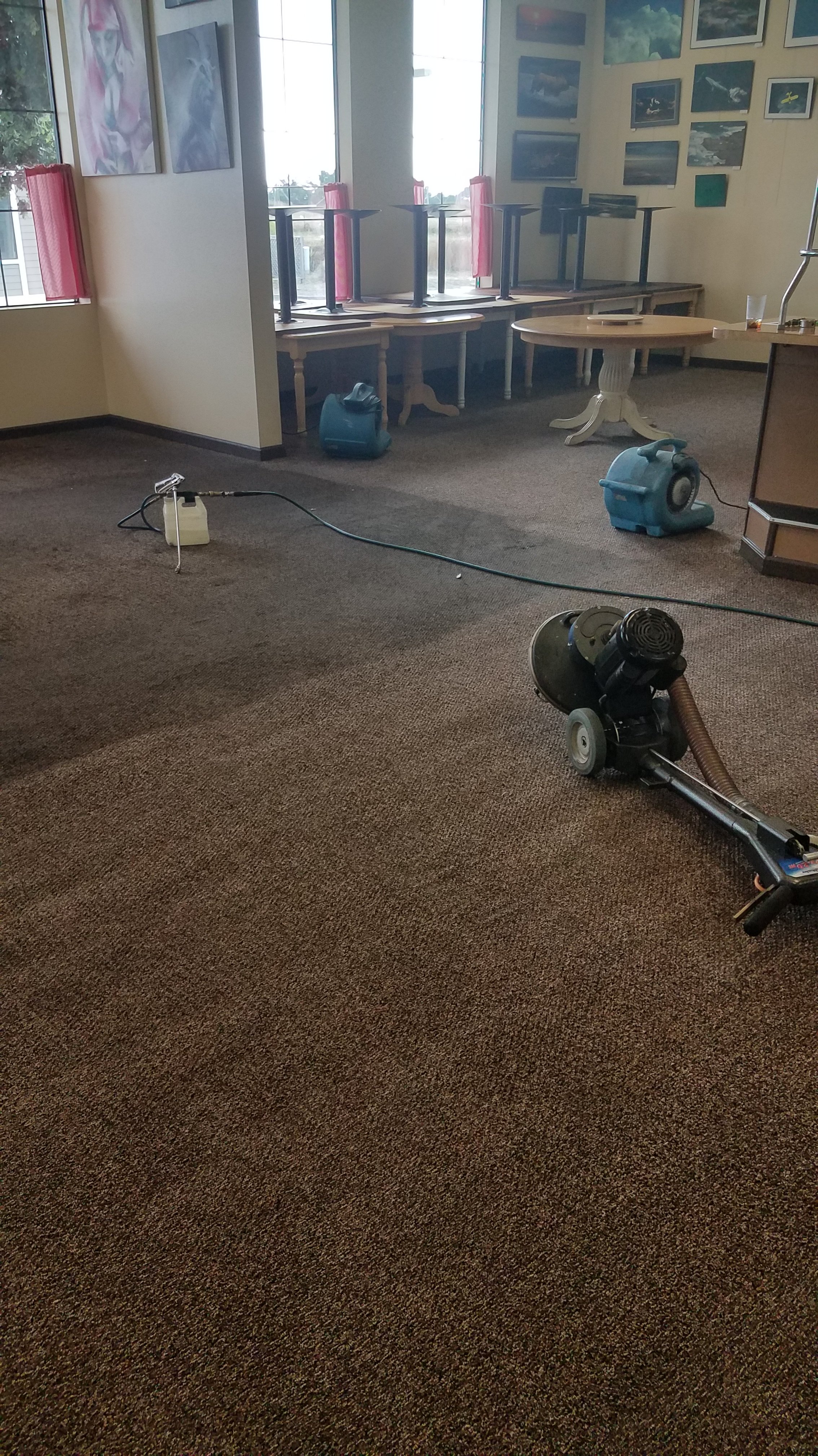

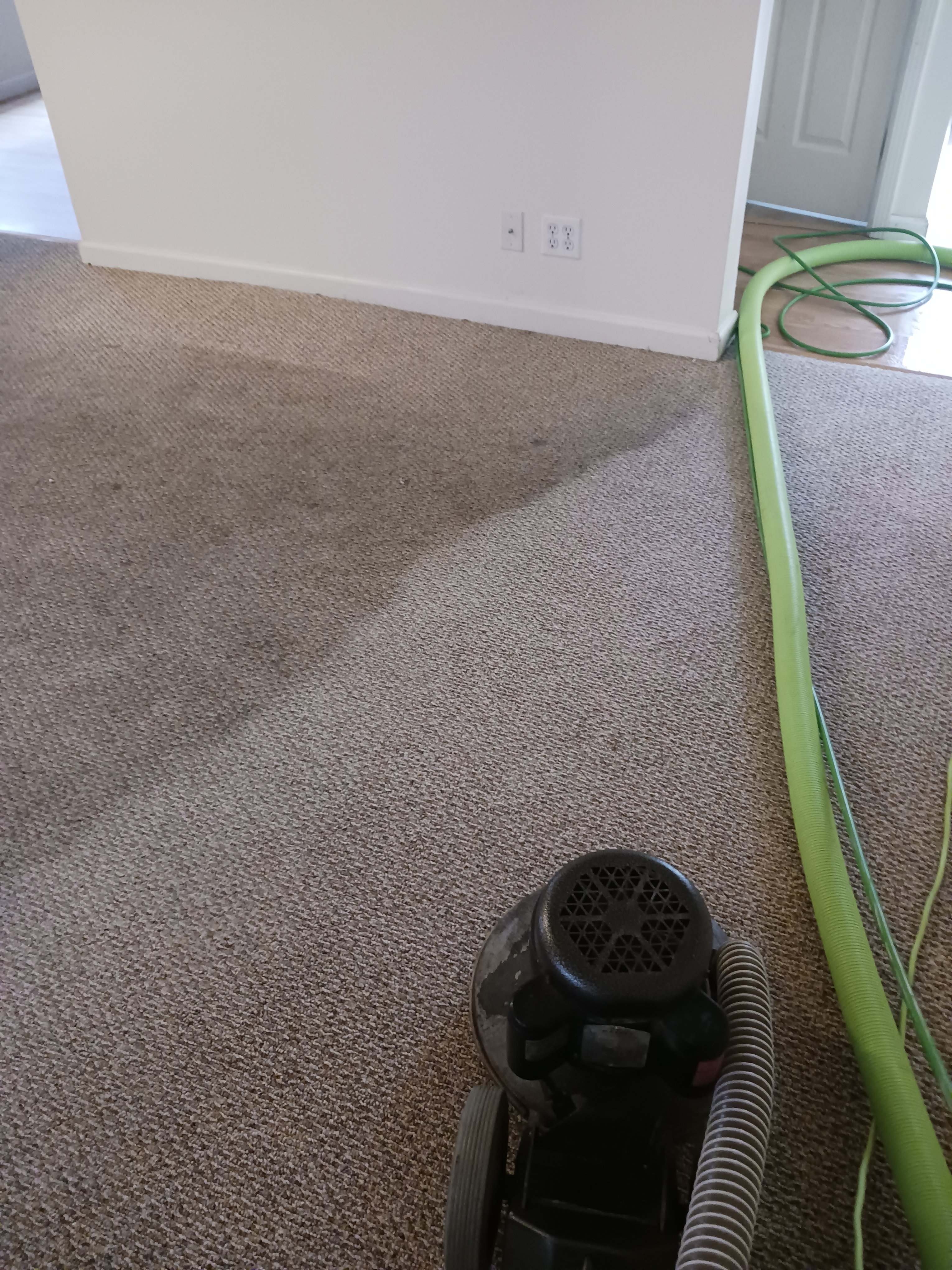

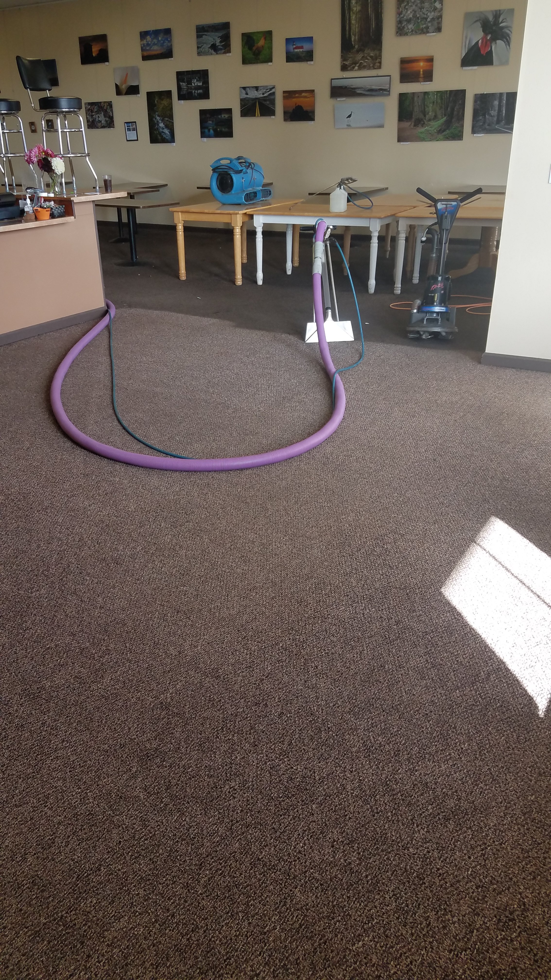

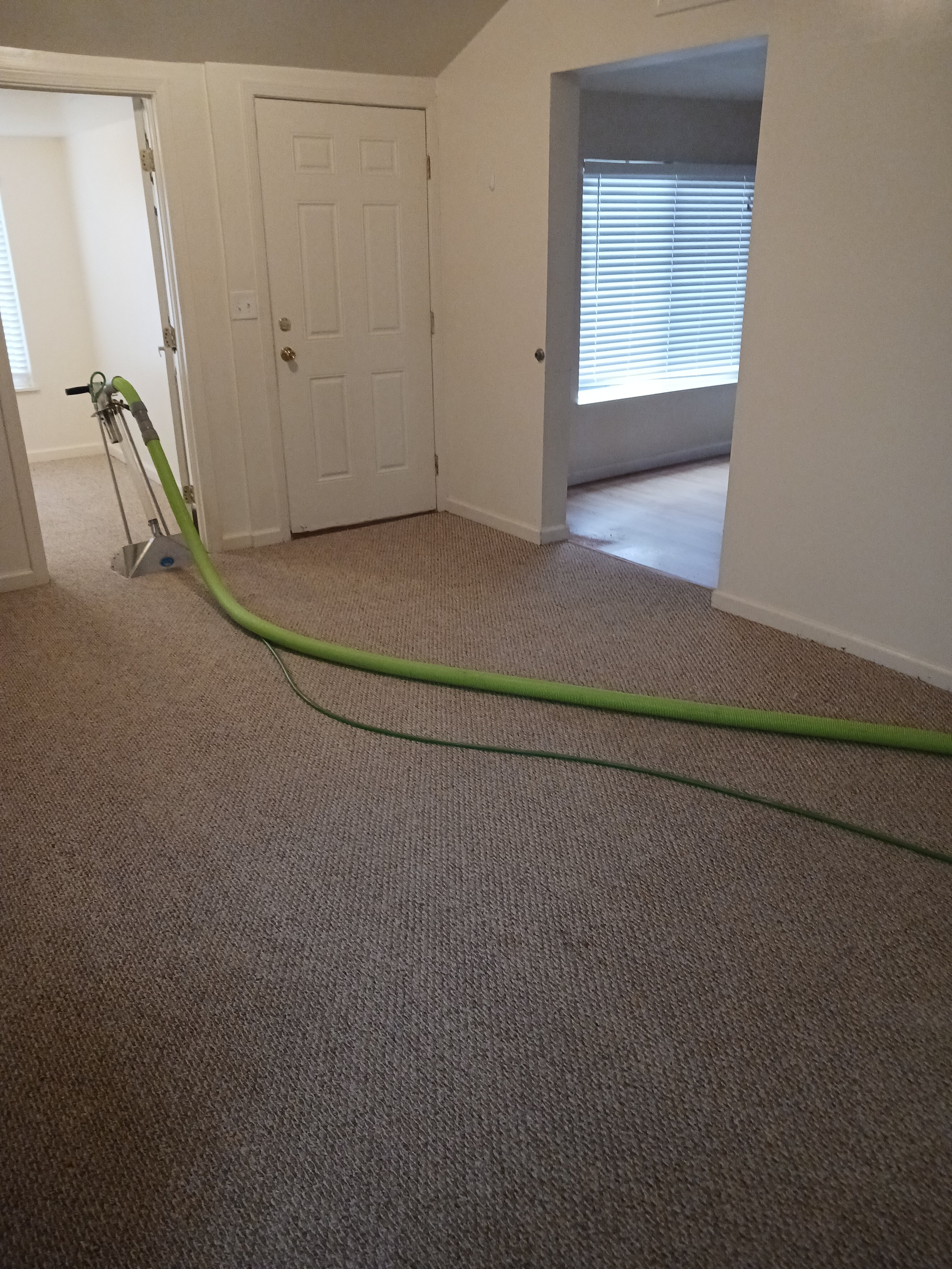

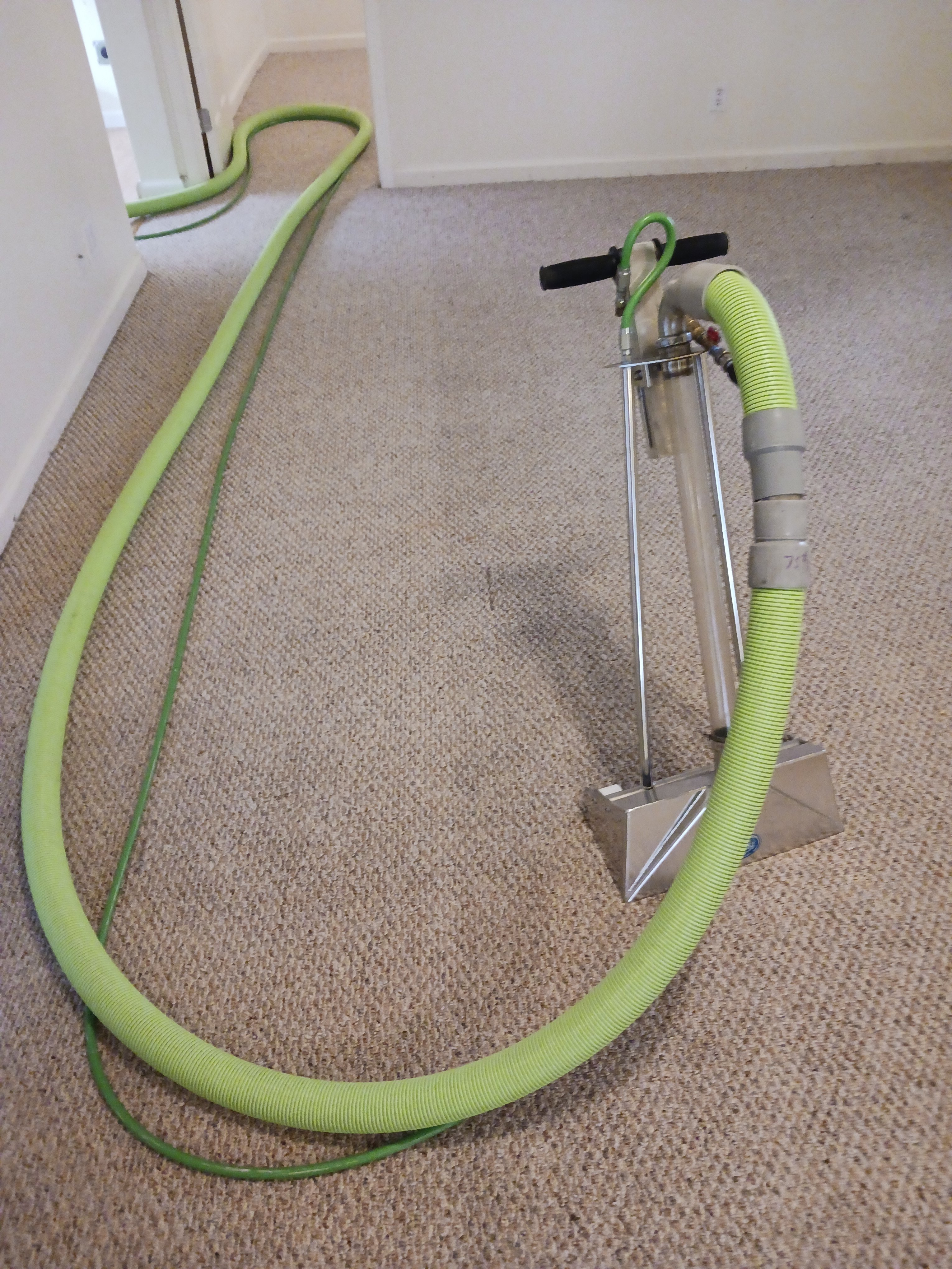

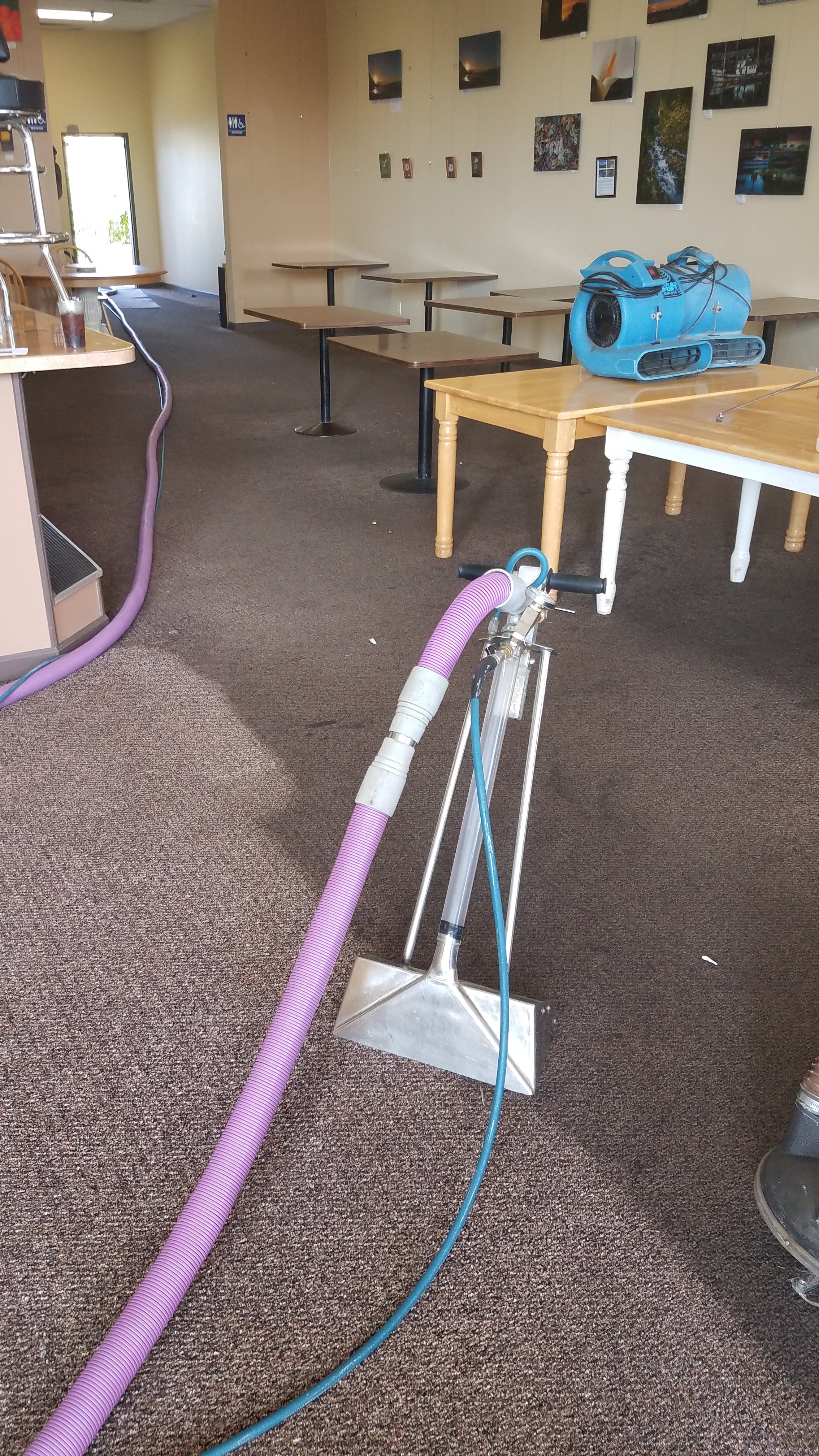

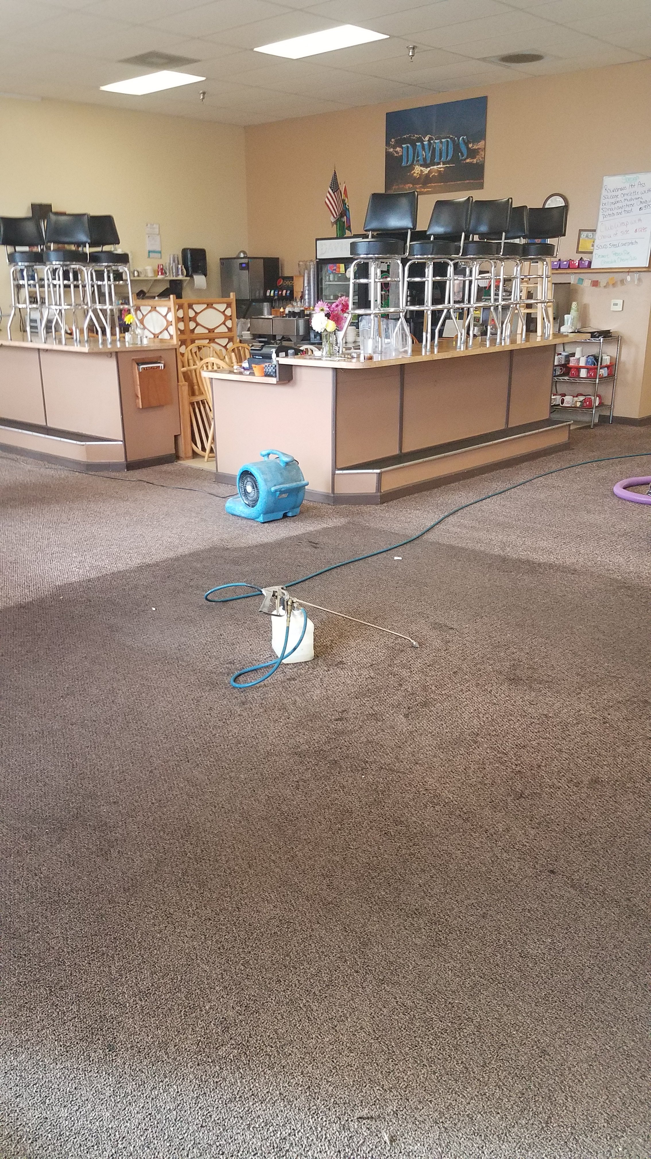

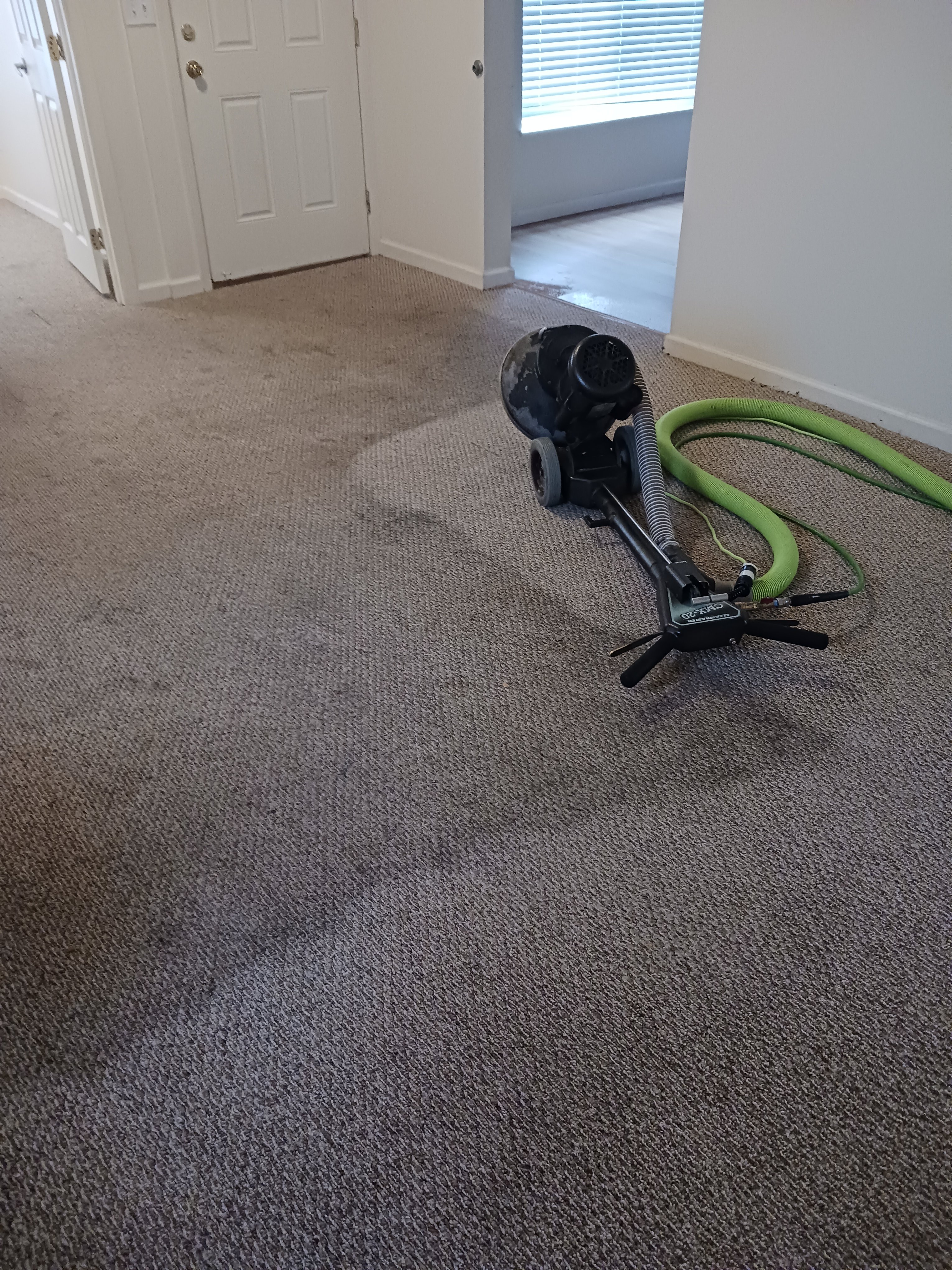

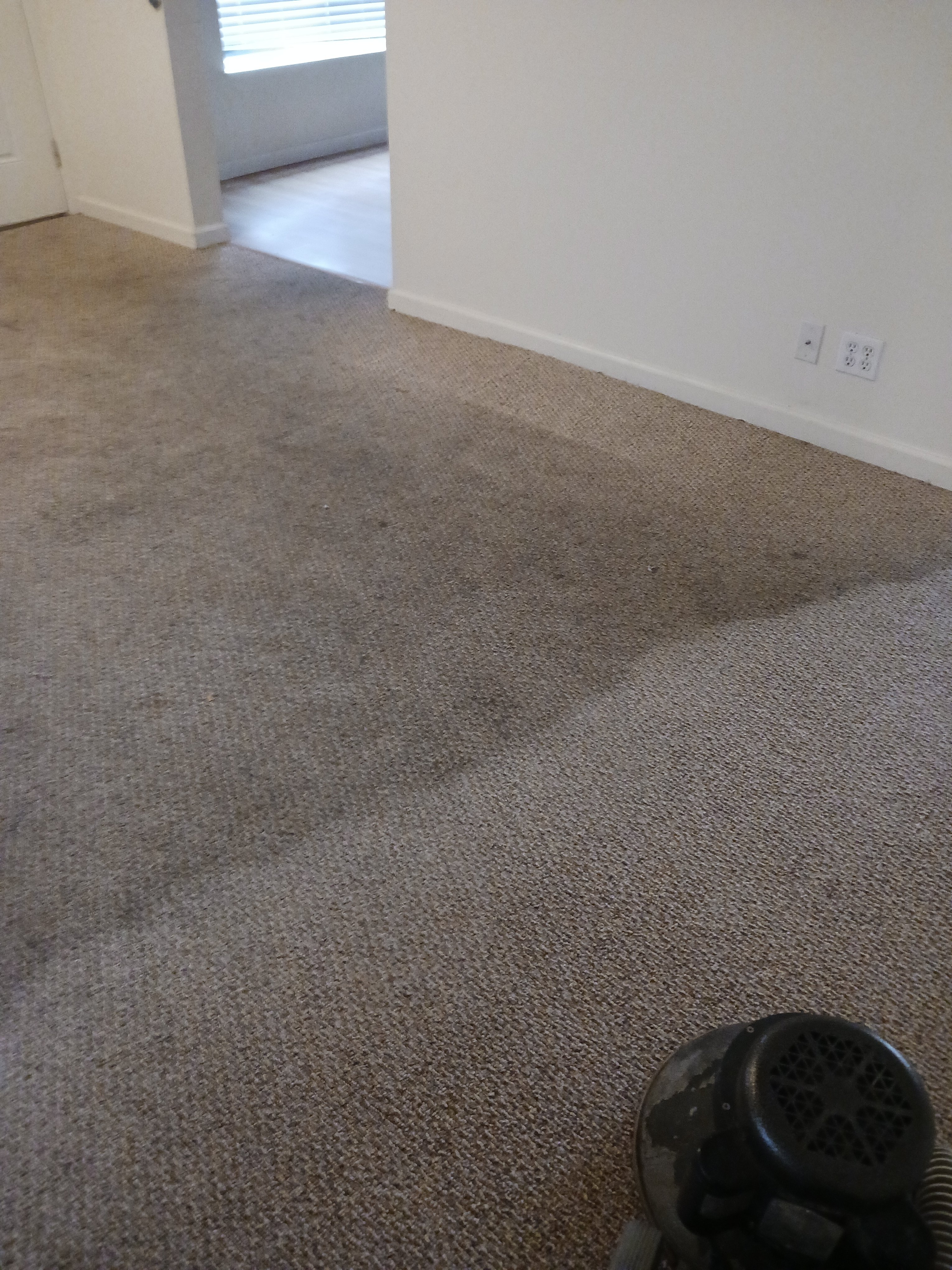

I prefer the rx20 and old school drag wand. I do every carpet twice. All carpets done by me are presprayed, scrub pass and dry pass using an emulsifier and rx20 then a rinse/dry pass using a rinse agent and old school drag wand, the rotary gets the carpet clean and the drag wand gets um dry and residue free

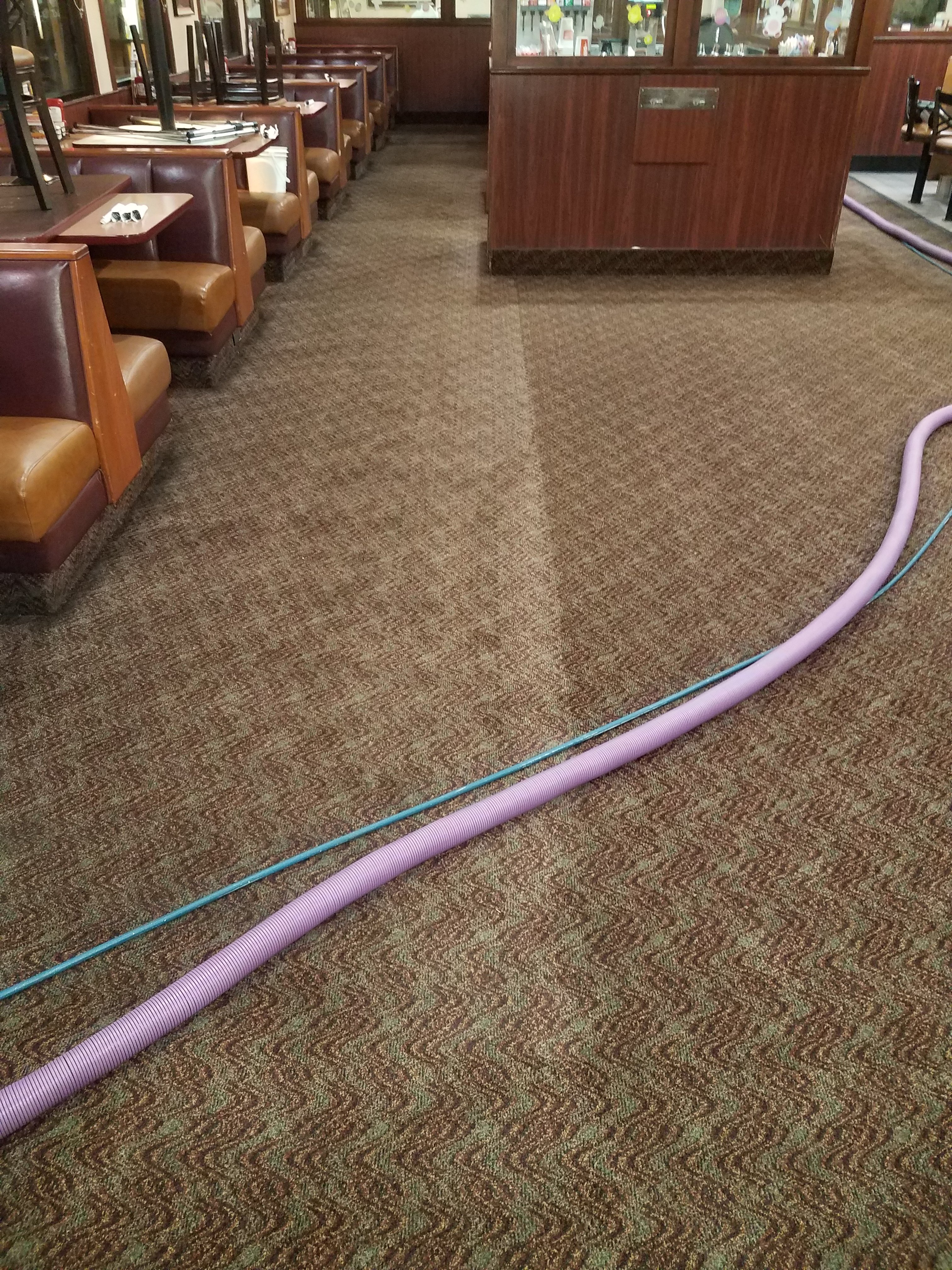

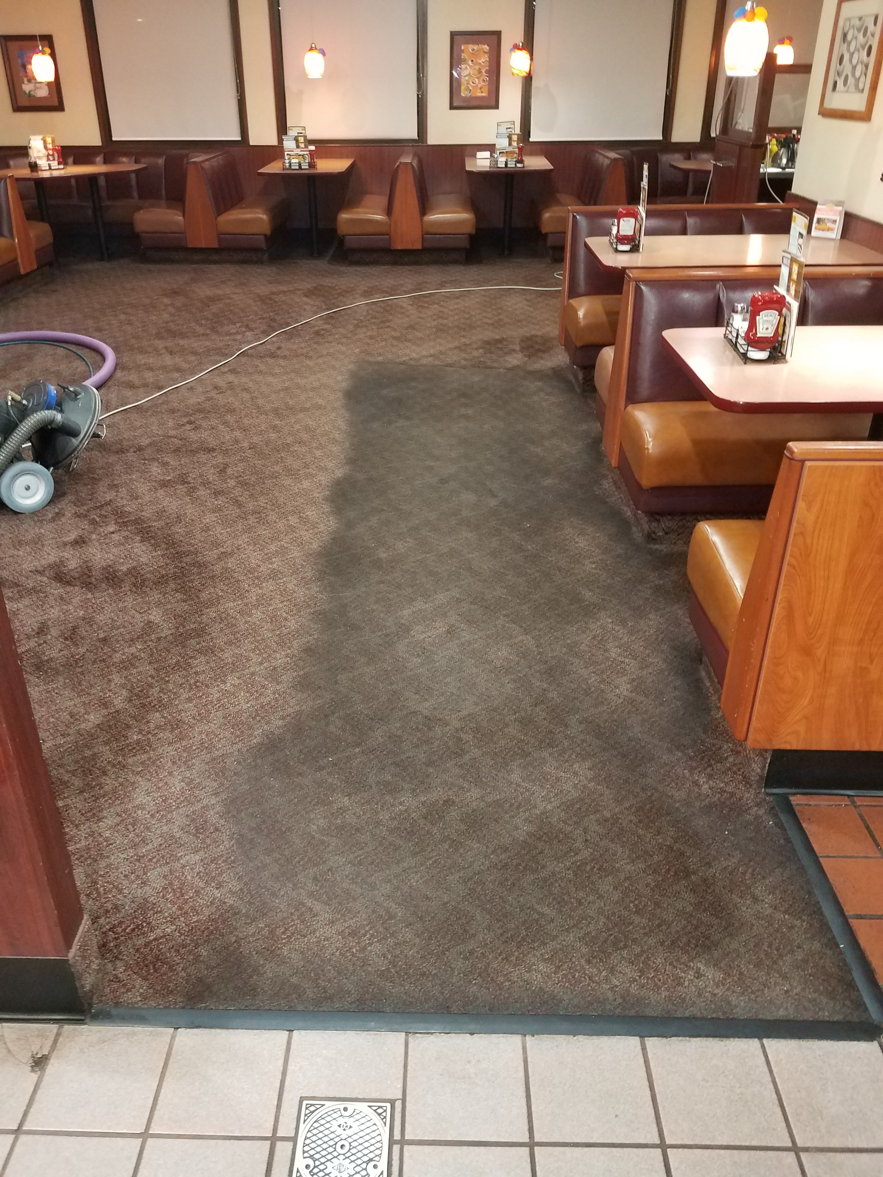

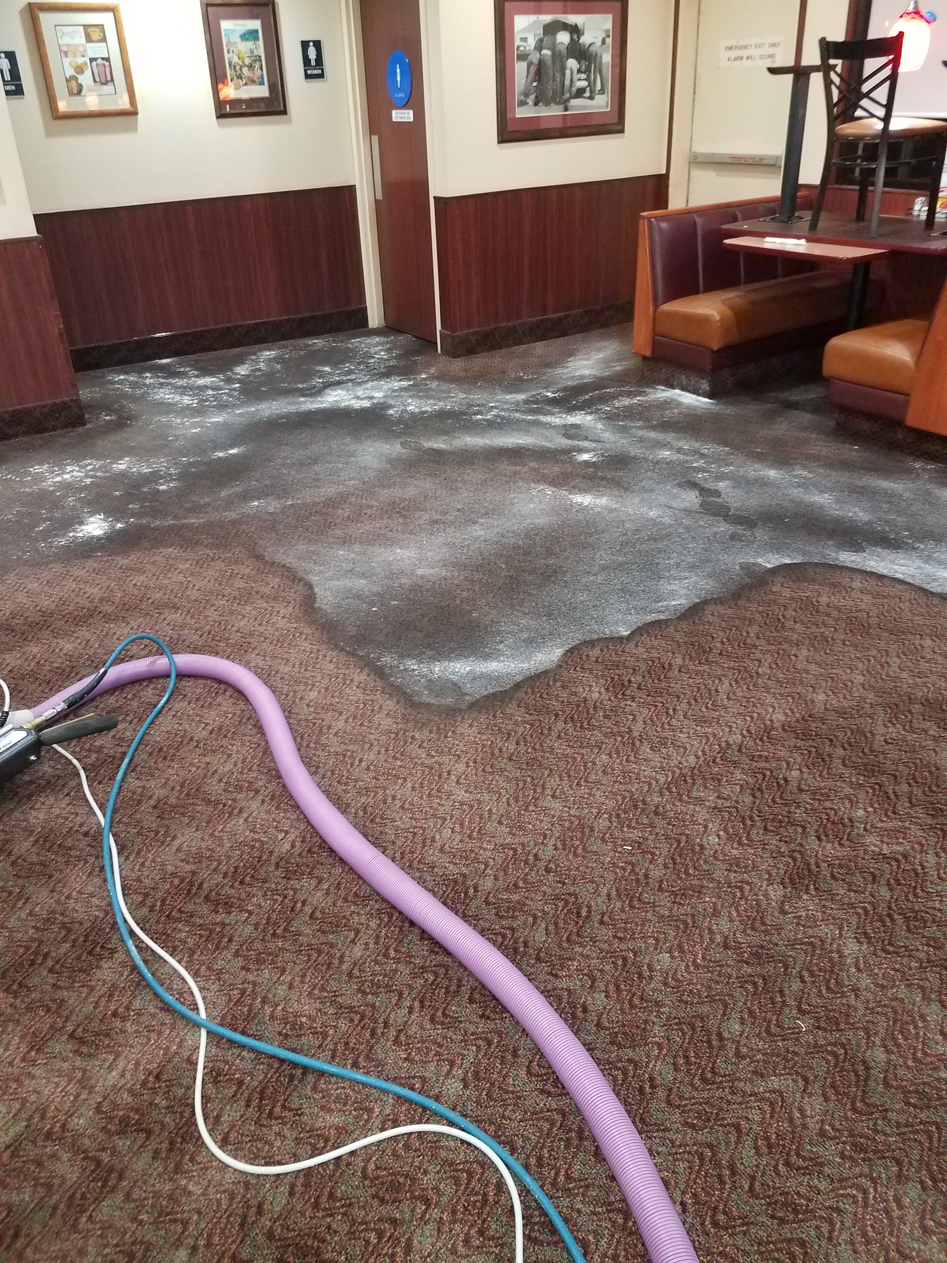

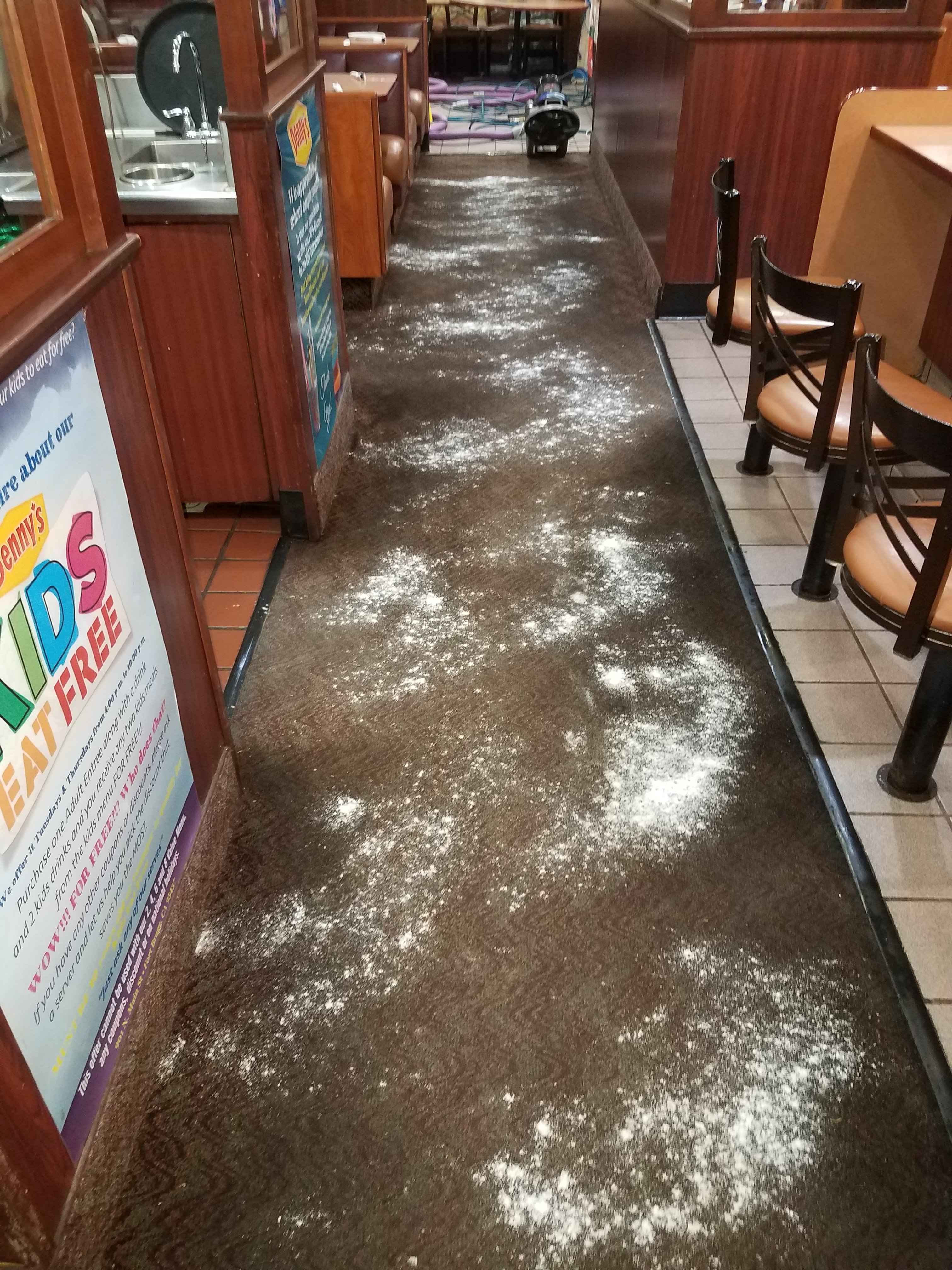

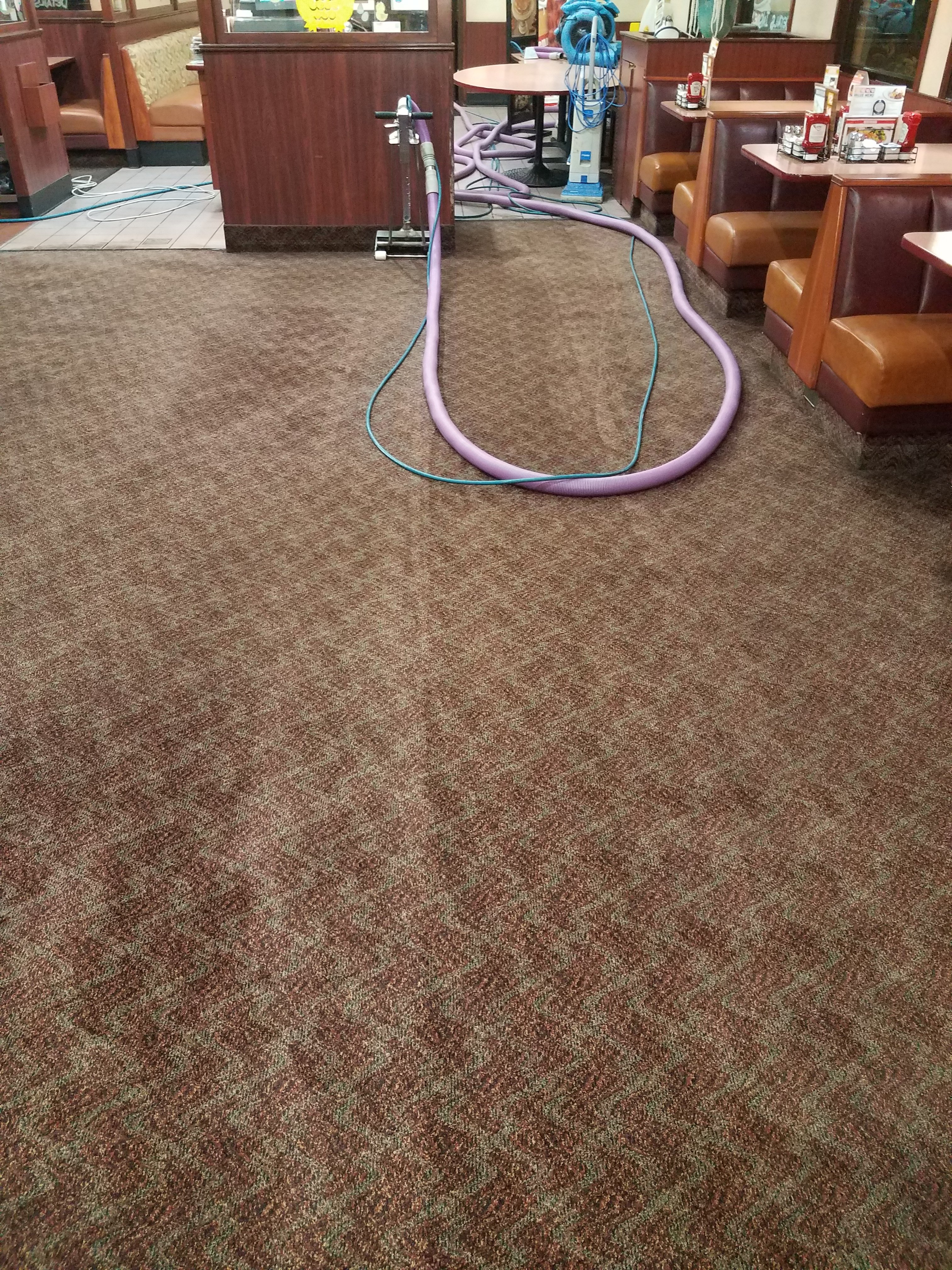

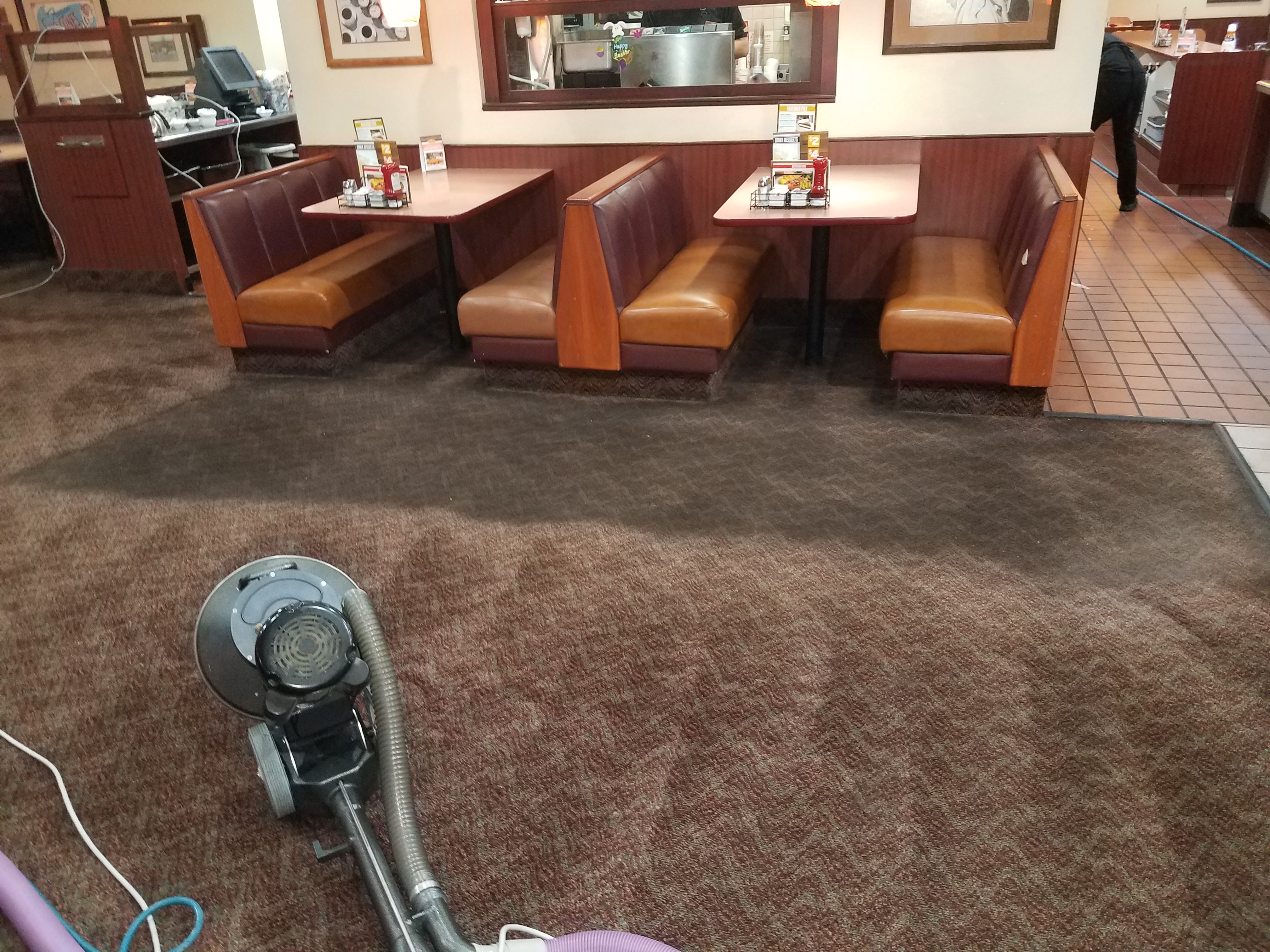

Heres a couple of restaurants 1 was done by someone who left a crap load of soap in it had to use a truck load of defoamer but it was clean and residue free when I left

What the heck are you using that you need to use so much defoamer? This isn't 1985, there are new/better chems out there.
And Nice job.

I used more defoamer on that one Dennys carpet than i used on all the carpets ive done in over a decade combined! , im sure there is better stuff out there but not available at 1 in the morning in fort bragg

It wasn't what i used it was what the last guy used that was the problem , i just showed up and surprise !!! 😶‍🌫️😶‍🌫️😶‍🌫️🤯🤯😵‍💫😵‍💫🥶

I would think if you tried a zipper, you would ditch that drag wand so fast it’d make your head spin. It’s just 21st century compared. Smoother, easier, easier to carry. I’m a zipper fan, but I’m mostly commercial. The Zipper is the reason I don’t buy a Dev.

That's a lot of work but as long as you're getting paid for it, good job.
