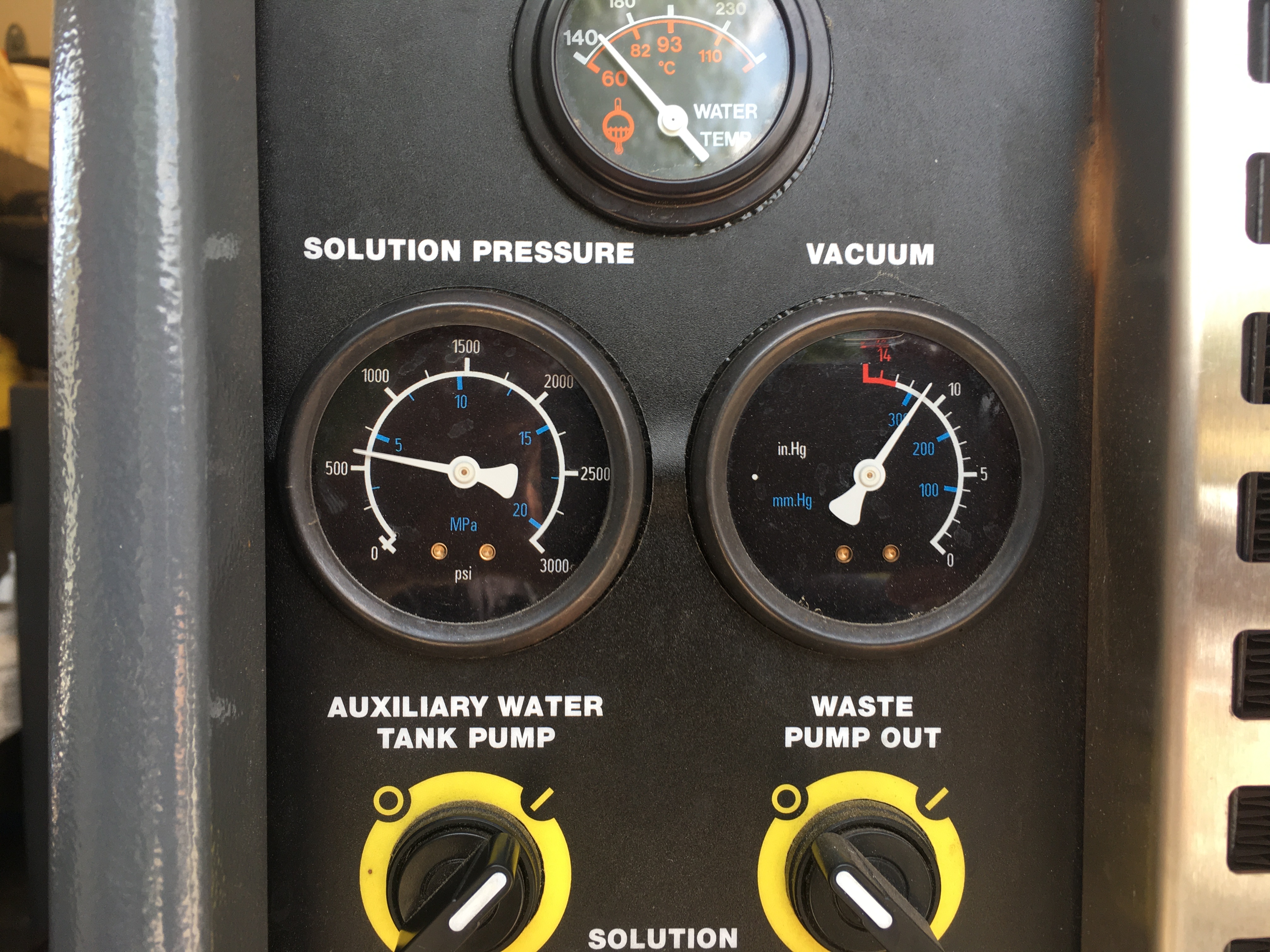

I’ll post tomorrow with a reading

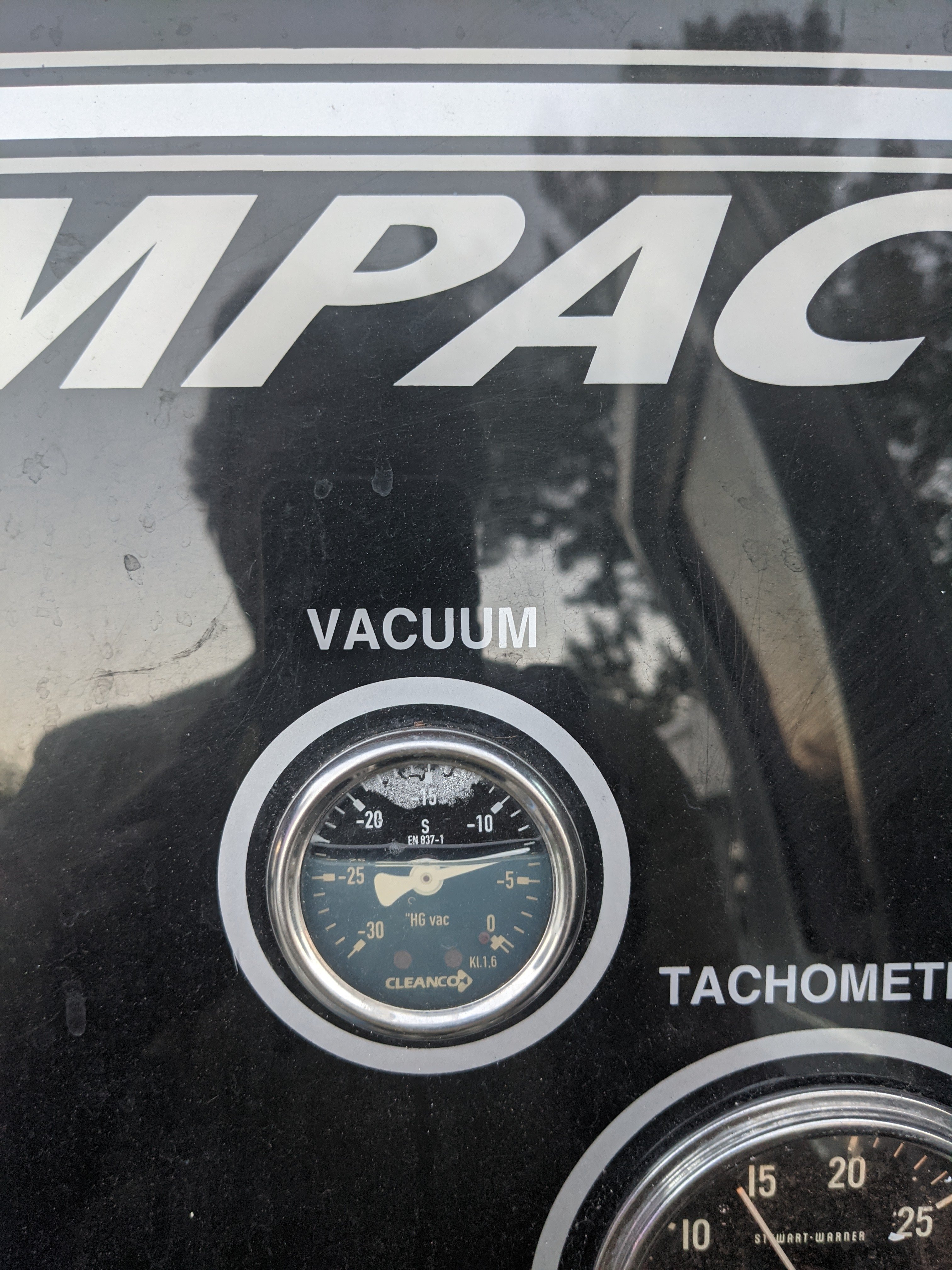

Here's my Cleanco. 47 blower, 75 feet of vac hose hooked up to a 1.5 inch wand. Aprox 7 inches with the wand open.

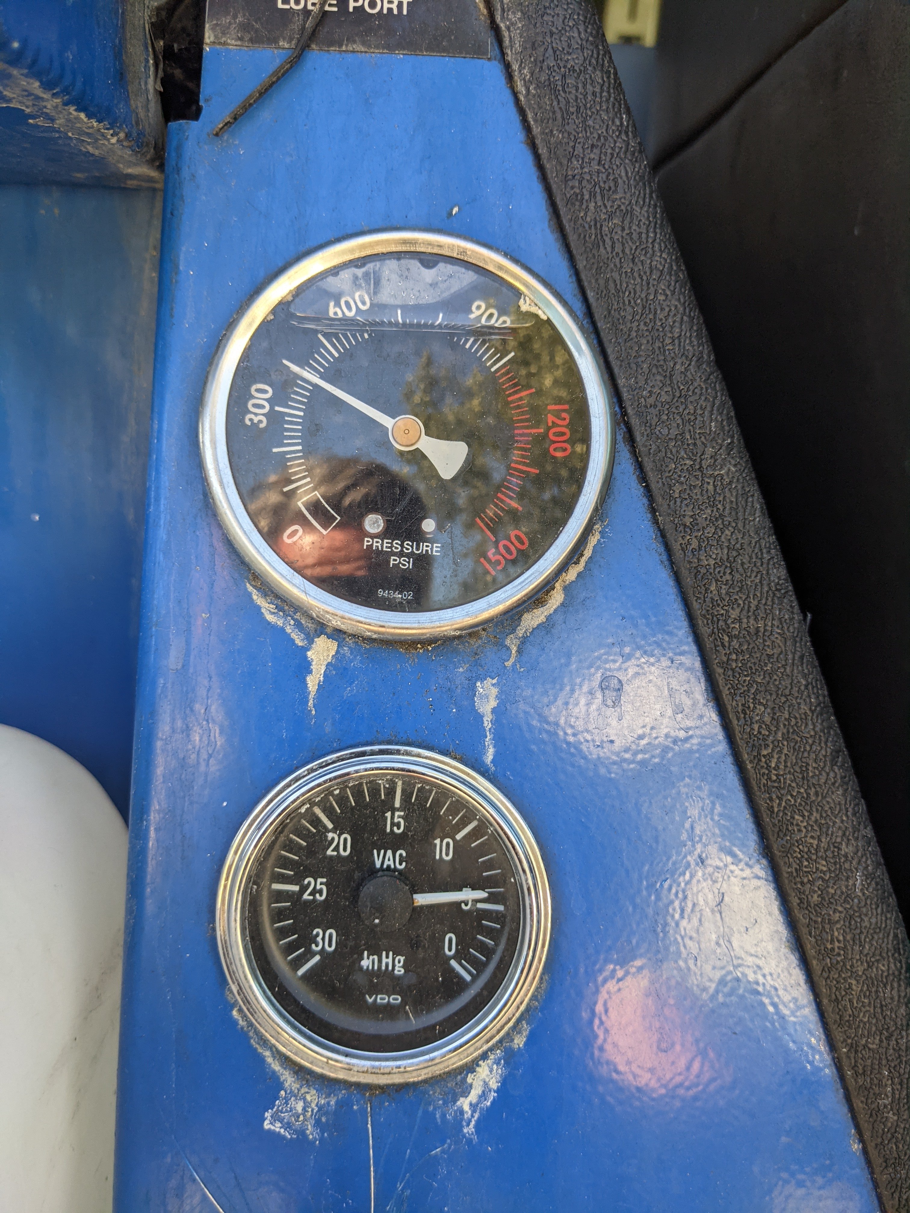

100ft of hose without the wand attached.
