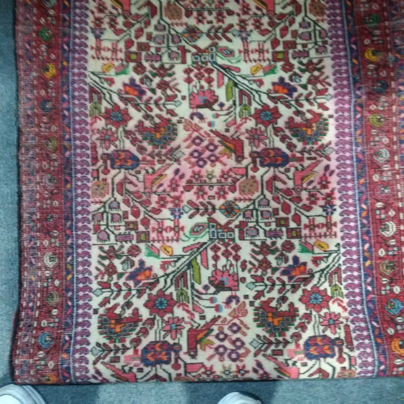

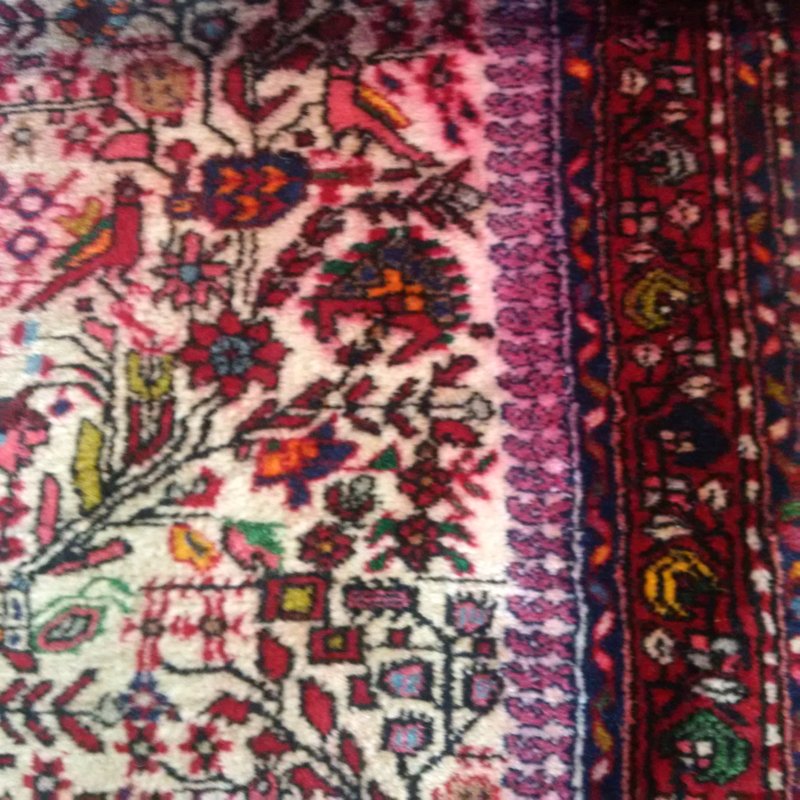

Here is an example of a runner that came into the shop recently. I don't know what happened to it, could be water damage or improper cleaning. The customer knows the rug is damaged and doesn't expect to have it corrected, just cleaned. If I could correct for a reasonable price, I am sure the customer would say go ahead. How would correct this type of dye bleed?

Your specimen is fixable.
If you could roll back the clock and had the chance to wash this rug before it looked this way, would process should be used to manage a safe and effective wash? Part of the answer to consider is what is it made of and what happened to it to get these unsatisfactory current results?
Let's keep this thread going with examples of what is being said and what remedies in a bottle are directed by industry leaders and instructors.

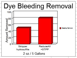

I am proposing a shift from old school Sodium Hydrosulfite to our ReduceAll powder.
Besides being more effective, it doesn't yellow the wool, which saves an extra step.

We sell both the Sodium Hydrosulfite stripper (like Streepene, etc)
and
the new ReduceAll.
The ReduceAll also has high potential to remove urine staining
from damaged rugs in the wash cycle or tub.

On another matter, if the rug has existing dye migration, as pictured earlier in the thread, then washing in the Tub may have little effect in removing unwanted dye in places in already migrated into. To remedy that, we would use a stripper. Our 'go to' product is often Sodium Hydrosulfite. If it is blue indigo dye, we may have to go to a chlorinated product and then neutralize it in a flush rinse.
