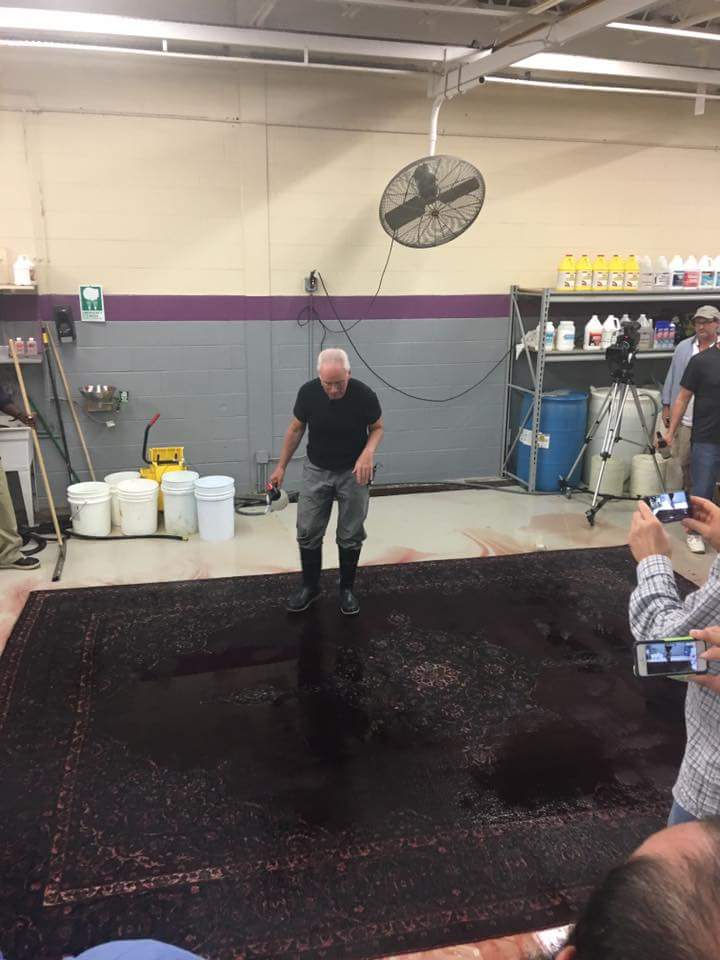

I think a fair comparison of Reduceall and Hydro would be using them the same way plants all around the world use Hydro....in a bucket of hot water poured over the rug, on the wash floor, prior to spinning or extraction.
After watching the video it seems like a ton of product is needed to create the reaction and what your 5 minute video showed could be accomplished on the wash floor in about half the time (depending on how stubborn the dye was being).

Robert is the true craftsman . . .
I do some color rinsing out of that rug.
