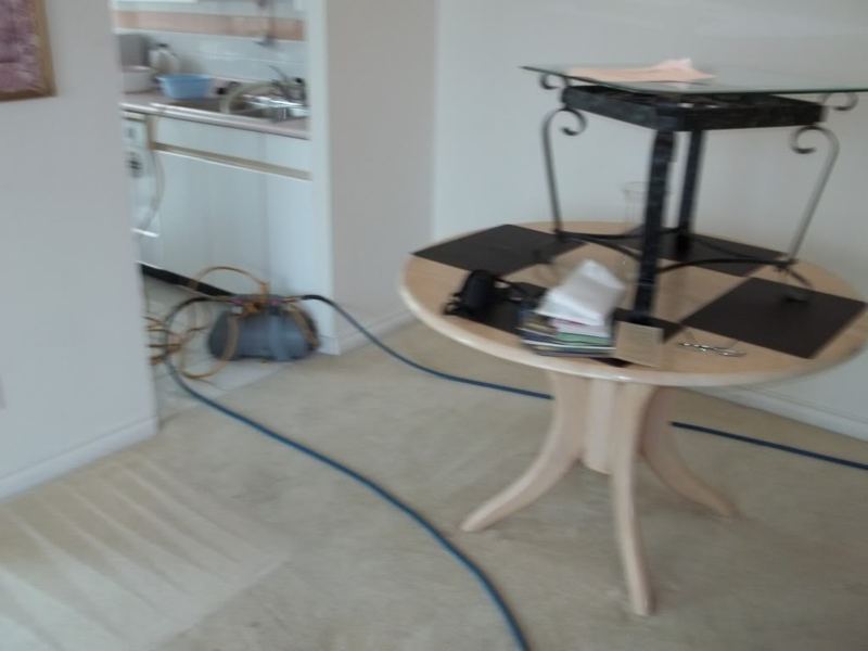

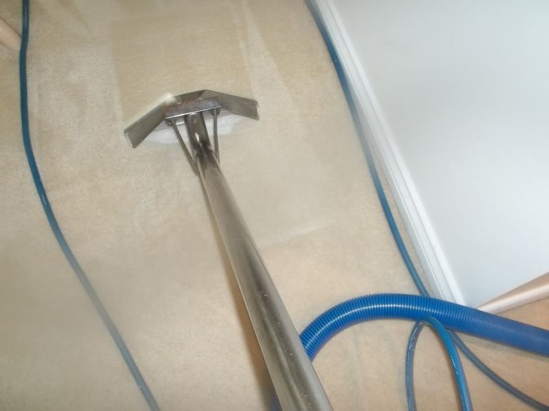

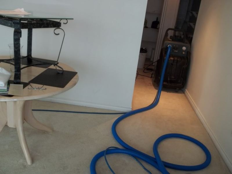

Post B above - 500 PSI machine,pump and vac plugged into washing machine outlet, second cord placed in bathroom. Both circuits are 15 amp service. Second picture, 3250 watt in line heater, reconfigured to 240 degree final thermostats. Both plugs routed to kitchen 15 amp service on stove, 20 amp service on kitchen counter.Third picture, see steam rising from wand. It's fookin' hot.
Really never have any problems at all birdogging out the electrical or the insane notion you'll be tripping over cords and hoses. It's all in the setup- some places the machine lives in the kitchen, sometimes in the outer hallway, it just depends.
