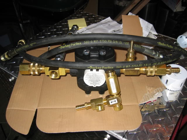

amp draw only 9.6 per leg with all components running get equal power
nothing but the best hose and connects all custom
pump will do 500 psi at 2.2 gallons a minute
no pump teck porti pump
B
Bjorn
cfms 230+ lift 11 hg
with booster 330+ cfms
total amp draw is only 9.6 per leg
500 psi @ 2.2 gallons per minute

Is the vac amp draw the same for both motors and your sharing the pump amp to both legs, or is one vac smaller and the pump is run on that leg? Are they 2 or 3 stage motors? What is the approximate weight of the unit?

"So you have to run two power cords, then a 3rd if you want a booster to make it at least feel like a POS number 3 blowered Prochem Blazer. Then to top it off you need to burn a little Giant heater.?????"
Please tell me the advantage. There is a reason things like that do not sell well. I guess bleu line is knocking them dead ?
I have used this machine for over two years with only 15 minutes of down time. Maybe if bleu line could make something this reliable you would still have a job?
most hose runs that anyone cleans are around 100 to 150 feet booster is not needed but comes in handy I have run 300 feet with booster. I use the booster two or thee times a month ( big deal )
Takes no more time to set up than any-other truck mount
here is the big deal is the amp draw of my unit so you don't have the problem of blowing breakers this amp load is full with pump running flat out and is high as it gets.
Is this a SUPER SUCKER with one million cfms no it cleans carpet efficiently and cost effectively with savings in fuel over other gas only powered truck mounts.
