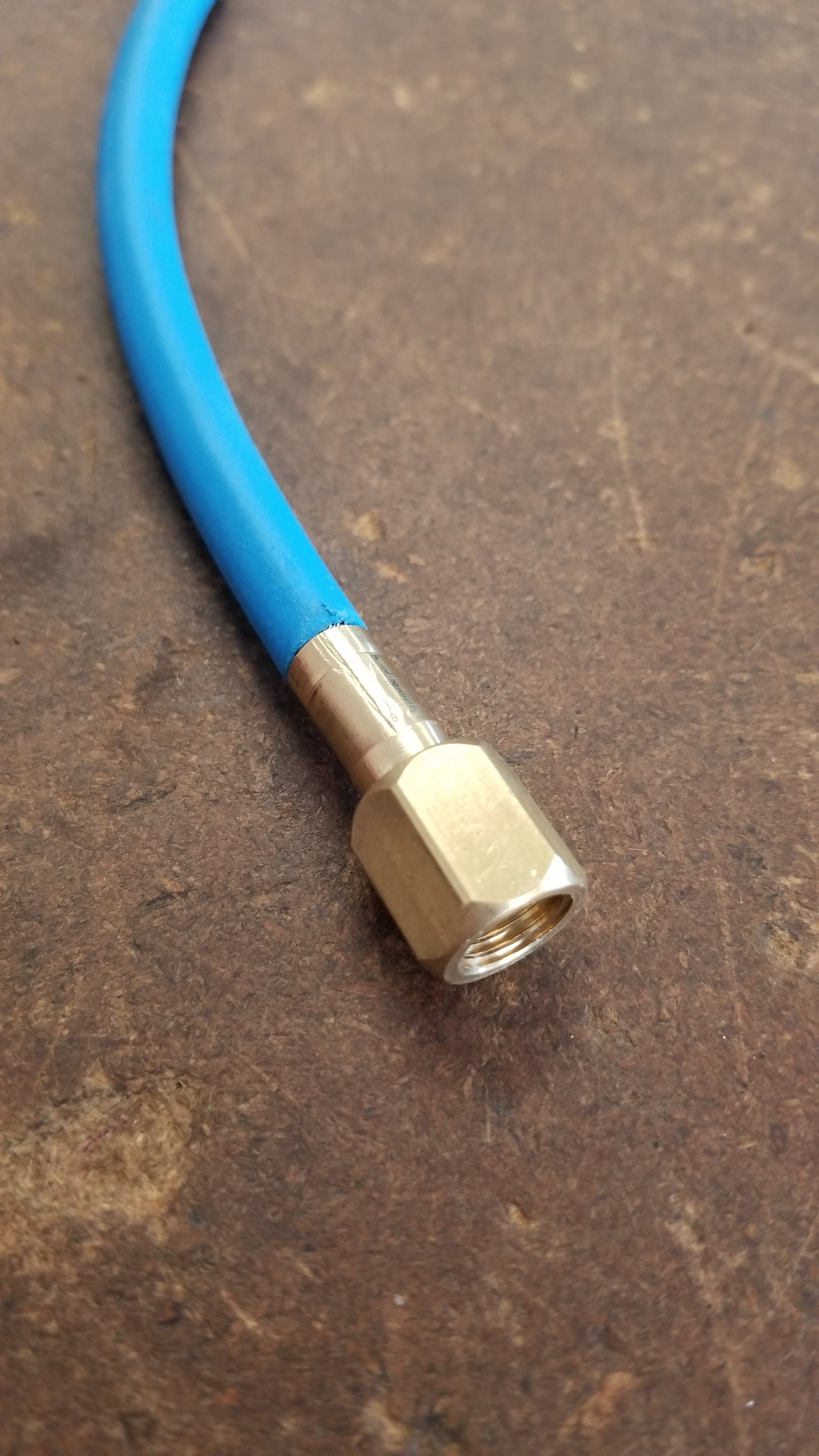

If you have a filter behind the quick connect than what is your manifold supply hose made out
