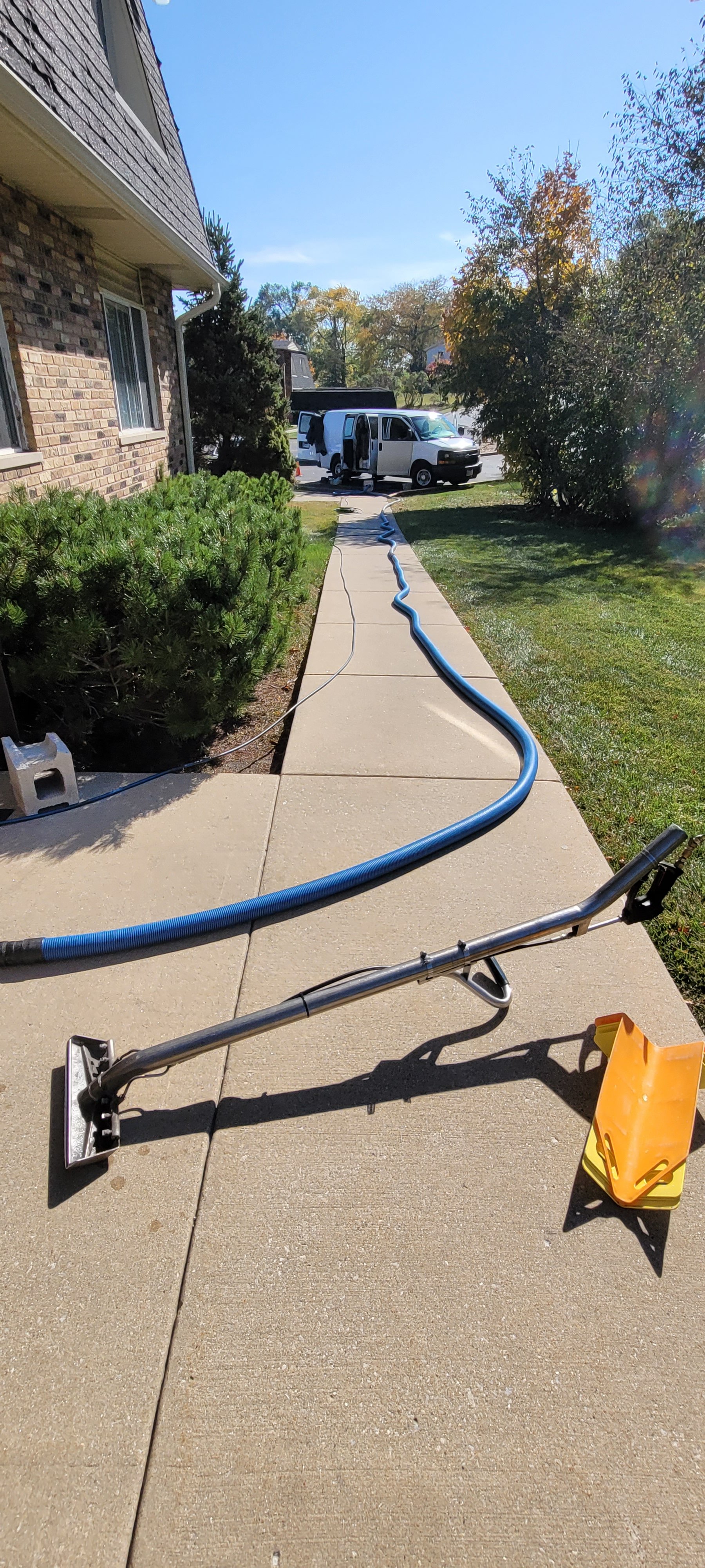

If Ti Prochem was 2 lbs lighter, it would be an ideal wand for me. When six jets don't leak, have an optimal spray pattern and flow, and the head is perfectly aligned with a surface, it's carpet cleaner heaven. Ergo handle and the gun trigger are essential for me. The weight is 9.6 lbs, not so much

The side handle on Prochem Ti, in my opinion, offers the operator the most allowable comfortable swing. One thing is to have our body aligned with a wand, but the wrist on the side handle means freedom of movement compared to positioning your hand in front of the body when the handle is on the tube of the wand. Maybe is the matter of habit, but I like to use my ' big boy'. I have wands with two different lengths; 62 inches and 65 inches. Both feel right.
