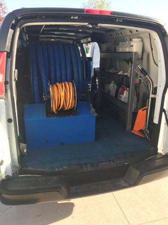

I installed marine carpet in all my vans. Just install underlayment in the areas you want to carpet (screw to floor) then glue carpet. easypeezy

1/4 in plywood will flex to follow the curves of the van. If you attach a 1x4 to the deepest point of the curve it will provide more holding power for the screws and then apply the carpet with indoor / outdoor adhesive. For just installing carpet use 3m high heat spray adhesive spray van and carpet. DO NOT USE THE CHEAPER SPRAY ADHESIVE the interior of the van gets too hot and the glue will release (it is like a contact adhesive). Learned from experience I have to redo mine.
If you are trying to carpet around the ribs in the van you really need to know what you are doing with the carpet or you will have a lot of wrinkles.
