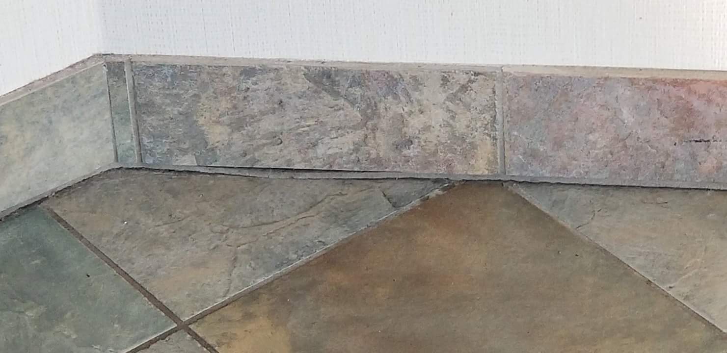

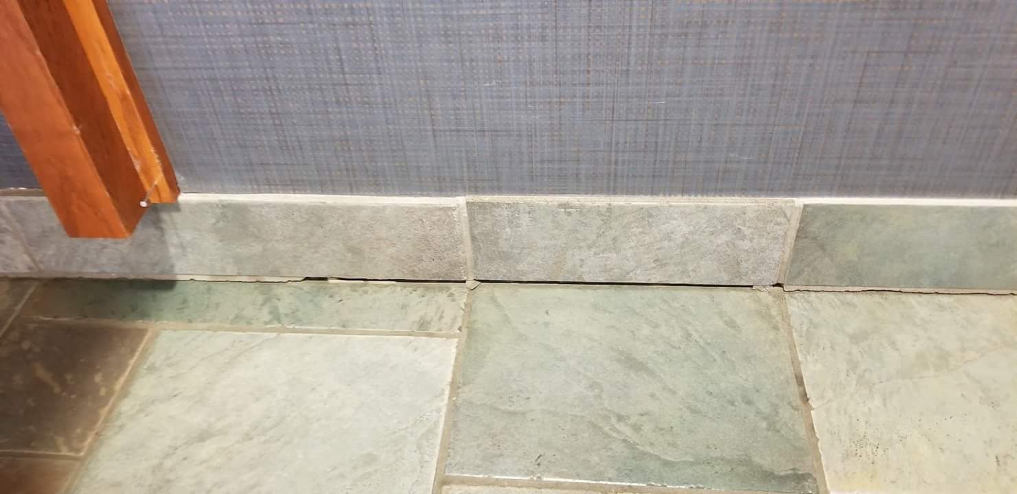

I've been stumped on how we are going to deal with the gaps between the tile floor and the tile baseboards at the Minneapolis RMH...

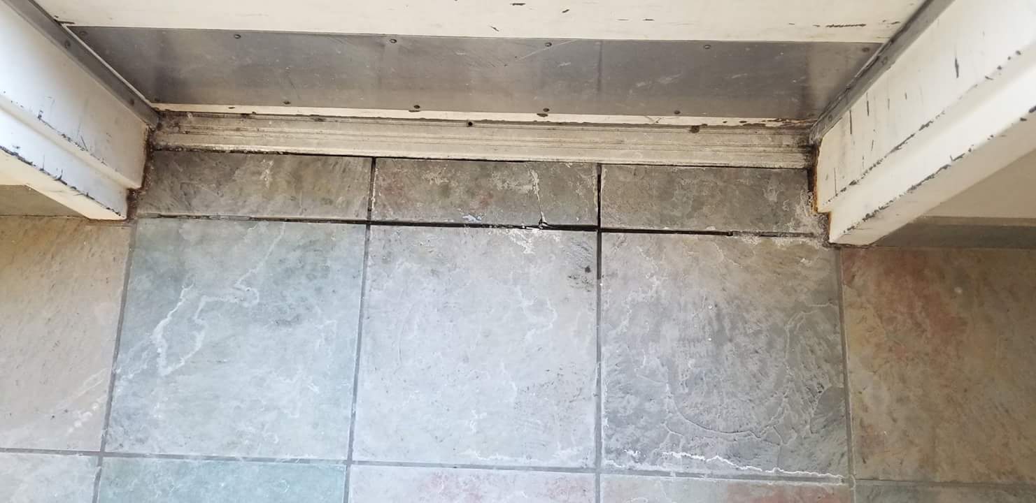

As you can see in these photos, the constant freeze/thaw cycle is causing the grout to pop out and where they have tried to re-grout, it just happens again. I believe Siliconized Latex Grout would not last long either due to it's lack of flexibility and plain silicone would look horrible.
Doing some repair on my 90 year old split log cabin recently had me using "Log Jam Chinking" which I'm thinking will be the best solution for this issue.
