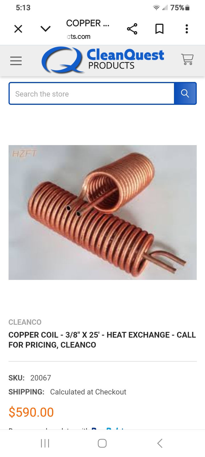

If theres Internal compression fittings they can do really strange things like leak one way and seal when pressure is applied to the other side. This is rare but not unheard of and is possible that higher pressure seals and lower pressure leaks. My heat exchangers have internal compression fittings to connect the coils to inside of the canisters lid and outside top fittings
