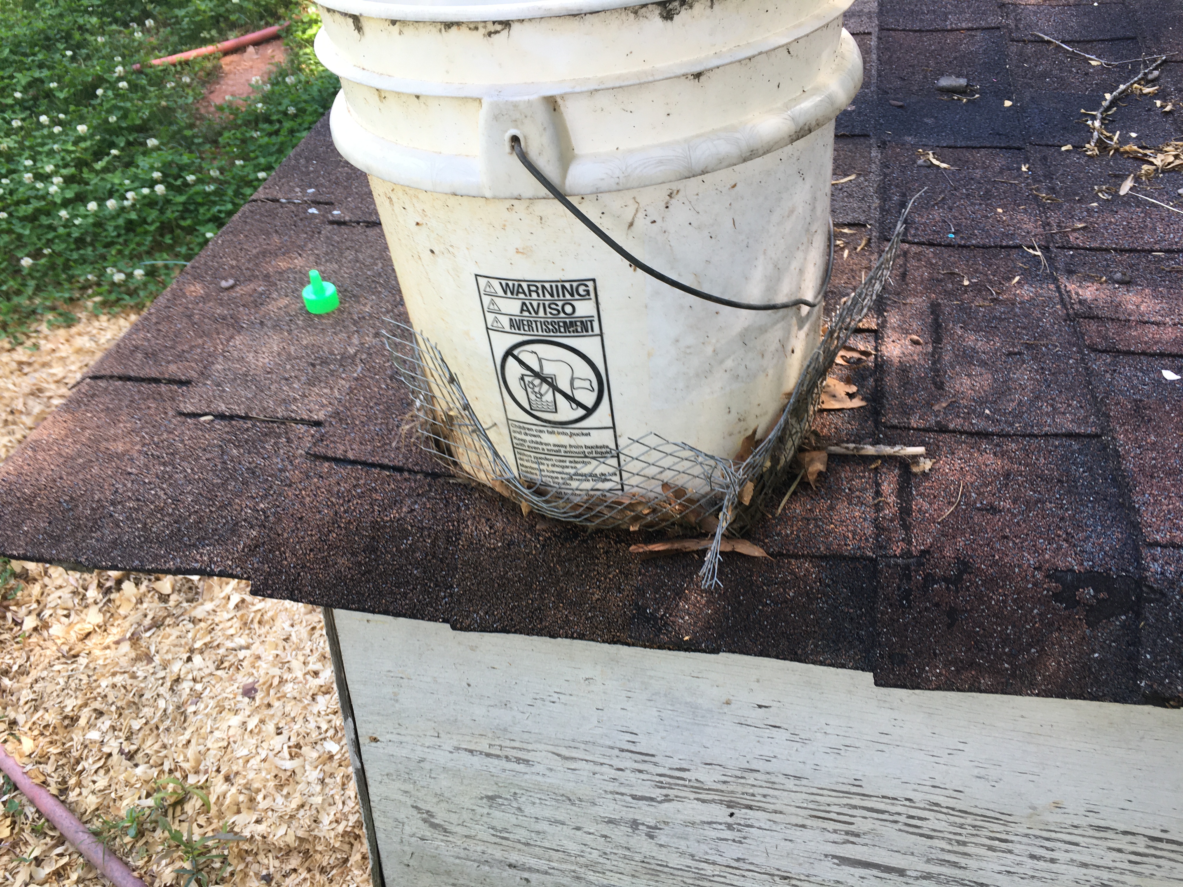

from my experience in those inline filters (3 different kinds), I suggest cutting the bottom out of a bucket and replacing it with chicken wire to catch the gunk when you spray the filter down.
The paint filter catches too much and will get clogged in the middle of a job, causing loss in suction.

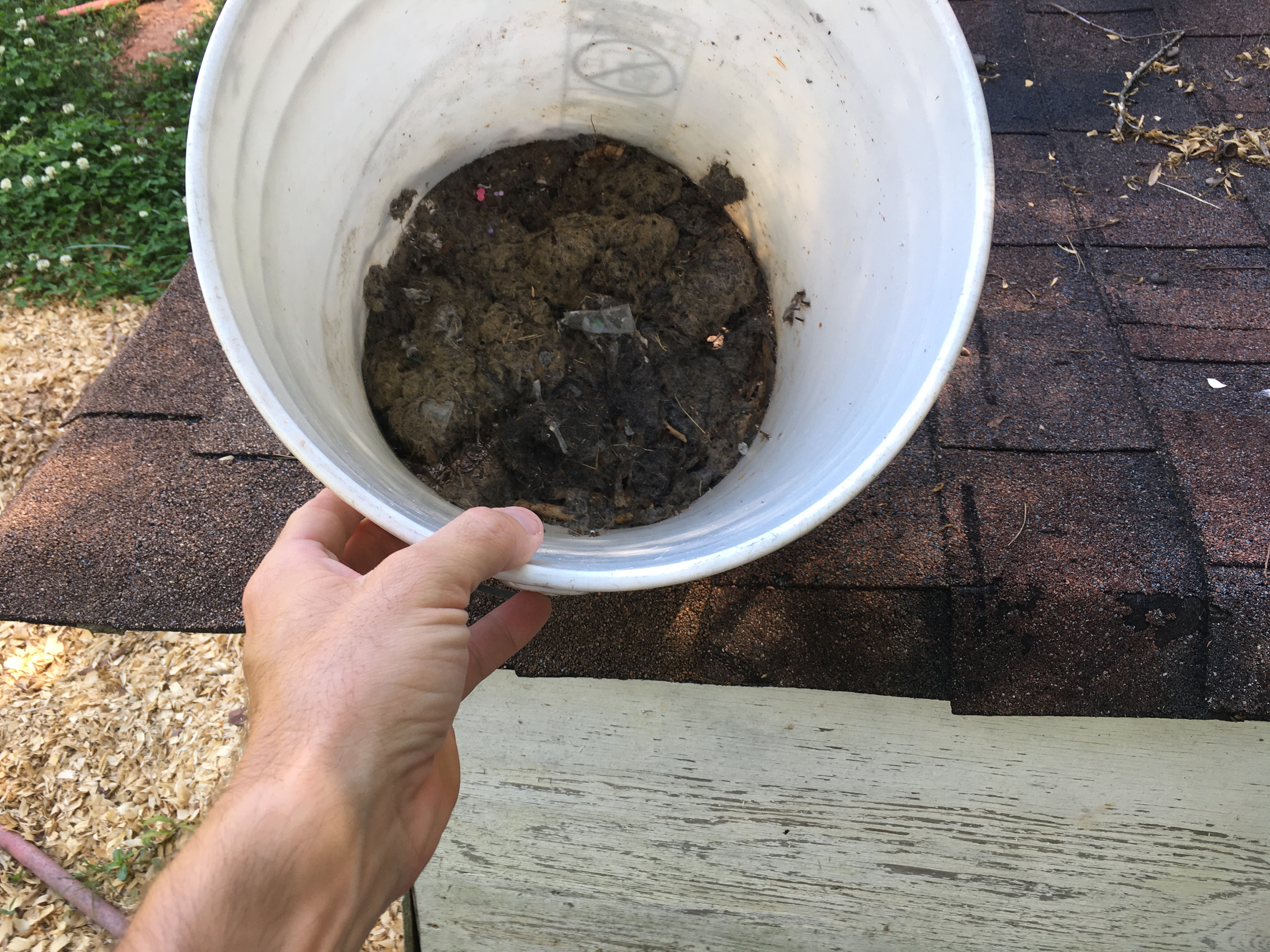

Vacuum or not, you’ll have more suction during the entire job, not just half of it. Use just a basket all day and tell us your wiseness, ol hogjowl. Who gave you that name anyway?
D407CFAB-D9F4-4693-BCC3-16BE09277E46.jpeg 97AE5DDC-C4EF-478F-BC0C-FC6E954934DA.jpeg
