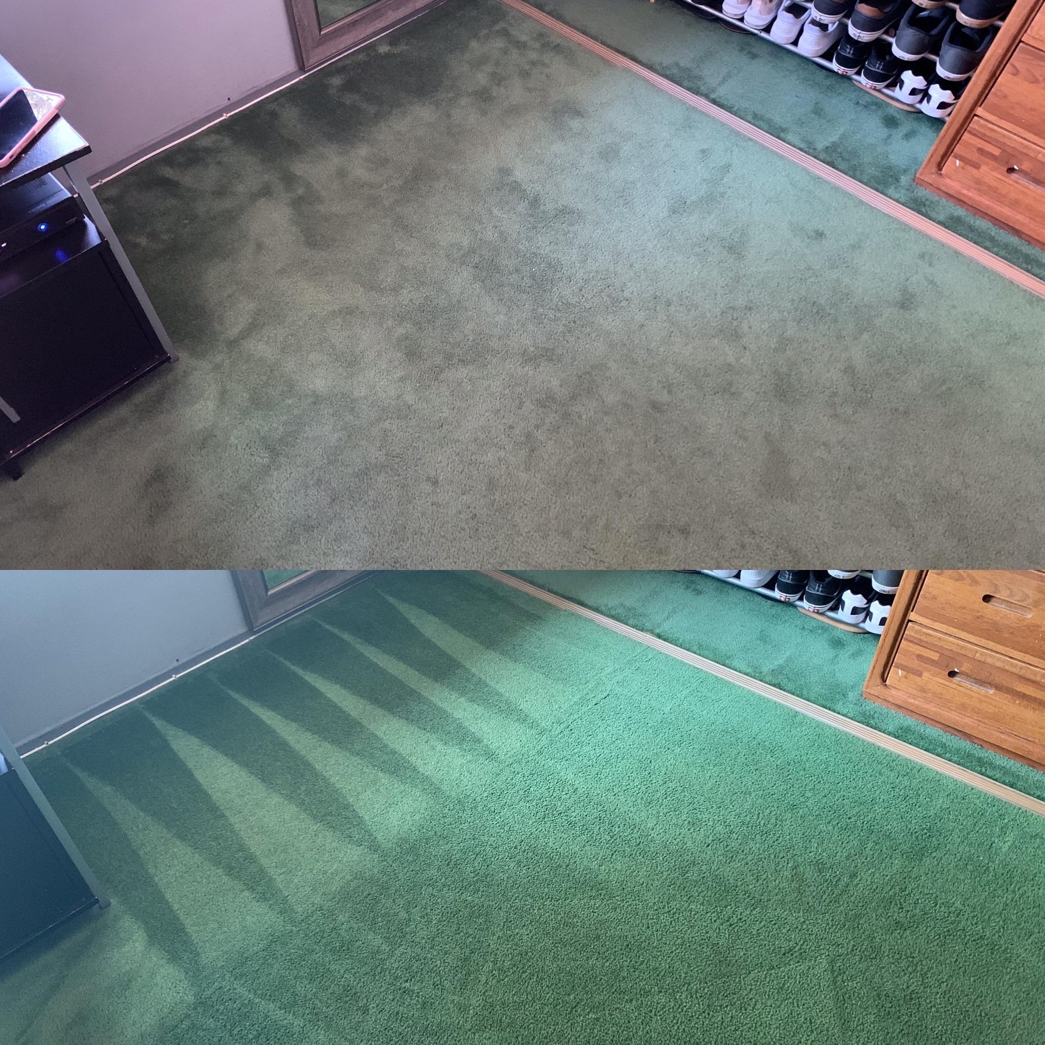

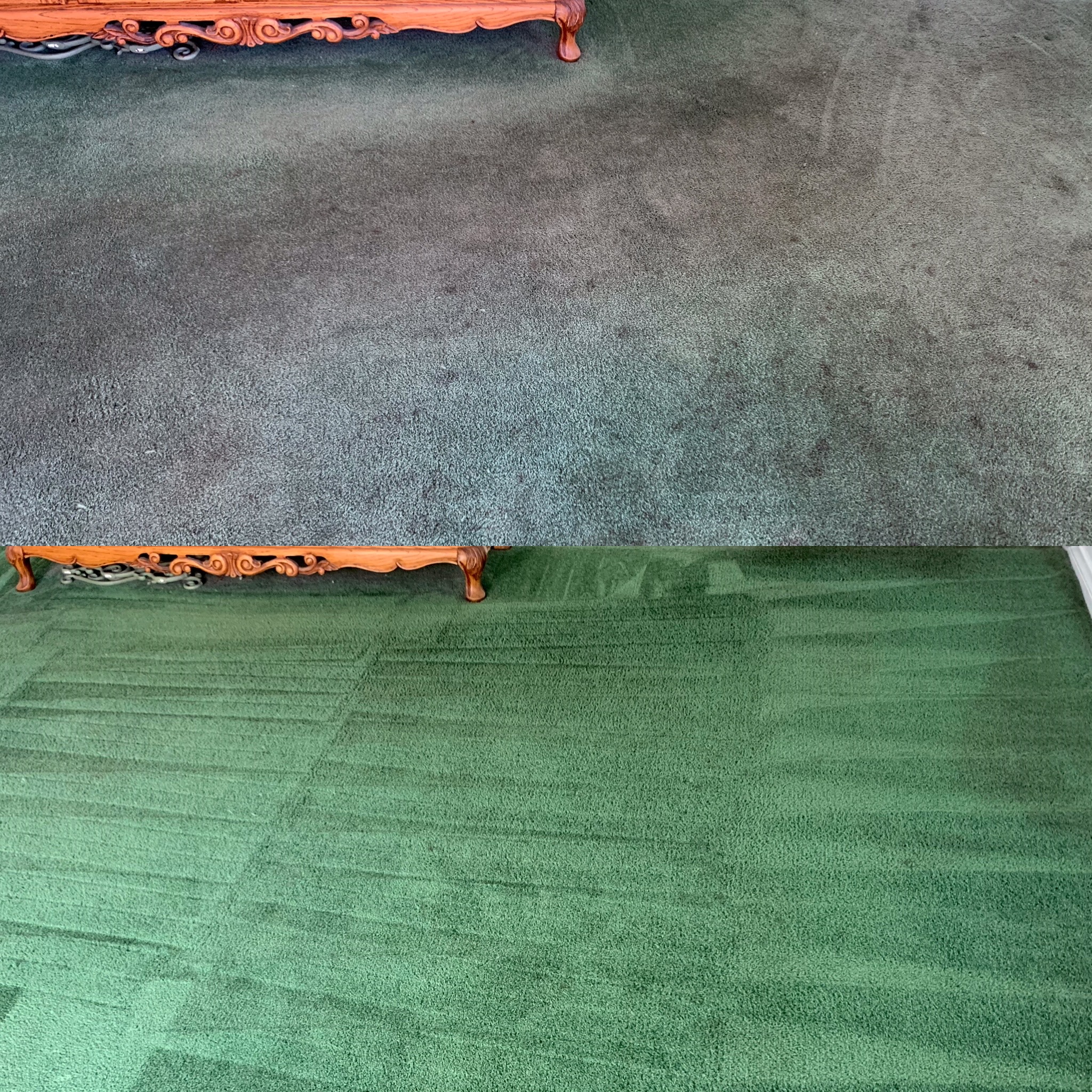

How’s it going everyone? Did my first cleaning today (my fam’s house) And for the most part things went pretty smooth. Something I kept having issues with was switching the solution line between tools. There was too much pressure to pop the line onto anything else without extreme force. What am I not understanding here?
Here’s a couple pics of the job too
BF00F533-BBD6-4D0B-9068-C123722E9163.jpeg A0267FC1-D261-4C32-9C11-6CC38D802278.jpeg

Turn your pump off, release the pressure by opening your courtesy line or bypass, go inside and attach your solution line, go back out and turn on your pressure pump.
One thing to always check before you turn your TM on is that your valve is closed on the solution line. Turn the valve on after you attach to your wand.
