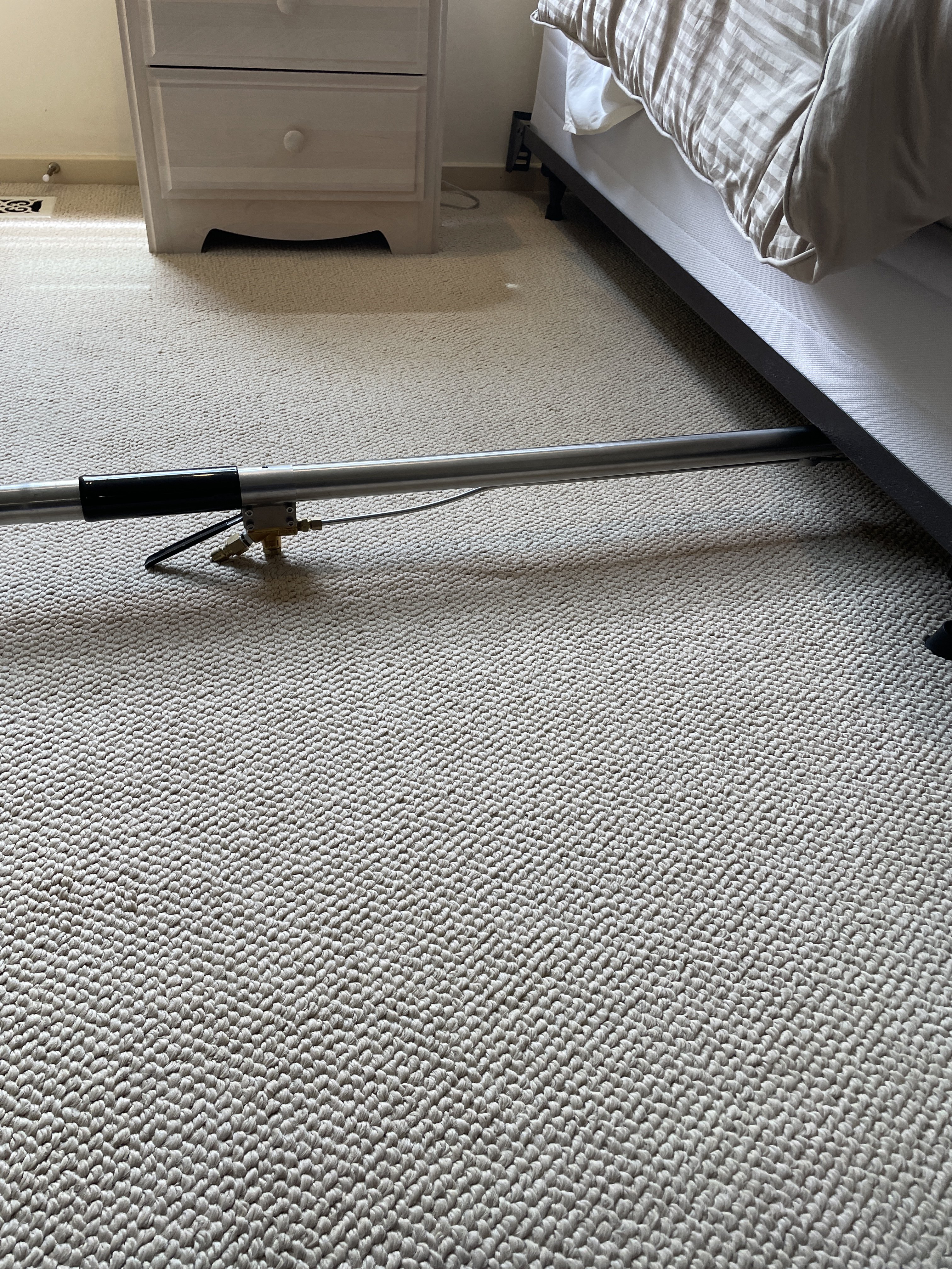

Bypass hands and knees, Im on my belly. From foot to head can get the whole king bed. Do it before prespray is better.

Or lift the mattress and box spring, clean between the frame, replace, and clean as usual….
THIS ISN’T ROCKET SCIENCE PEOPLE!!!
I lift, clean and replace if they are paying for it, or the bed is neatly made up with layers of blankets.
This wand is the best when working solo, and want to avoid dust flying when air movers in place. Probably make more in tips then if I was to charge. Takes a minute per bed, another minute to dust the nasty baseboards under there with microfiber mop.

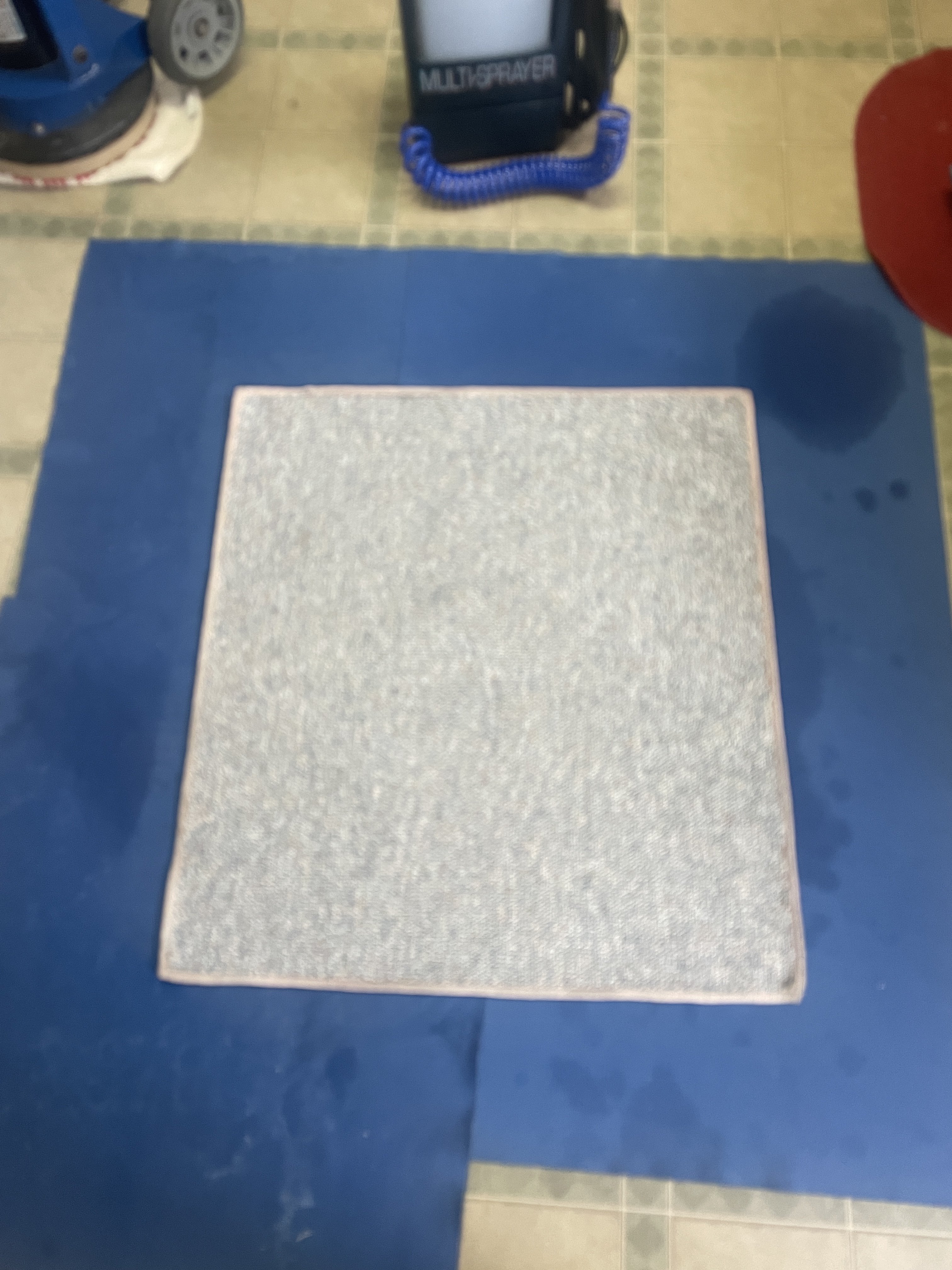

Here is the setup. I did my first job for a customer today with it being just one of the entrance rugs. The rest of the house is same. S0 I scheduled a pad cleanig first week of July on the carpet I HWE today.
It will be a cleaning in between rentals after a cleaning service vacuums. Should be in and out in 20-30 minutes after doing this sample.
The results were amazing. Trinity Odyssey w/ Tops PadCap Pro, applied with the M2 Multi-Sprayer
Before (looked worse in person)
After (looks better in person)
Dried super quick with no fans.

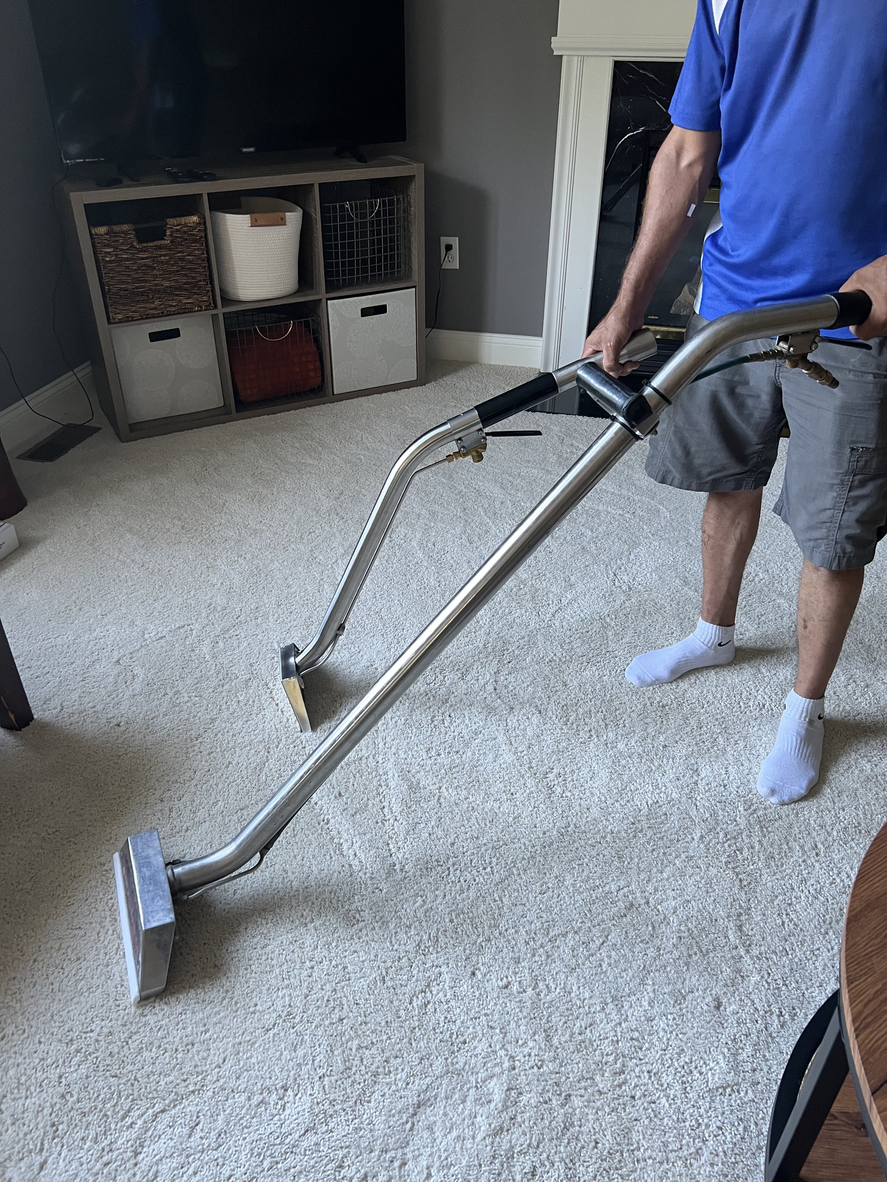

This is awesome. Hybrid Greeenglide,PMF 1530 on Sunbrella. Just got it, just saved me a couple hours.
Honestly got better results with more flow and vac.

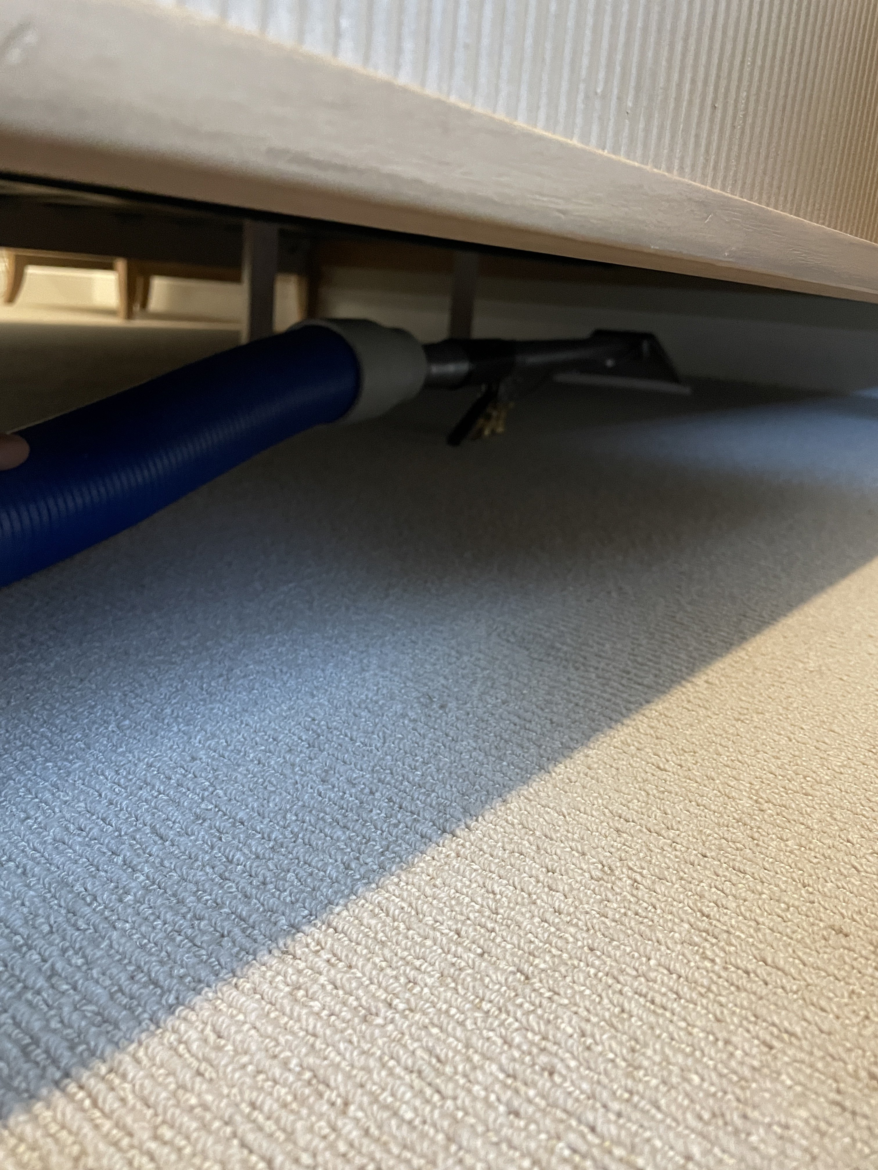

Cleaned here 5 years ago, before the PMF 1530 was in my life. No tabs needed now, didnt have to move the bed either.
