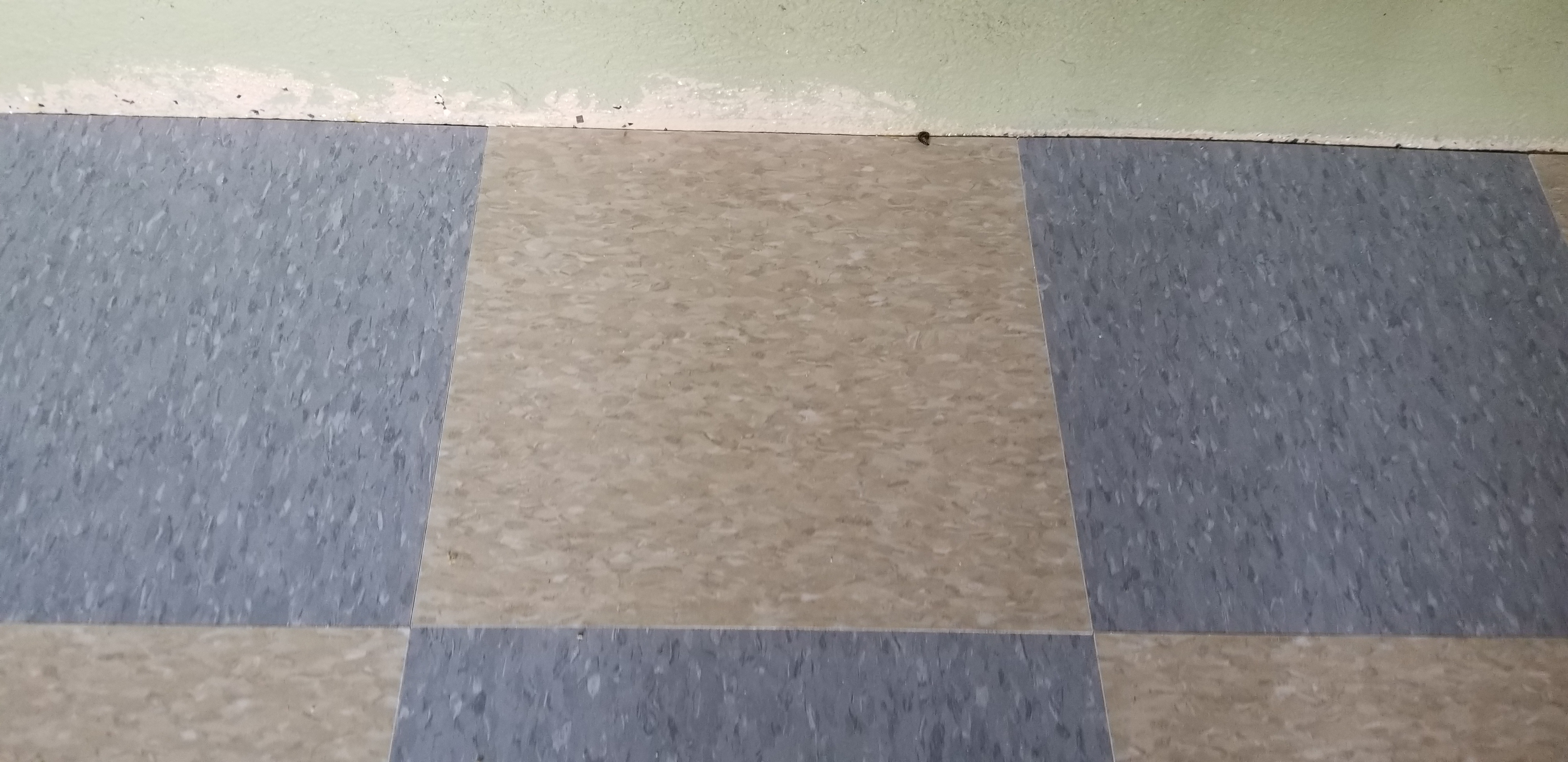

Hey all,
I just finished installing VCT on my garage/ shop floor (19x19). I'm a Tradesman and have installed what seems to be miles of VCT in my days. However, I was never there for the final finishing in order to see how its properly done. So I'm here to ask, What's the best way to finish my floor high gloss shine?
I installed Armstrong vct, Install was a breeze as usual, I do have 3 small areas that have a a little glue residue. ie;
2' thin line sections pencil line thin with glue residue.
Am I going to have to rent a Floor buffer in order to properly complete?
which brand of Acrylic/ wax would you recommend? Solids % ? etc
will it need to be stripped in order to remove the factory finish as well?
Upon starting how much time is needed in order to complete and drying time between coats and before placing everything back into my shop No car's. Table Saw, jointer, miter saw, band saw, Big heavy work bench, etc. Most items are on wheels, caster's except workbench

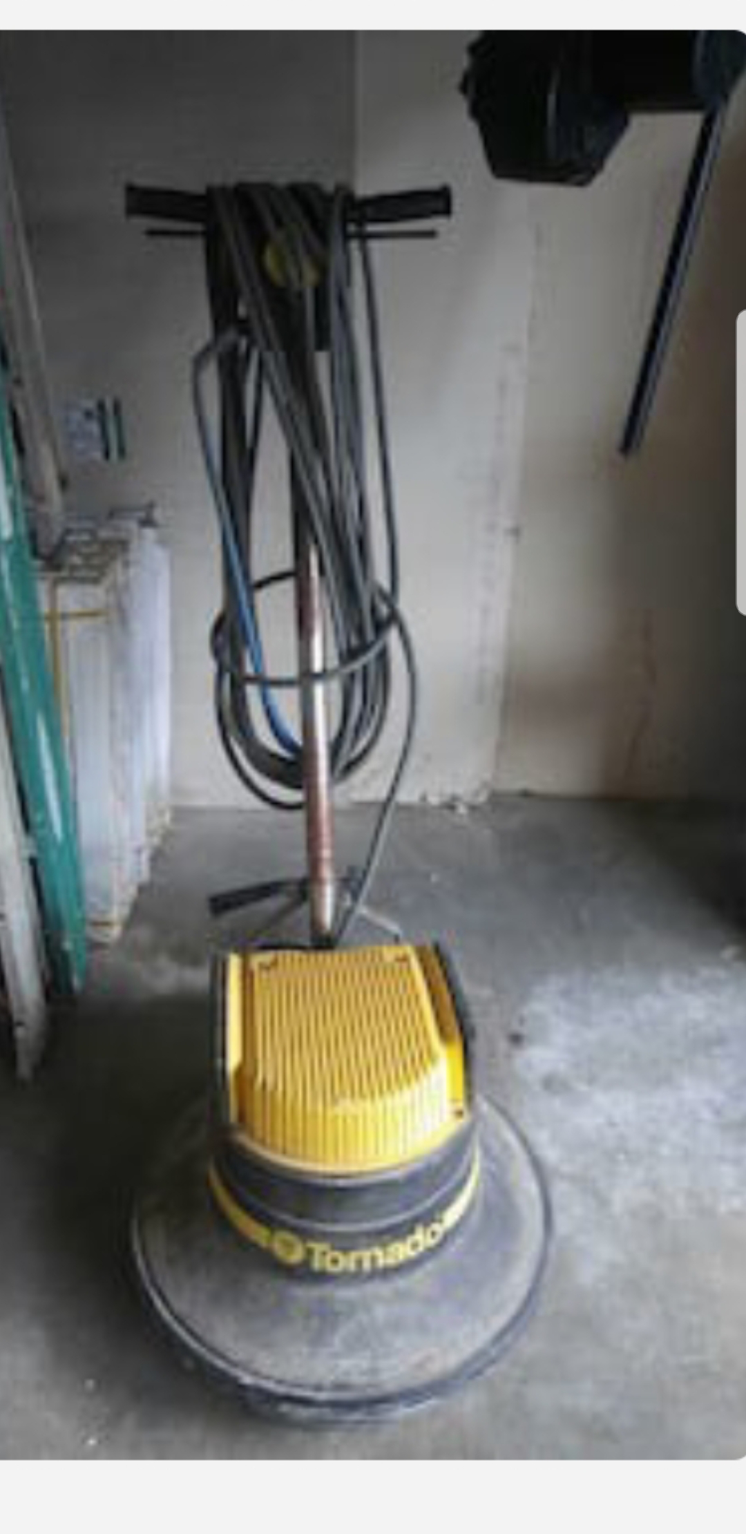

Hello again,
I've been a bit swamped with work lately, I came across a used buffer that's for sale and was wondering if this may be a good deal to buy and to hold onto vs renting at $37 4 hrs each time I may need it.
the guys selling it is asking $150
North East Ohio
Tornado brand has been around "forever"
If it runs, and the drive block (the large round removable piece under the machine that holds the pad) is in good shape, it's worth $150
Offer him $100 see if he bites
lemmie back up a bit
do you know what RPM it is?
175 rpm is best for scrubbing and striping
Higher rpm is better for polishing maintenance
Reactions: MtPockets

Yeah. I asked if that was the best he can do , as far as price goes and says he can't go any lower, as he paid over $1k for it, and that it runs as if it's still brand new, no problems. I'm sure I'll get it down to $125.
its 175
