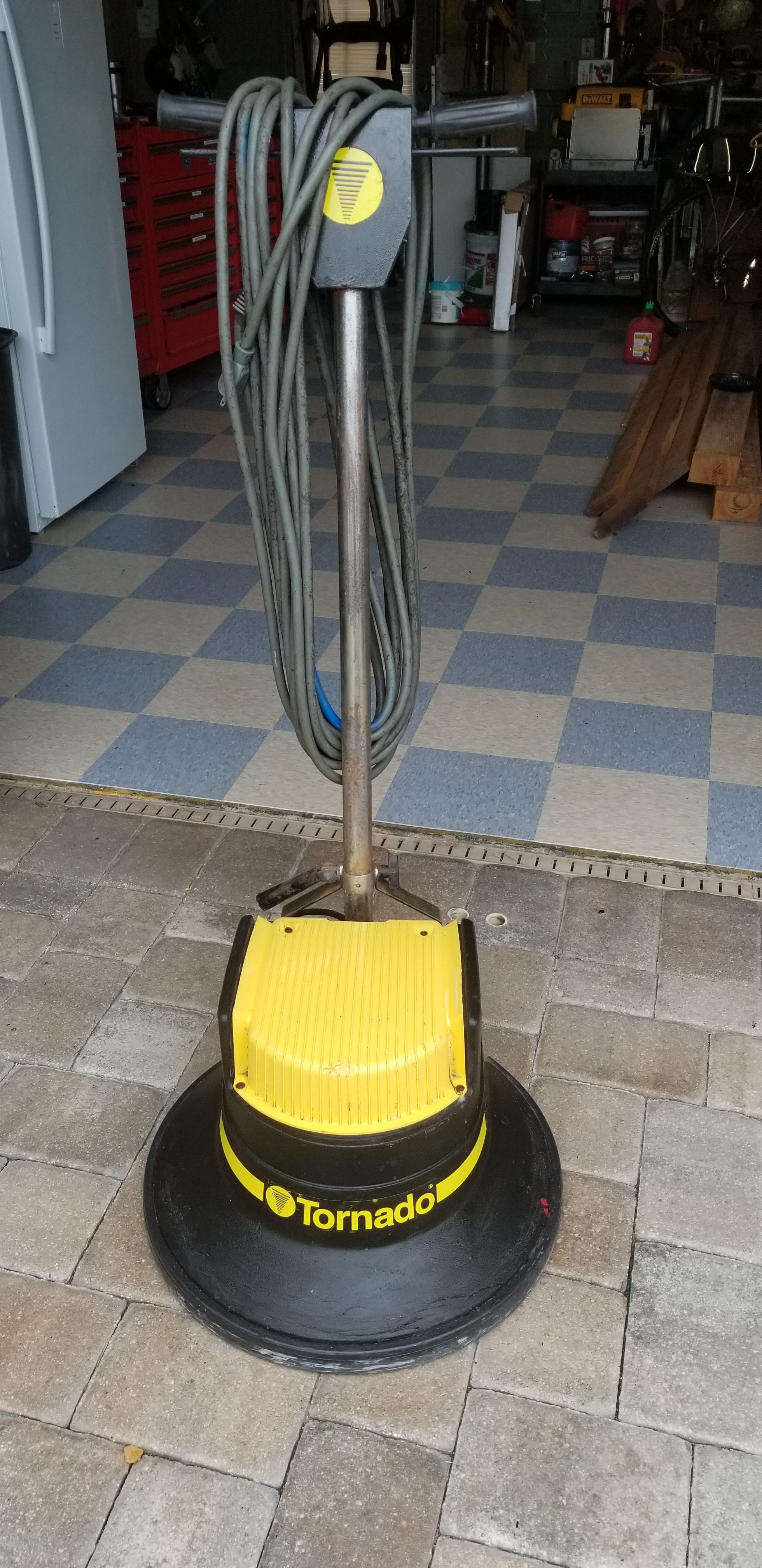

I believe she'll do $150 as Im not sure of situation. But is the Tornado the better of the 2?

Hey All,
I was finally able to contact the guy with the Tornado and picked it up just now. I now have come across another person that has 5 5Gal containers of GEMSTAR Stratus. He said he's " looking to get" $80 for the lot of 5.

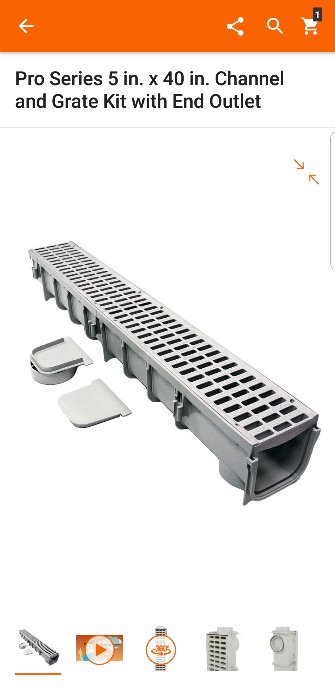

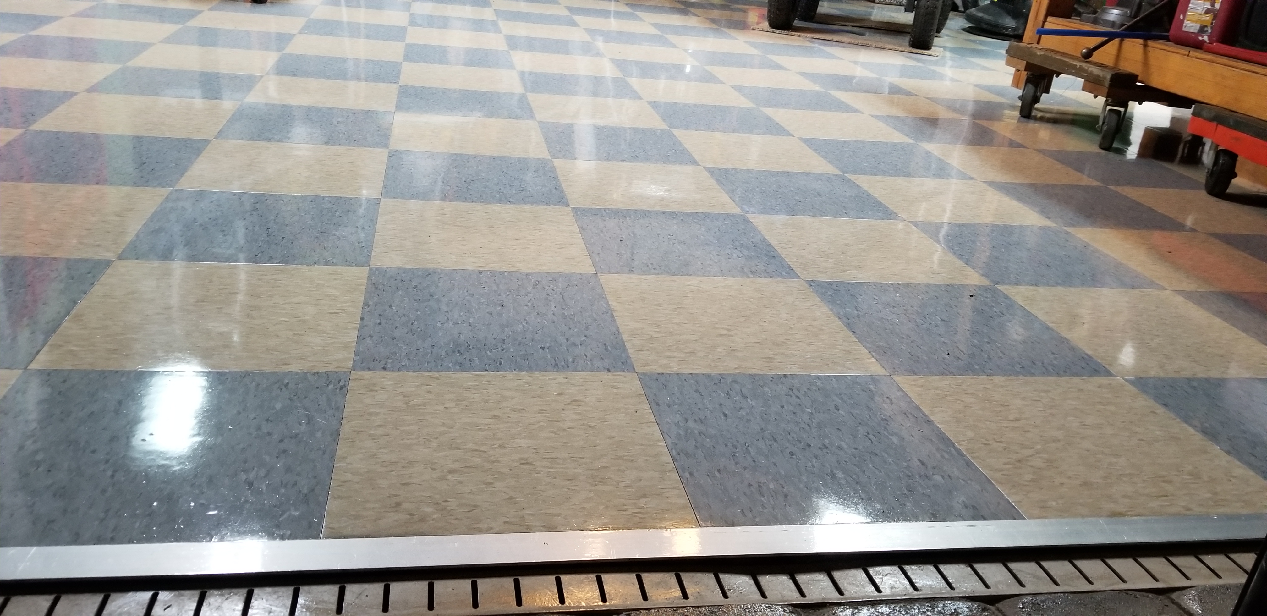

You'll notice that I haven't finished of the front edge of the VCT yet, Because my paver guys weren't paying attention to the pictures that I gave them as to the type of drainage system I wanted. I'm going to replace the cheap plastic one thats there and upgrade it to a larger one, so that it an be properly cleaned when need be

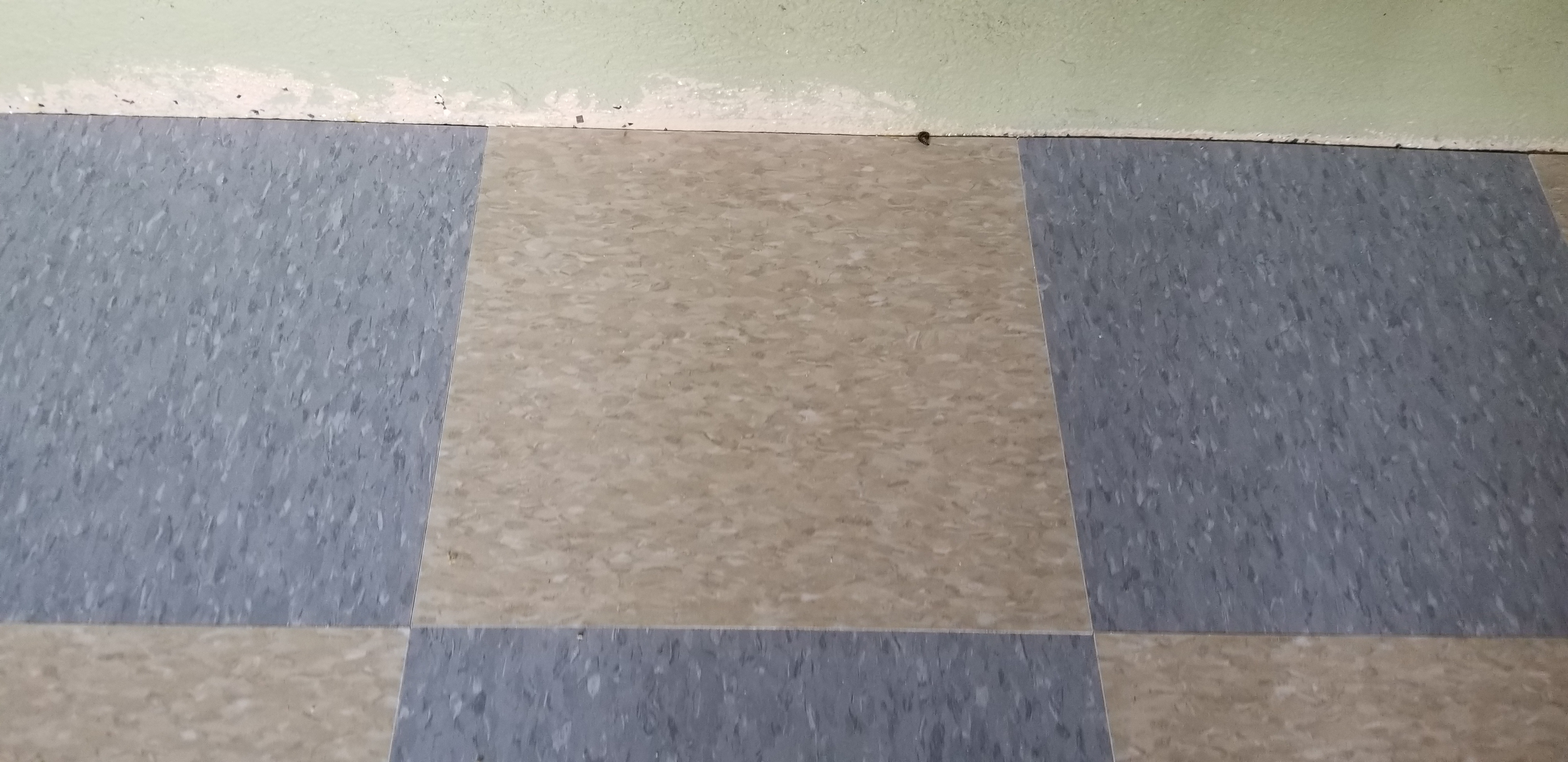

Being that I haven't yet decided yet if I'm going to use a rubber cove base, would it be a good idea to squeeze a bead of silicone around the perimeter?
I would cut at least a half inch of that sheet rock off all the way around. Before installing the cove base.

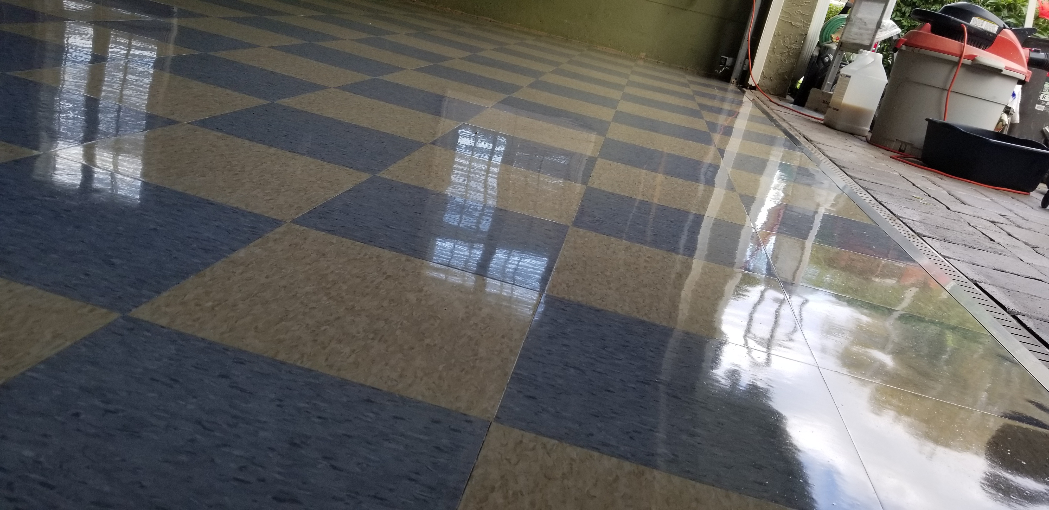

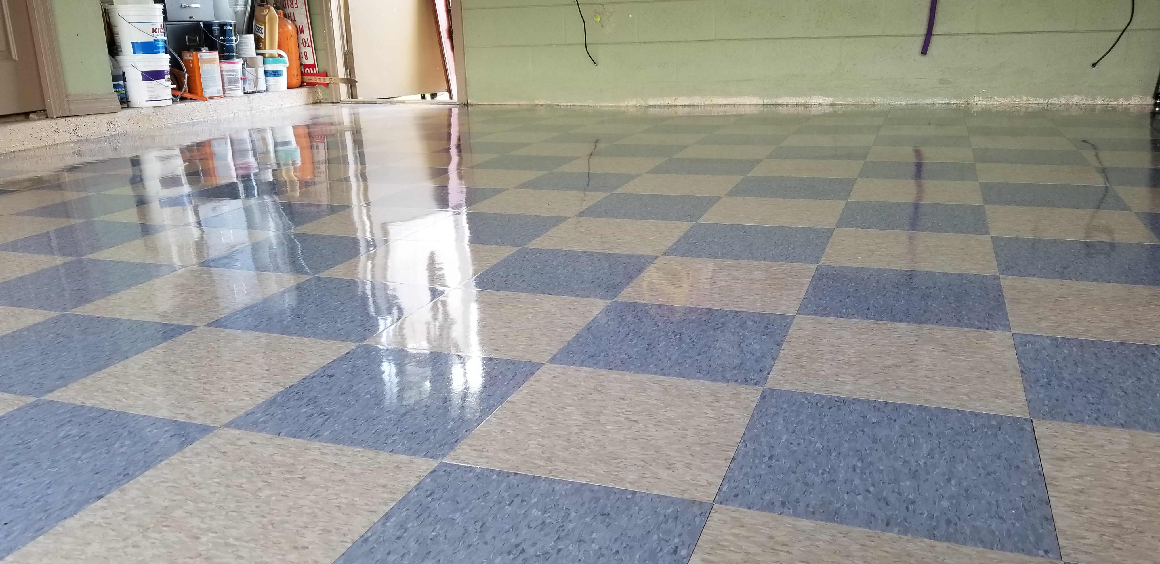

I do what I call "2 past awesome" which equals six coats of finish, here is why. The first 2 coats of finish you apply are to protect the tile, that is the main purpose of putting finish on VCT. Coats 3 and 4 will give you an awesome shine like your floor looks. Coats 5 and 6 are applied to protect your awesome shine, thus "2 past awesome"

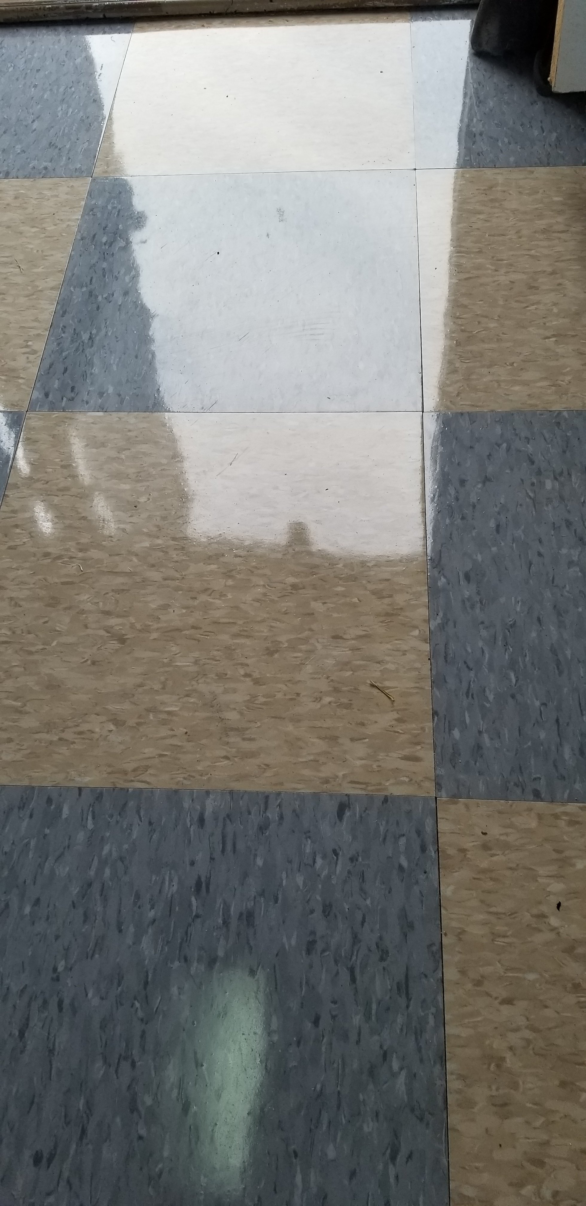

Andy,

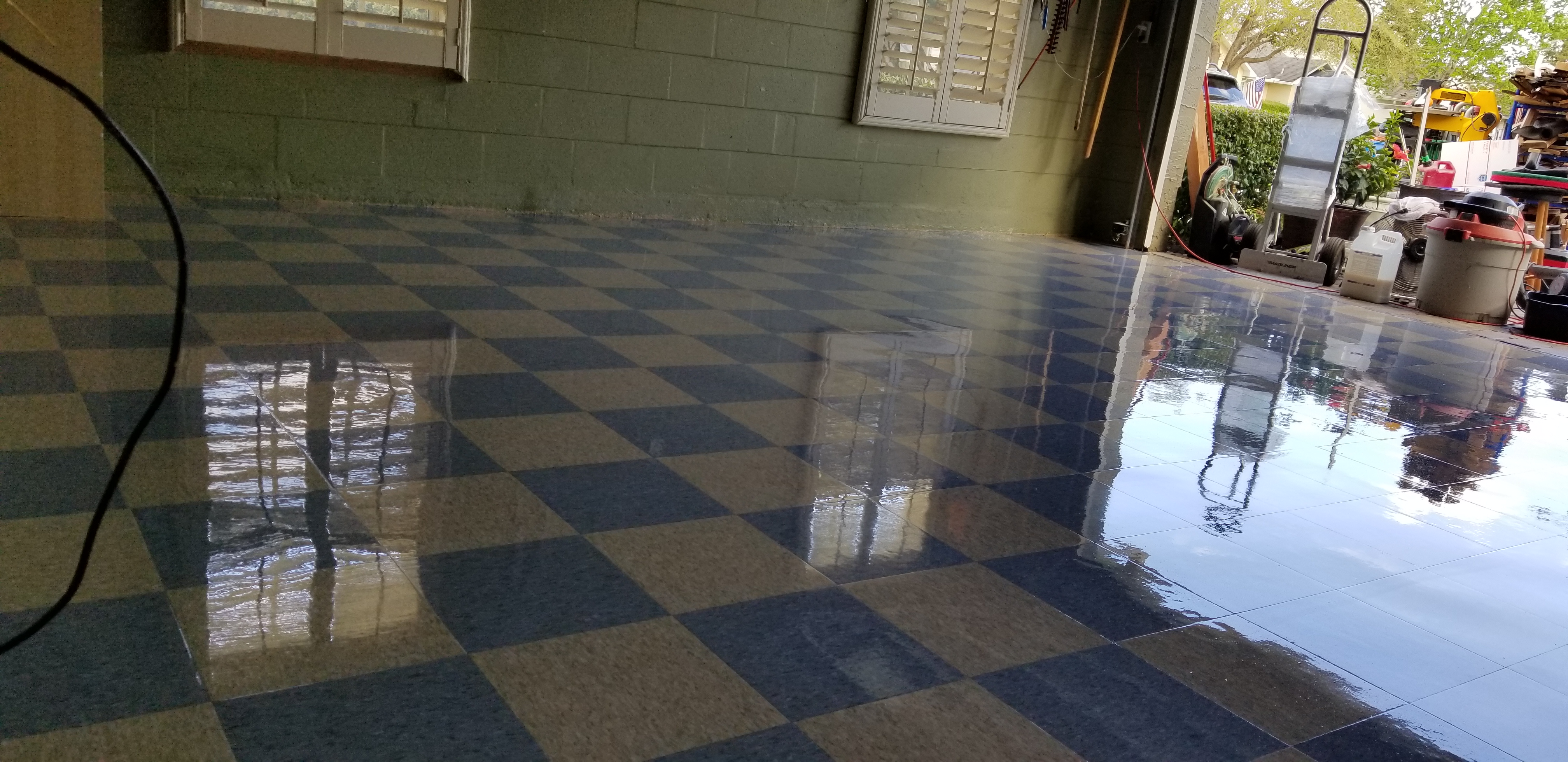

I really wanted to, however i was fighting potential rain and daylight, then having to bring everything back inside again.

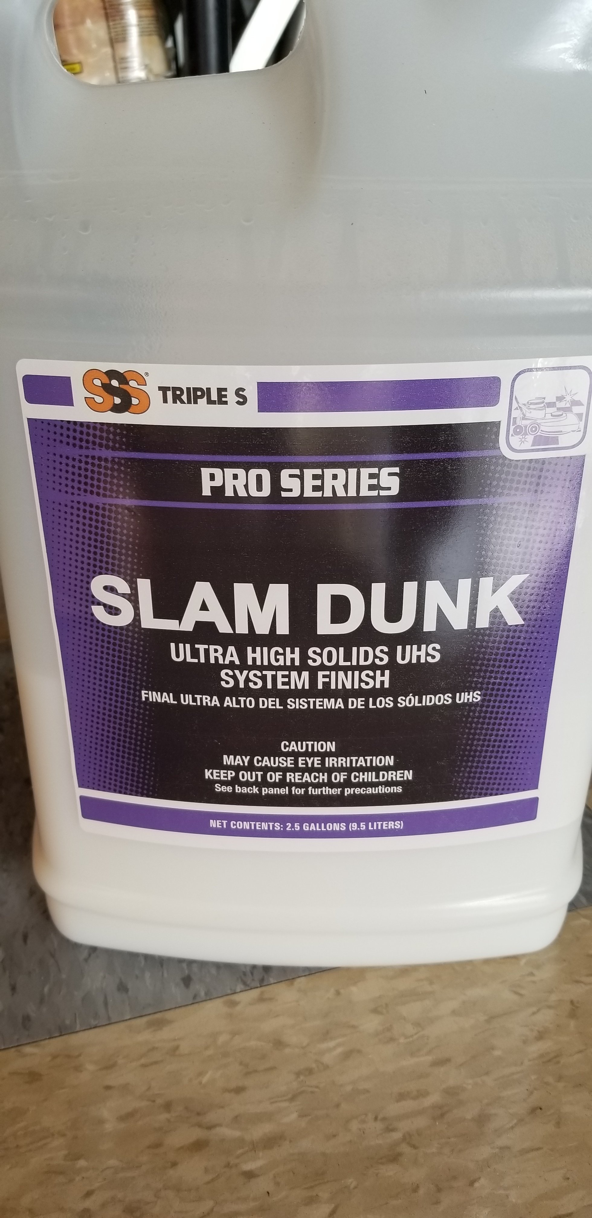

Question:
Can i apply additional coats, by moving half shit to one side and then coating, then after it dries, do other side?
This is the finish i ended up picking up from my local supply house
J Scott W
Oct 16, 2006
4,061
Jeffrey Scott Warrington
Andy,
Question:
You will have a line where the two halves meet. To to make the line fall between tiles rather than in the middle of one tile, and you will have a pretty good result. Maybe some painters tape to make the line straight.
MtPockets
Nov 18, 2018
23
Dino

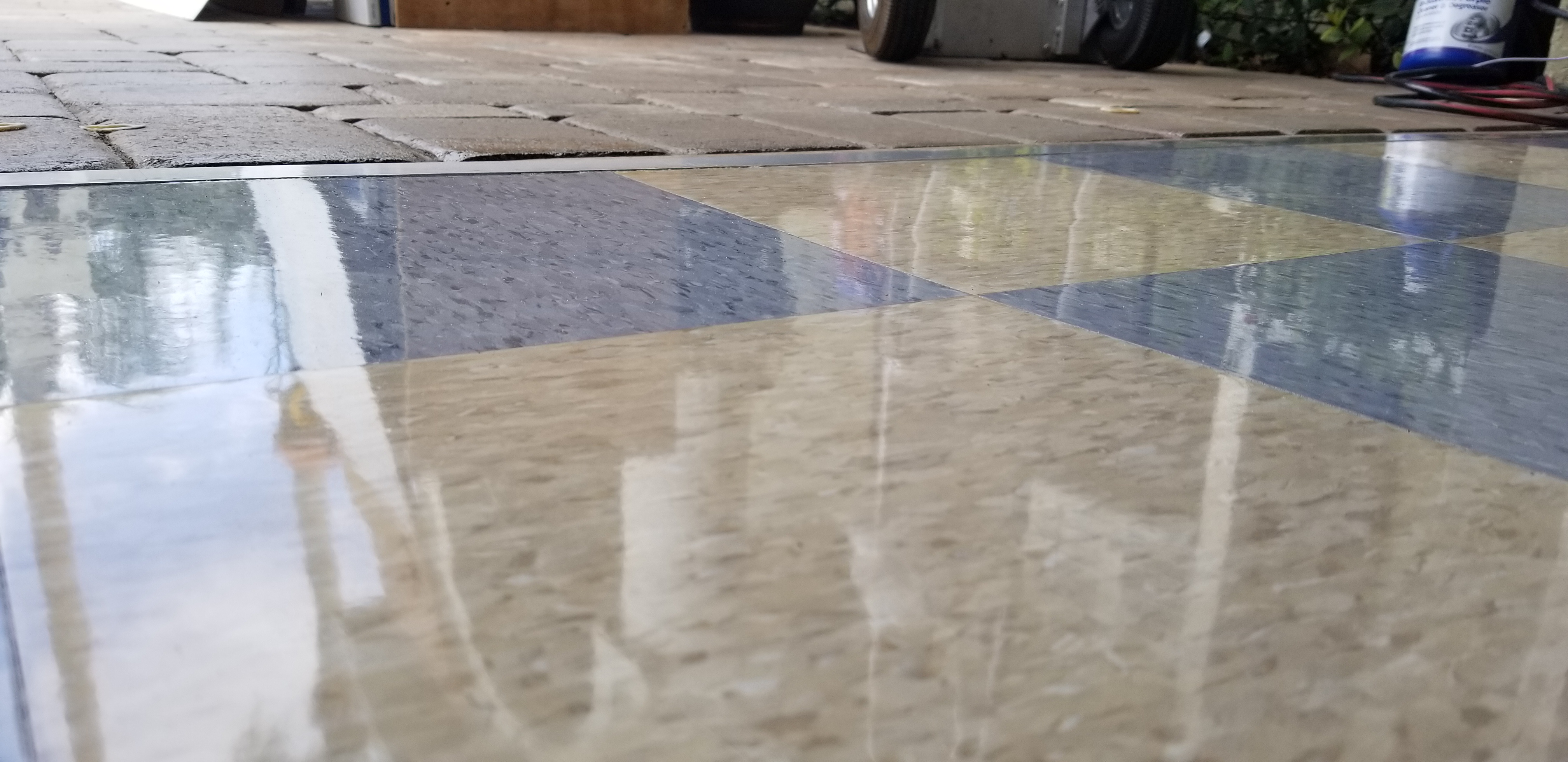

Lmao Nomad TY, Thats a booster for sure..
I thought for sure i was gonna eat off of it myself, after all the time it took from start to final finish and putting everything back. Some people werent as happy on a Saturday..😂
It just never seems to amaze as to not having flying bugs until your applying finish to something..
I I I did have some tweezers handy for between every coat.

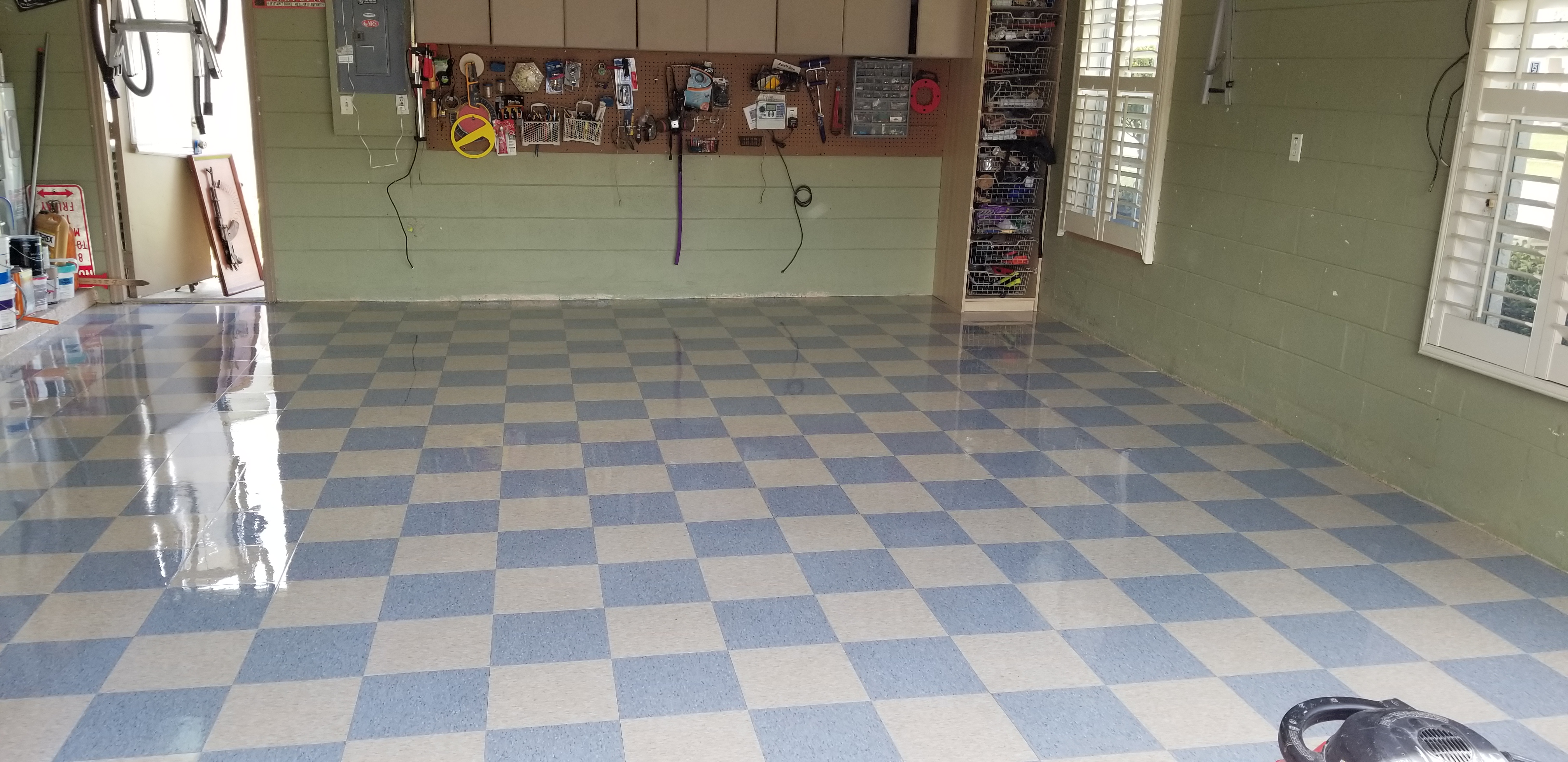

15,251
While it looks good I have to question if it's really worth the effort to have to maintain it. Over time in a garage expect deep scratches and wear and it will be ugly in no time.

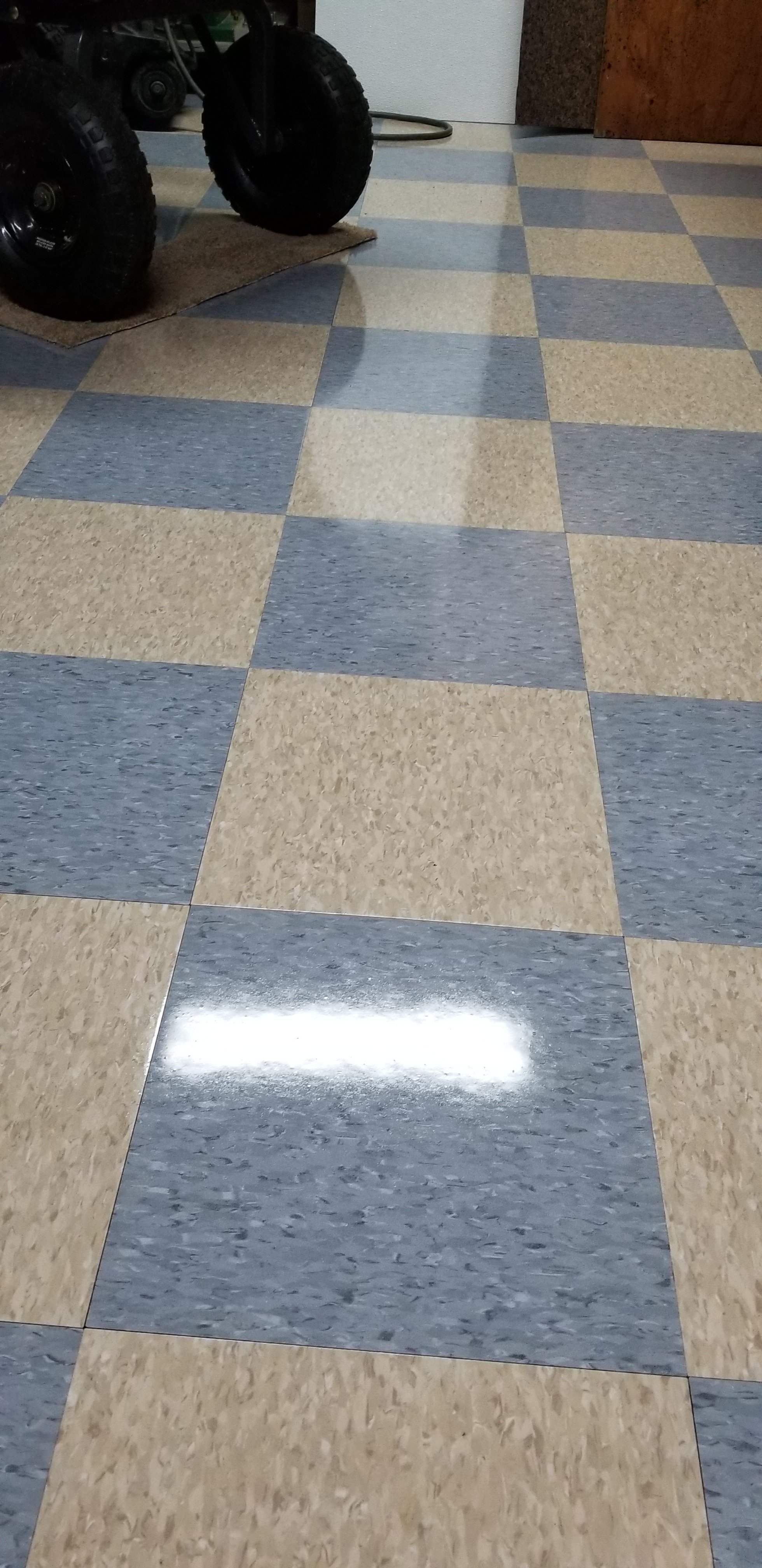

Thanks Jimmy, lmao... i think I'll hold onto the buffer now i suppose😂
I dont have a lot of traffic, just about everything is on wheels,
Tablesaw, jointer, planer, tool chest, bandsaw, soon to have 900# workbench on wheels too once i complete it..
Also, made sure to keep a box of each tile for those times..
Andy,
You were right on the money with saying that the Pneumatic tires will leave Yellowish/ brown stains.. I had that happen with a 4 wheel cart, however only the cart and not anything thing else which is weird prior to finishing, but i replaced them... i talked to the saleshole and was told that i shouldn't experience that after the finish is applied.... i do have that cart resting on a cpl scrap pieces of carpet at moment, until my shed arrives
9,859
But if it does start to look ugly, you can scrub and top coat and make it look good again. You can do that a couple of times. Then, you can do it over again with ease since you didn’t put 6 coats down. Carry on🤷🏼‍♂️
