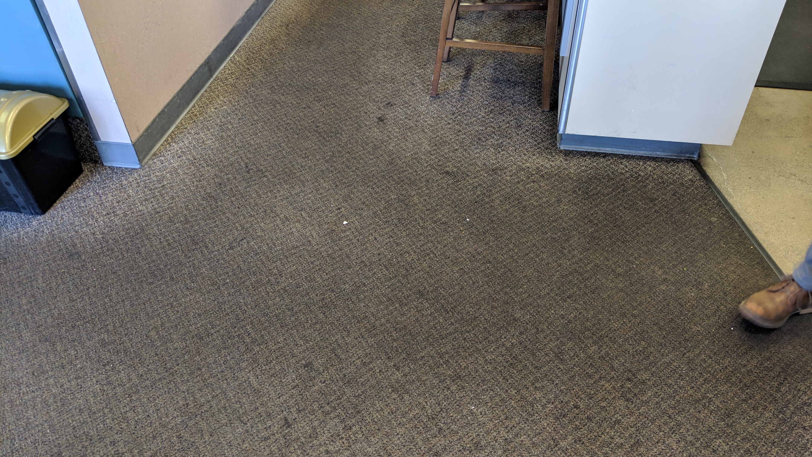

Went to Peg's recently on Meadows, the concrete is all shiny. There's a coating on it tho. Not sure what.

It's not formulated for carpets. You're going to want to video it and put it on Facebook and YouTube, etc. You will have all the Internet trolls screaming at you for using an inappropriate product. Nothing wrong with Code Red or Prochem Ultrapak Extreme. Both will deliver excellent results. Try Procyon plus powder as your rinse. You will be amazed.

Lot of tile cleaners are labled as carpet cleaning booster.

I've used code red on these places I've also use ultra pack Extreme prochem power Burst and yes they all work but they need agitation cut through the grease saiger think tsunami is gnarly enough to not need to cut through and since this is the last time it's being clean not too worried about it but I'd like to avoid the scrubbing process which I can do by using the 360 eye but that's slow AF as you know but I'll experiment it's tomorrow afternoon we'll figure it out

Hey I’m sure you have but what would an emulsifier do for you like flex fire or dry slurry
