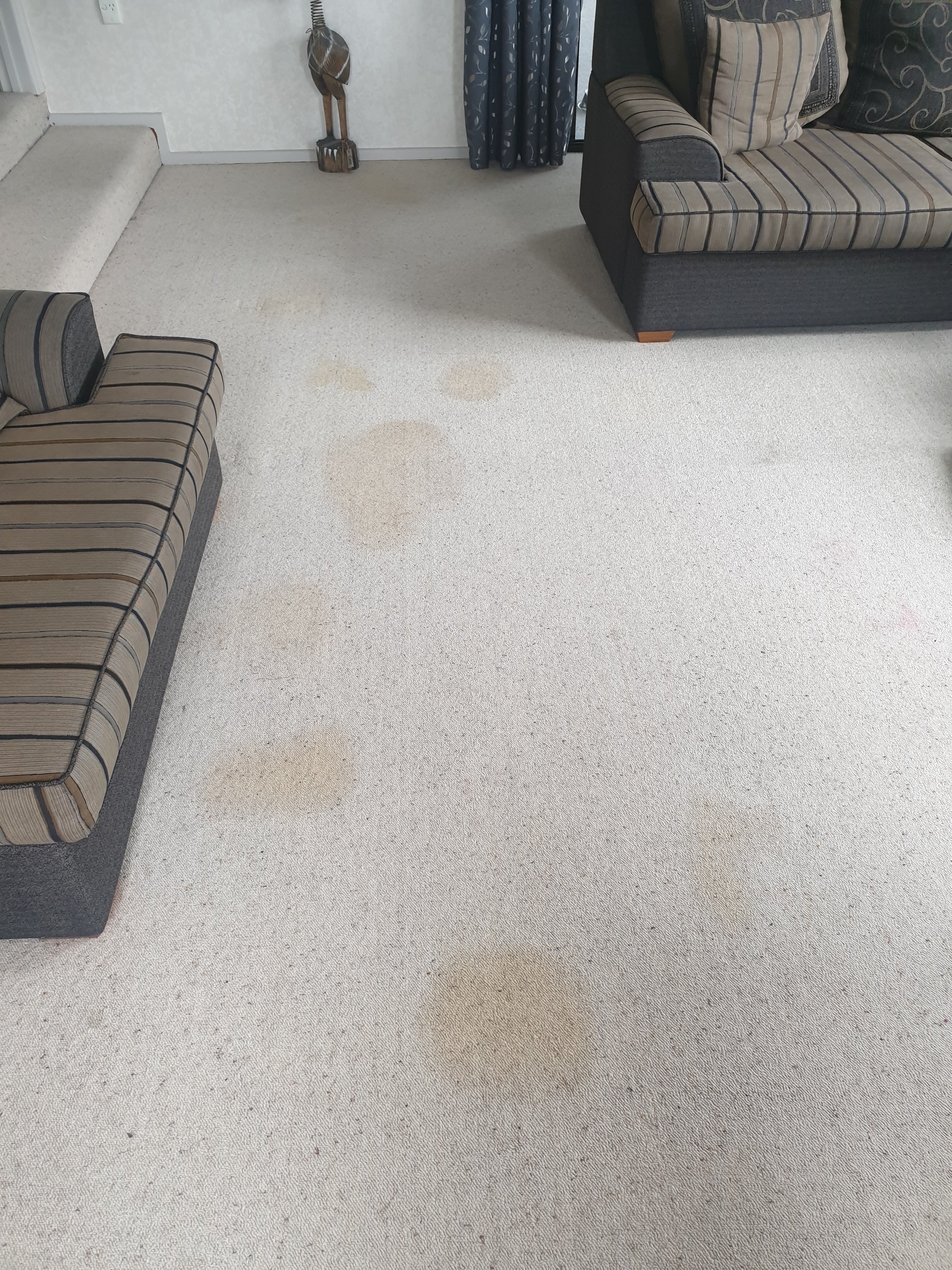

2 jobs today, both houselots of wool, both pretty much like this.. 20191118_104920.jpg
and I run out of peroxide arrgh! 😡

I’ve only ever carried 40volume, and I’ve been scared to use it on wool
Reactions: Condog

woolsafe says 8% (I think) which presumably is them looking under a microscope for damage with nothing but the fibre taking the hit
I normally mix 6-9% with a colloid booster and it will work on urine just takes time, I figure the urine takes most of the hit before the fibre

WoolSafe allows up to 3% on wool. More than this you’ll get minor degradation of the fibre an potebtisl colourloss. Around 12% the yarn starts to felt. Much more than this and it turns to jelly.
I'm going off memory, haven't looked at woolsafe standards in long time.
But pretty sure 5% is max recomended for zero damage with 8% as restoration level? Which I class urine as.
I see more than a few felted wools from my competitors who chemically accelerate it, if accelerating I prefer UV or heat which is more easier controlled than applied chems imo
