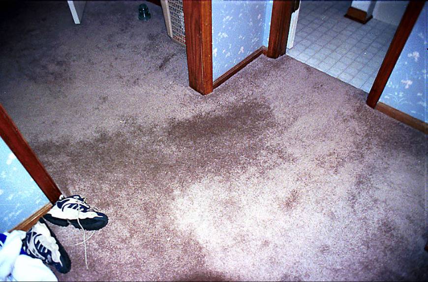

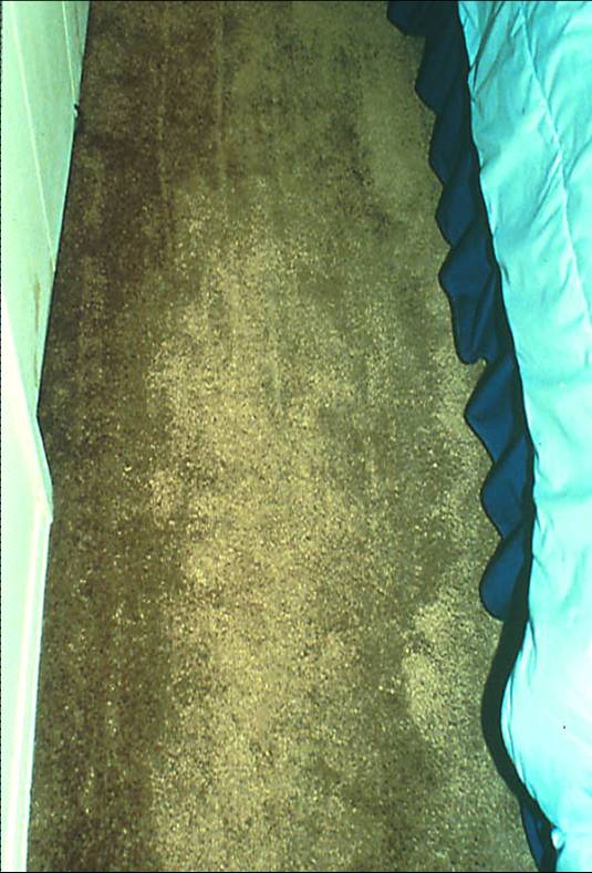

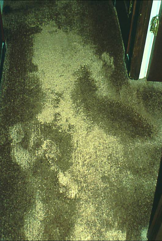

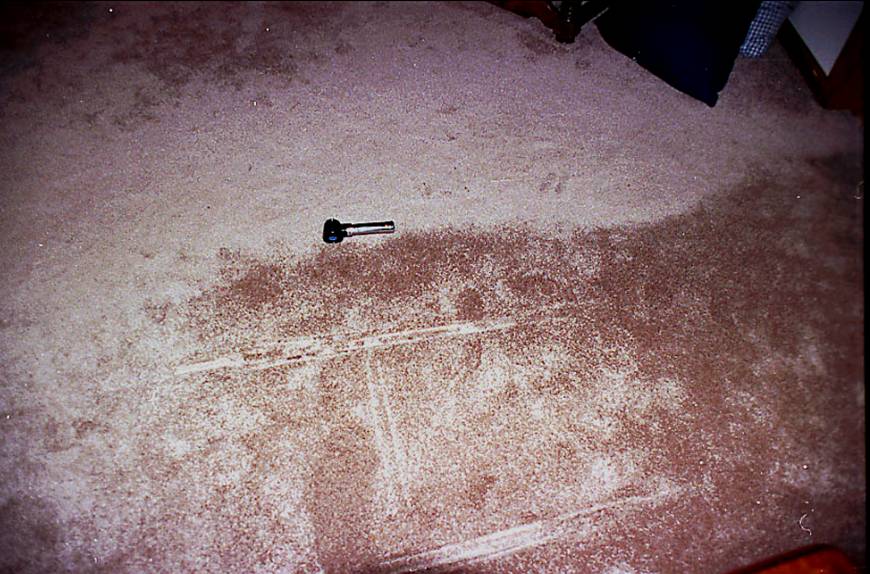

Chemically the fibers are different. Olefin and polyester both have a strong affinity for oil. An additional short-coming with polyester is its poor crimp retention. It will look flat and lifeless in the traffic areas pretty quickly, but they continue putting it out in cut-pile.

The "advancement" in polyester is cramming it tightly together so it can't fall over. If the commercial loop product is high twist and is too tight to see the backing when you bend it backward, it might work.

But the wear characteristics of both fibers are the same. If you put both fibers in the same type of construction, there is no difference and that's all that matters.
