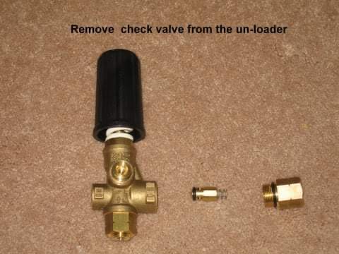

Does your truckmount use a regulator or an unloader?
I had a factory regulator and am back to using it. I tried 2 vrt3 unloaders with the check valve removed and verified that i was connected in and out correctly.
And have you checked your pressure with the same hose? You might have a bad quick release on your hose
I'm not even seeing pressure on my guage. Installed a brand new gauge. Also when i pull the hose on the out port of the regulator, I get no water on that side. The lo pressure side. I can turn the pressure regulator up and down without change.
Yes, I get a steady stream of water with seemingly good pulsing pressure shoots out about 12 feet from hose end when I pull the hose coming from the pump off the regulator manifold. While the hose is off, I can turn the clutch on and off and it turns the stream on and off.
