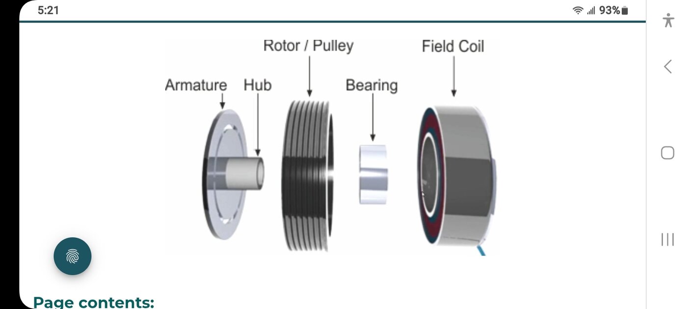

My guess is that you damaged it when you used a puller to remove clutch and pulled it from the rotor/pulley )outer part where the belt goes) which inturn pulled against the armature/ hub assembly (clutch plate which was stuck on th pump shaft )instead of using a bolt . If im correct ,time for a new clutch . After watching a YouTube video on removel of your clutch there using a puller but if its stuck on like yours putting alot of force on the rotor (belt part) to pull the hub (center) off the shaft probably damaged the armature and or the center bearing. Although what you might try doing lis try to push it back out eighter hooking the puller up and pushing on the back to push the armature off the rotor or if it mounted to the pump lightly ( i did say lightly l tap on the pulley to free it from the armature but be mindful and careful not to damage your new pump if you can get the armature and pully to spinn free you may have saved it

What it sounds like your problem is is the rotor is pulled up tight against the armature. And is acting like the clutch is engaged you eighter have to go from the magnet side and push the armature out(away from rotor/ pulley) or with the armature held in place knock the rotor/pulley away from the armature if you run it for any length of time the way it is if it starts slipping it WILL generate alot of heat and perhaps even sparks the only way you can safely leave it is to convert the clutch to a pulley by drilling 1 or 2 holes thru the armature and rotor/ pulley tapping the hole in the pulley and inserting a bolt or to to make the 2 pieces 1 permanently. I drilled and tapped the clutch o my old machine and carry a ¼ -28 bolt in my glove box because ive had problems with the magnet in the past. And it left me dead in tje water( 2 hours from my shop of course)So if the clutch magnet goes out again all i have to do is align the holes and install the bolt and back in business. O ya make sure the bolt is short enough that it doesn't come in contact with the magnet (when tightened it doesn't stick out the backside)

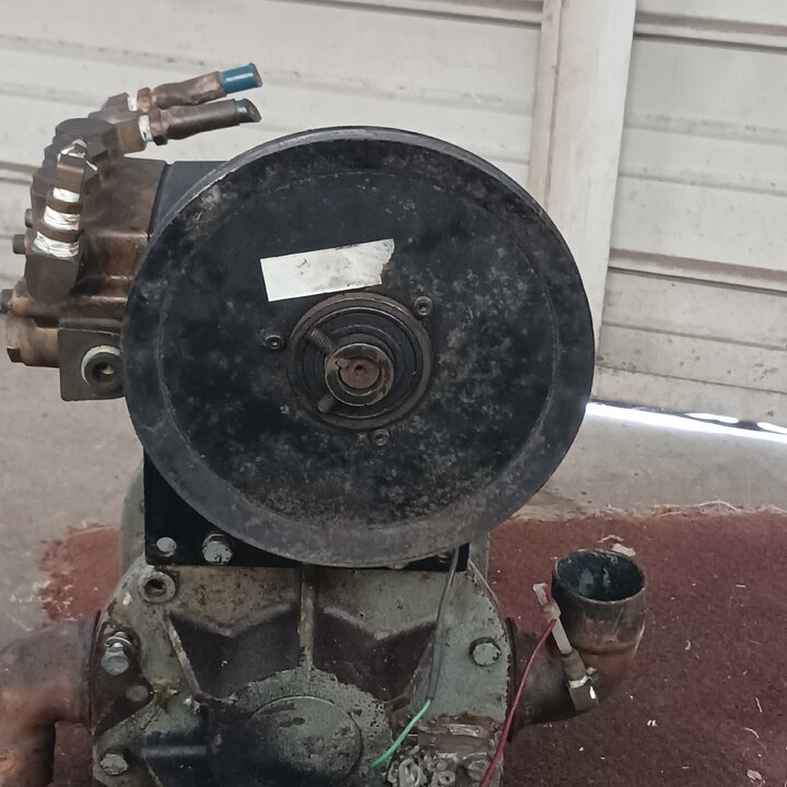

Turns out i have at least 2 pump clutches they each are configured double A belt and fit a ¾" straight keyed shaft. Haven't measured diameter both are currently mounted on hypro 2340bp pumps if your interested in one make sure shaft size is correct and let me know the diameter of your pulley and we'll go from there. These are my personal spare parts and not "free to good home". However if you want one im willing to part with it. I will test/pull/&ship when you receive it drop a check in the mail for what it's worth to you that'll be the price

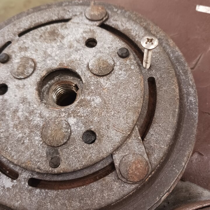

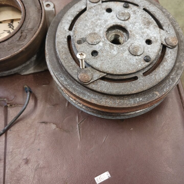

Im sorry, the clutch i drilled out and tapped is an old style obsolete clutch and has alot of space to bolt looks like the only way to do it on a modern style clutch is to remove the magnet and drill and tap inside the 6 grooves and use 8/32 machine screws. I did this 15 years or so ago memory's not what it used to be but with the magnet removed it shouldn't be necessary to tap just run a machine screw thru and put a nylon lock nut on the other end itll spin in the place once occupied with magnet
20250917_124220.jpg 20250917_124145.jpg 17581385944453484873898690930629.jpg

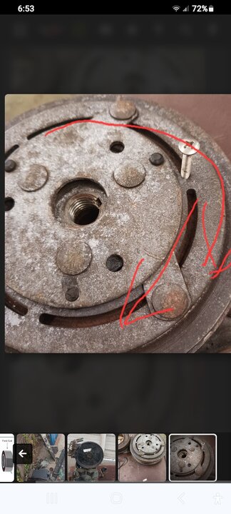

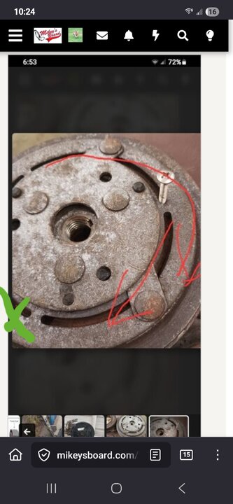

Just make sure that if you use machine screws that you place um where the armature butts up against them rotating see picture and if 1 bolt works 2 will work better

Clockwise according to your arrow. I suppose if the armature starts spinning freely and the pulley is spinning clockwise that makes sense. Would the armature possibly drift away from where it butts against the pulley when she comes close to a dead stop, and then nail it real hard upon starting up again? What if we stick one over there too to sort of pinch it both ways?
I was going to post a picture but I still can't post a picture! Argggh!!!

You just want the bolt to hold the armature so it cannot slip or move in the picture the bolt is in the proper place for clockwise rotation. If counterclockwise it would be placed on the other side of the metal partition (for lack of better word)

I fixed my pump today. Removed the magnet, drilled a few holes, and put a couple small bolts with lock nuts in to lock the armature in place 👌

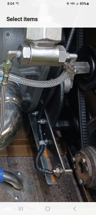

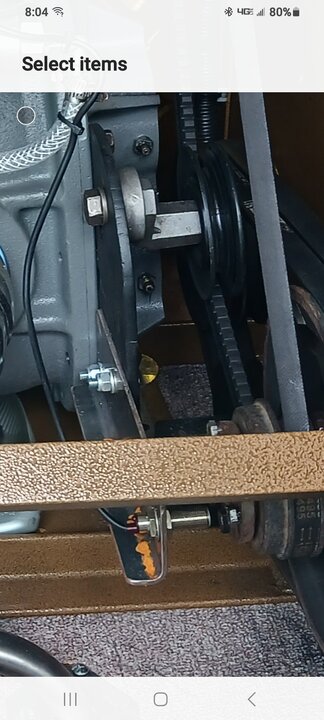

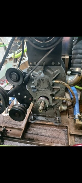

I'm having a hell of a time lining up my pressure pump belt, there isn't enough play to slide the mounting plate to make the 2 pulleys line up, so the vbelt is quirked 👎 Sounds fine but I bet it will chew through it prematurely, maybe even fry the bearing in my pulley eventually? I think I need to adjust the jackshaft and then realign my pressure pump pulley. I'm not sure how perfect they need to be but they are shamefully out of alignment.
I would have to see what your talking about. I can't believe that there isn't a simple way to adjust your belts. Im glad i only nee a crescent wrench to hold the cam and a 3/4 box end (or second crescent) to tighten the bolt.if it wasn't for my tachometer sensor i could change my blower andpump belts in less than 10 minutes (including removing the cowling) with the tach sensor its takes 15 or 20 minutes now love cam adjusters! . Can you walk the belt on with an wire or piece of cord?

I'll take some pics and share them with you shortly. I think the problem is that I messed up my jackshaft alignment when I changed the blower belt a few months ago. It is positioned in such a way where the pressure pump, even within it's range of play, cannot line up flush with it...

Getting the belt on and off isn't an issue. Aligning the pump and jackshaft pulleys is. This is as close as it can get in its range of movement. It is way off. The only way to adjust the pump is loosening the 4 bolts underneath it on its mounting plate, which allows it to slide forward and back and wiggle a little to the left and the right. Looking at the jackshaft it seems only the read near the blower is adjustable, and it is one range of movement: up and down.
