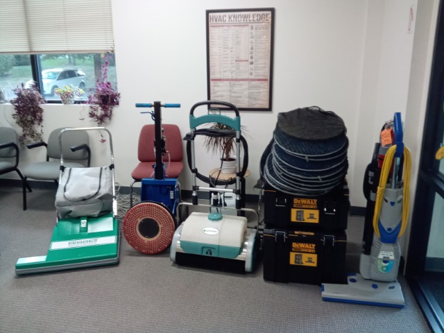

Instead of a Cimex I now have a 20'' Whittaker Trio that I use to scrub first and follow with Phoenix and bonnet. I don't do it that way on every job. Sometimes I will use a fiber pad on Phoenix instead of Trio.
Trio is definitely VERY LOW MOISTURE cleaning. It puts down a fine mist in front of 3 brushes with 75 pounds sitting on top of the 3 brushes. 15-30 minute dry times. It's a excellent scrubber

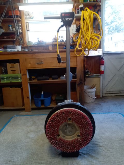

My first OP was a SprayBorg. I bought it when I first started experimenting with VLM 15 years ago and still have it
And I have a Tankless Vibe that I use on big residential so I know Orbot makes a nice OP
I bought that malish driver in 2015 for the SparyBorg. It makes SprayBorg/Vibe much more aggressive and digs deeper on residential carpet. Hated the velcro driver

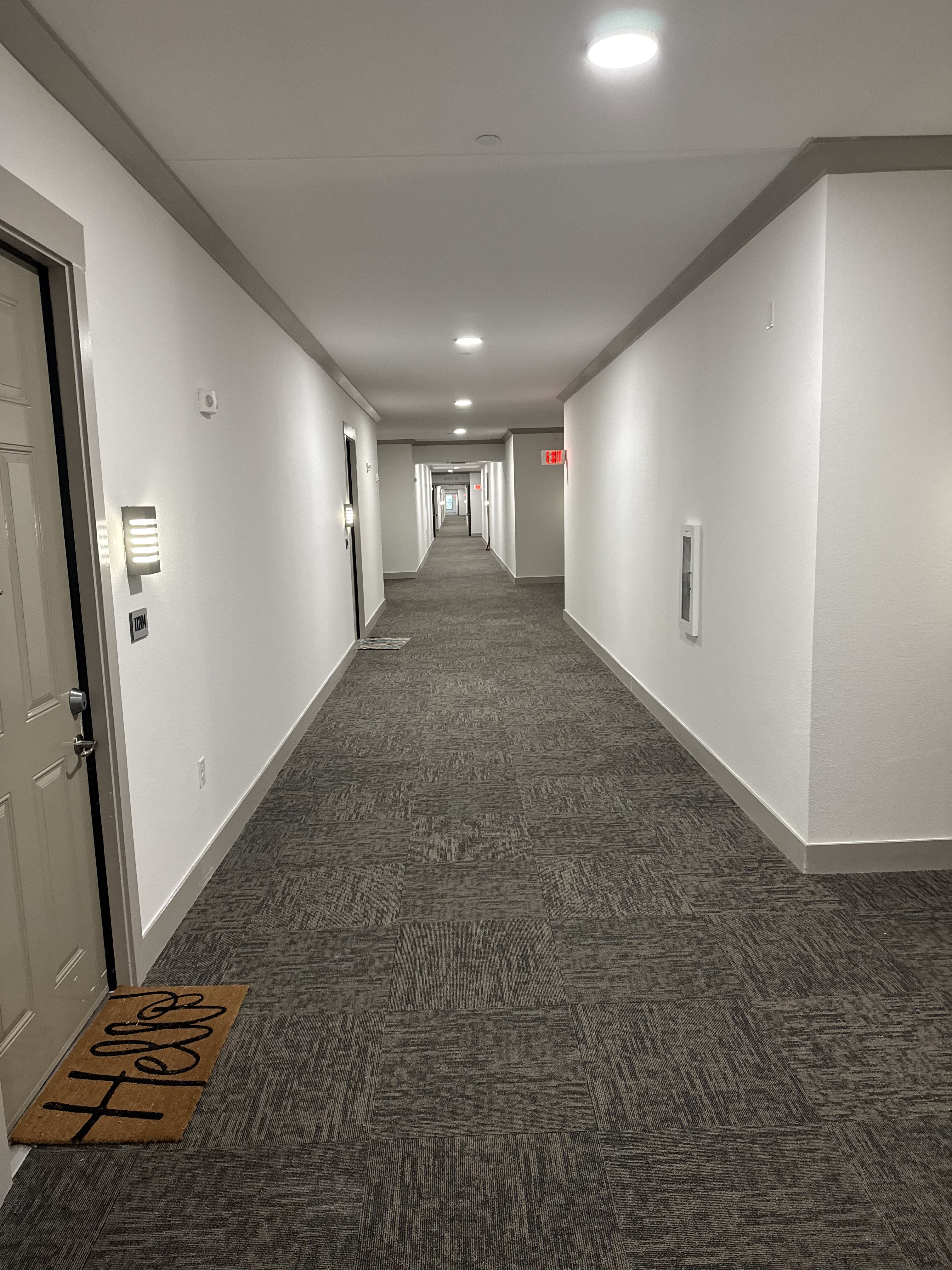

Well thanks to the advice and encouragement I got here I am moving forward with expanding my biz into VLM. Or is it LM? They want to to start asap and I am going to buy a used Orbot Vibe locally. I may have ordered a new Sprayborg but they appear to be 4-6 weeks out or more. Going to make a few calls in the am to verify. For those of you who do large cgd jobs I have 2 questions.
What pad ( bonnet) and size would you use for this cgd? (Link to purchase?) And how many would you use per day on 1 machine?

If it's all in that condition...
You can buy these from me or Rick but Direct Mop Sales is the imposter..
500 sf per side on that floor.
19"
If there are worse areas you'll want to pre scrub it when a brown 3M Fiber Pad, use the microfiber than follow up with a Glad Pad, which is a cotton blend that absorbs that gunk that the MF won't...
Both are here in 21"
