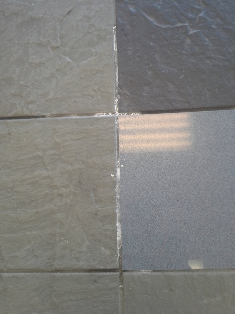

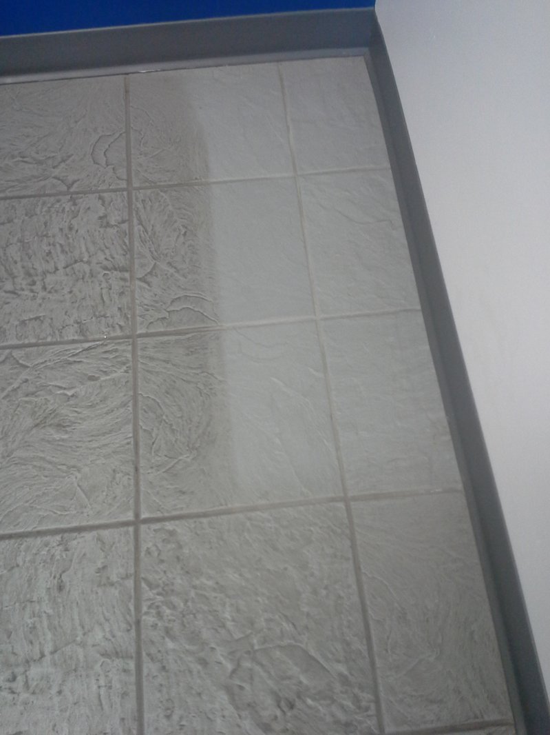

It looks like this should be an easy job. Im sure ill impress them.

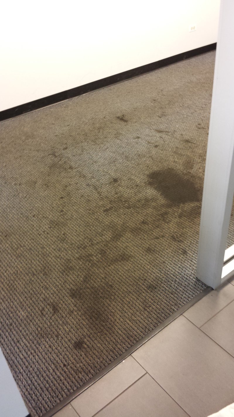

Steve,
It's a car dealership, they should be thrilled just to have it clean... Ever the nice ones are nasty!
The one below is the flipping lunch/break room.... Salesmen are slobs....
Put down a product, scrub the tile and grout, rinse it.... Then seal it. They are stupid if they don't seal it, most know it needs to be sealed(easy money).
5k of tile will be a lot of work.

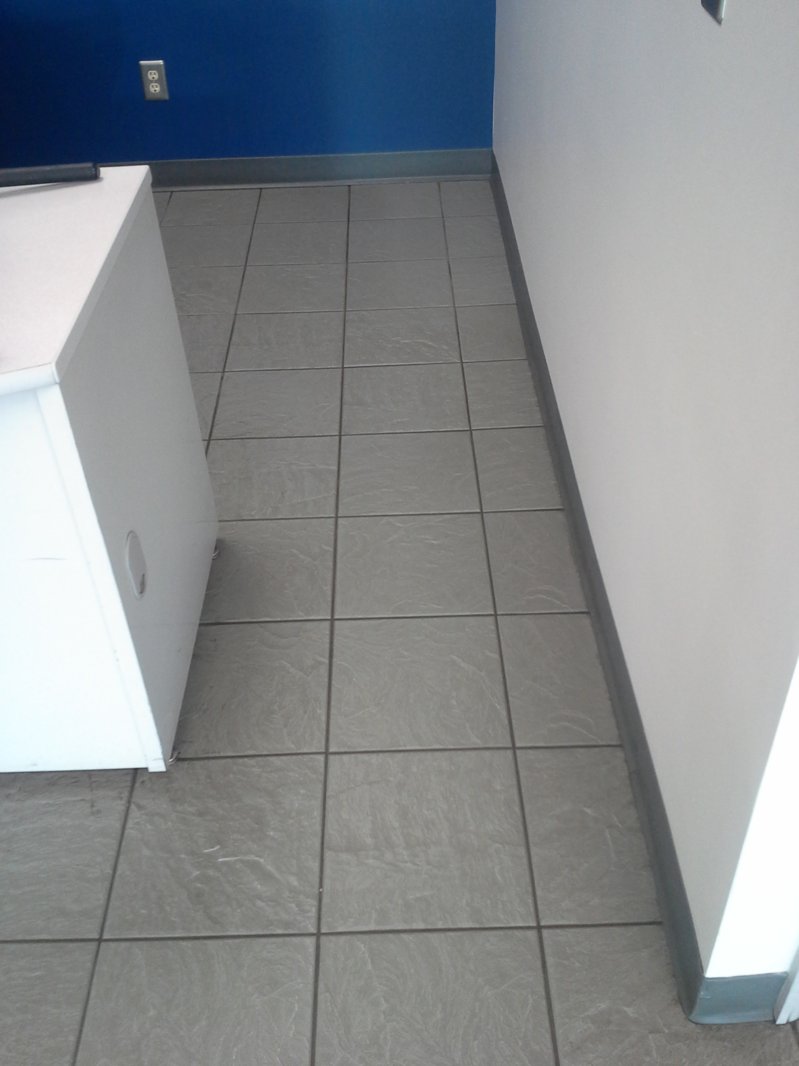

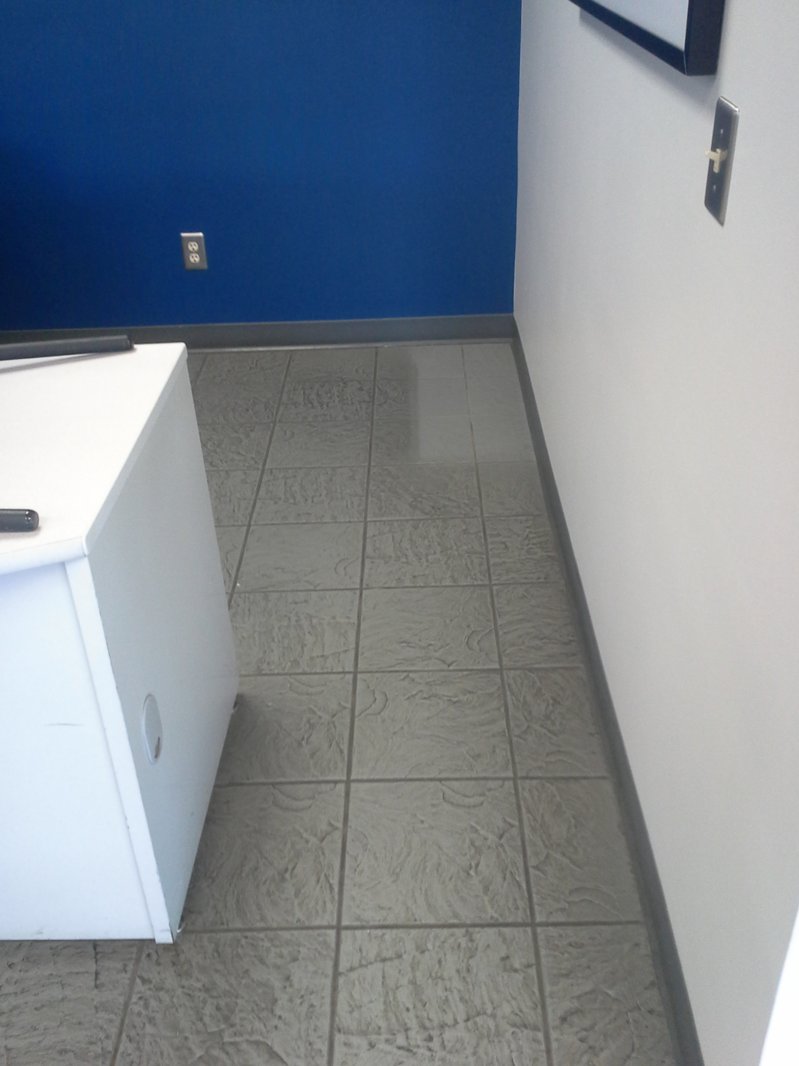

Jobs done and customer is happy. Took three of us about thirteen hours over the weekend. Ended up using the wand to suck up the goo.
