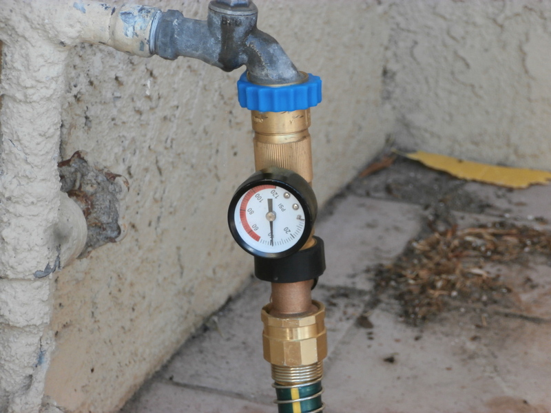

The older version has a float in the "water box". If you have high incoming water pressure the float can stick.
Get a 40psi pressure regulator and put it on the water fill QD.
Where do you get the pressure regulator?
http://www.walmart.com/ip/14504323?...81152350&wl4=&wl5=pla&wl6=34444679950&veh=sem
I use one like this, seems to work fine.
