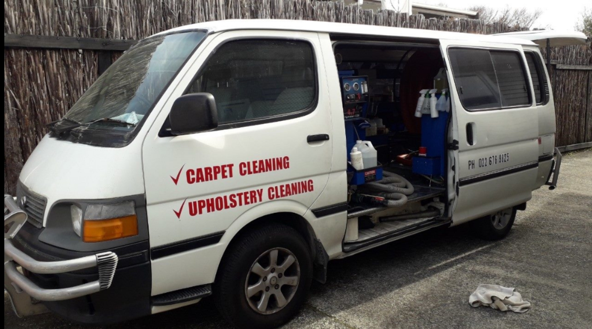

Can't run with the hood up if theres no hood..
been told its the only major manufactered direct drive in the country, suppliers here refuse to have anything to do with direct drives
I'm jealous every time I see one of those. Are you listening Hydramaster? Petition your federal government to lift the chicken tax.
