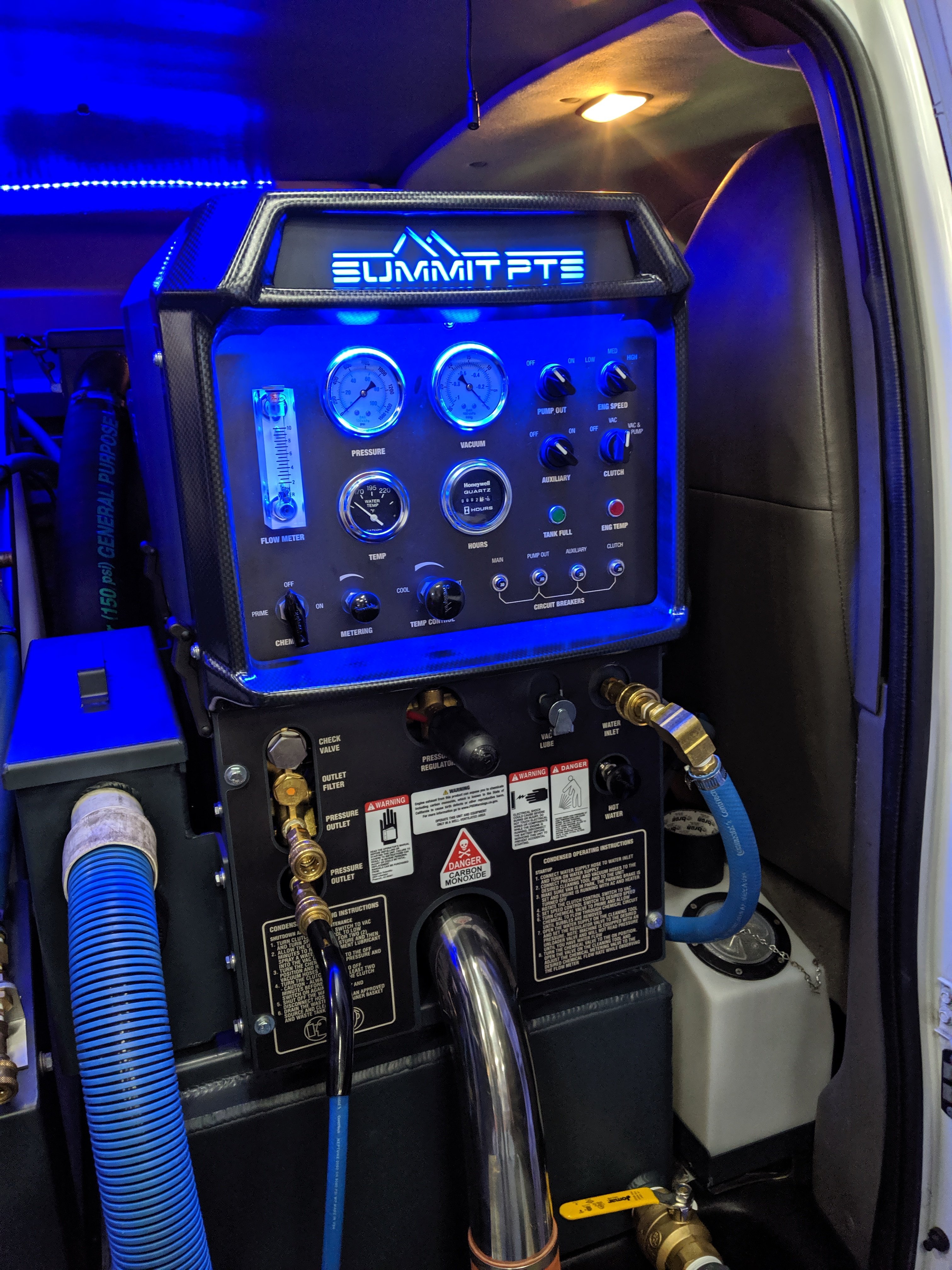

That’s it; that’s the way to do it. Change the name and hope they’ll come back to it!

The PTS IS the pro1200se, Finkle is Einhorn... They updated the look and made a couple small tweaks and that was it. The hood up in the promo video is the most damning evidence
