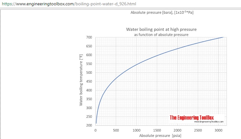

A nice little physics lesson that would benefit any carpet cleaner is the science of "superheated water", that is liquid water under pressure above its nominal boiling point of 100 C. or 212 F.

Very familiar with real steam in a previous life in maintenance for a dairy processing plant. Always turn the water on before the steam valve, and when finished turn the steam off first. Will be nasty if you forget.
If you suddenly depressurize superheated water a small part of it may pass thru steam phase.
That isn't "steam service"
and it really is unlikely considering how much even small PSI increases raise boiling points and the cooling within lines

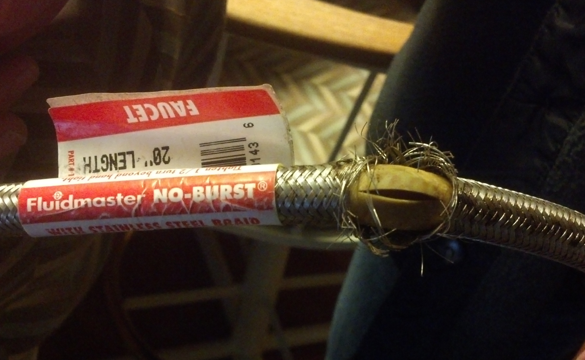

As strong as steel braid is, it is not bullet proof.
If water with cleaning or rinse solution gets between the braid and the liner, it corroded and breaks. At least that's what happens with black death.
This is a hot water hose to the washer at WDR loss we did a couple of years ago . State Farm used to hand them out to their insured. At least until they figured out they had liability in doing so. :biggrin:
We had to snap a picture. "No Burst" lol
