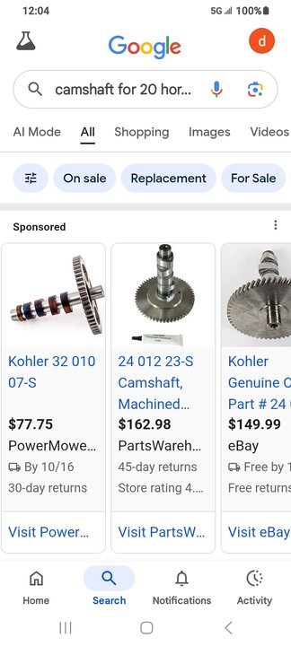

Never heard of a "loose wobbly cam shaft" before. Ive heard of spun bearings, rounded lobes, warn out thrust bearing but never loose wobbly cam shaft. I would question more before throwing out the motor cam moving in and out would suggest a thrust bearing up and down cam bearings possibly cam too bearings should only be 50 or so bucks+labor and a complete camshaft 100-150.00. Might as well replace your "high volume kooparater" while you're at it( that part connects to the throttle waddle on a ducks ass. ) not to be too sarcastic . But it sounds to me like this company is like the transmission shop in my town. For a 30.00 part and 250.00 labor they told me i needed a new transmission 3780.00+labor
