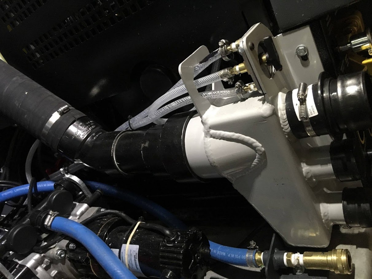

I like it, I generally only run 3 rinses. A acid prob 80% of the time an ammonia about 15% on white trash hell holes and a acid based encap on fine fabricI’ve got a simplified version on my Cleanco. It came with a 2( or 2 1/2 gal.) rinse tank. I found it would run out half way through on most bigger jobs. It took me all of a week to come up with something better. I added a 5 gal Prochem jug for alkaline, and I added a 20 gal for acid. I just extended the rinse hose. When I need acid, I just put the hose into the 20 gal, when I need alkaline, I just put it in that jug. Works very well.
Nice!I think all truckmounts should come with a three way valve for switching from an alkaline to an acid rinse..
The AT came set up, I made one for the V and I'm going to copy the Pemberton creation on the new Everest..

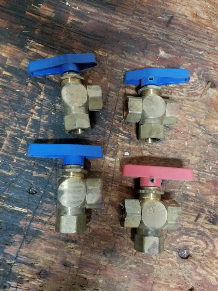

If you remember correctly...I did this years ago on my old Vortex when I was changing everything around....I have some extra valves left over if you want any....View attachment 78140
....so what are you doing now?no I dont...
nothing...I have not used a rinse since my Vortex pulled out of here... but after talking with someone during the RMD house cleaning in Vegas...I may hook it all back in......dont know yet..
