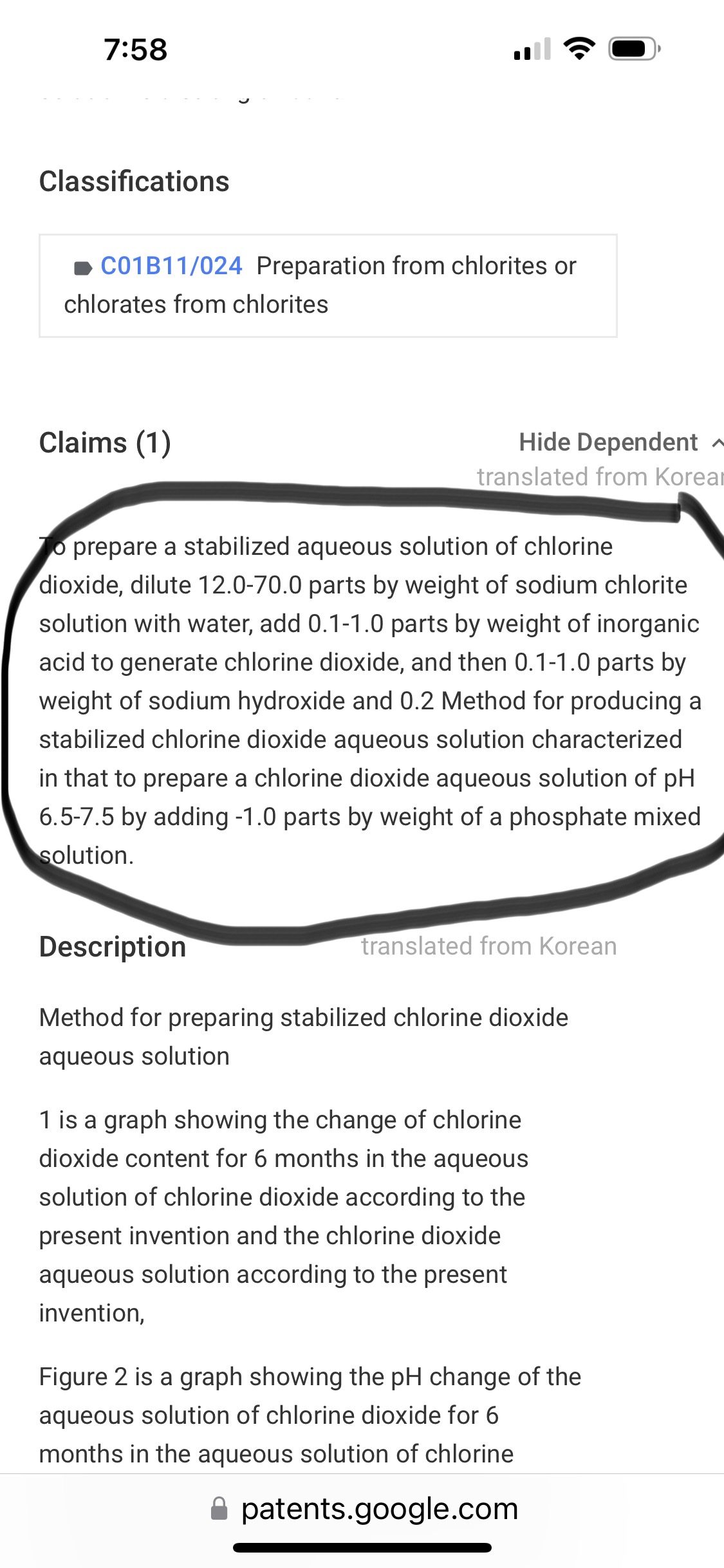

Be careful mixing sodium chlorite (CLO2 products) with peroxide. The duo can cause nasty bleaching.
Also, sodium chlorite doesn’t actually convert to a mild CLO2 until it’s acidic and it doesn’t take much.
For urine deposits, I mix sodium chlorite with PCP and add a pinch of Prochem acid rinse to barely get the solution to the acidic side.
That solution annihilates urine.
The sellers of the so-called “stabilized CLO2” products don’t mention this because they don’t want people going too crazy on the acid side. The problem is those products are absolutely not CLO2 unless acidic.
You could also mix your CLO2 product with Silver Solution since SS is just acidic enough to convert the sodium chlorite to CLO2.

Did you actually try to mix sodium chlorite with peroxide? LOL . Of course it's gonna cause nasty bleaching. Peroxide adds the missing chemical element that makes it a liquid chorine bleach which is hydrogen.
And adding a pinch of acid rinse to it, did you do a ph test to see if it really drops down to and acid? Because it seems that adding just a little acid would just neutralize it and weaken it. I think the purpose is to kill odor causing bacteria only, not help emulsify any of the gunk that makes piss sticky
It’s easy to see when sodium chlorite converts to CLO2. The solution gets a green tint and starts smelling like weak chlorine.
I’ve done lots of testing. When I put diluted sodium chlorite on a piss spot, it takes time for it to work.
Acidified sodium chlorite (CLO2) almost works instantly.
I’ve also tested it with piss in a cup.
Night and day difference.
PCP is 7 ph, so it doesn’t take much acid to push it over. I usually don’t mix PCP in the solution though.
And no, I didn’t mix sodium chlorite and peroxide, I know from research that it’s no bueno.
If you’re not acidifying sodium chlorite, then you’re missing all the benefits. Sodium chlorite is merely a weak oxidizer and is not CLO2.
