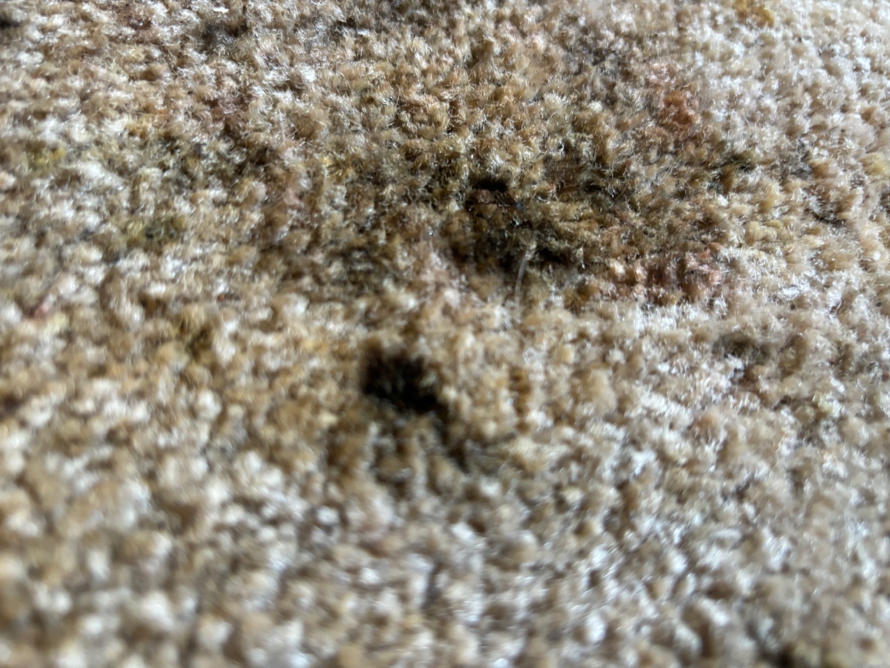

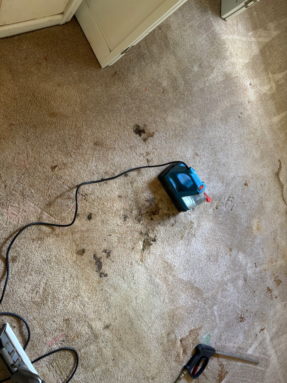

It’s not fecal blotches that the picture makes it look. It’s a combination of grease and chewbaccer. Mostly drink spills as well. I’ll have an after pic in a bit 🖕🏻

Now you’re calling me a liar which I don’t take lightly. There’s no evidence of a litter box in that room and the dark spot don’t smell like fecal matter
But to make your judgmental ass feel all bubbly inside🖕🏻, I offered to not charge them after I cleaned it because I told them it would come out more presentable than I expected since they’re selling the home
I cleaned a total of 9 areas of carpet and tile in this home and the seller was happy with my cleaning.
So hall-monitor Fred, did I do it better? Should I repent for my wicked evil ways of doing business?
