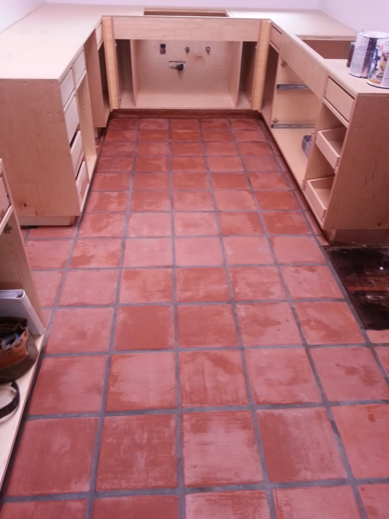

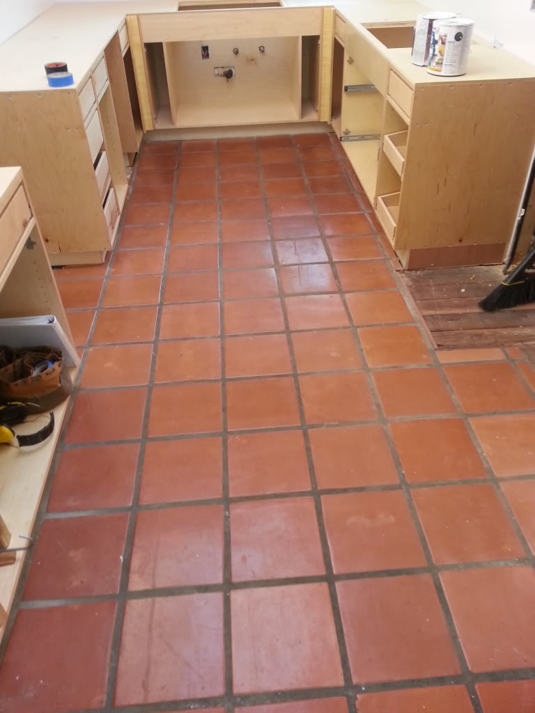

today's Saltillo Job
117,376

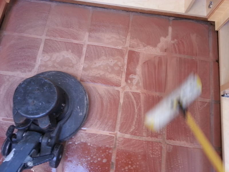

just these 70 or so feet took 2 hours to strip.
I'll go back tomorrow to apply 4 coats of wax/ finish
pretty much have to charge $10 a foot to make carpet money stripping Saltillo tiles.
20 plus year old floor, never dealt with..

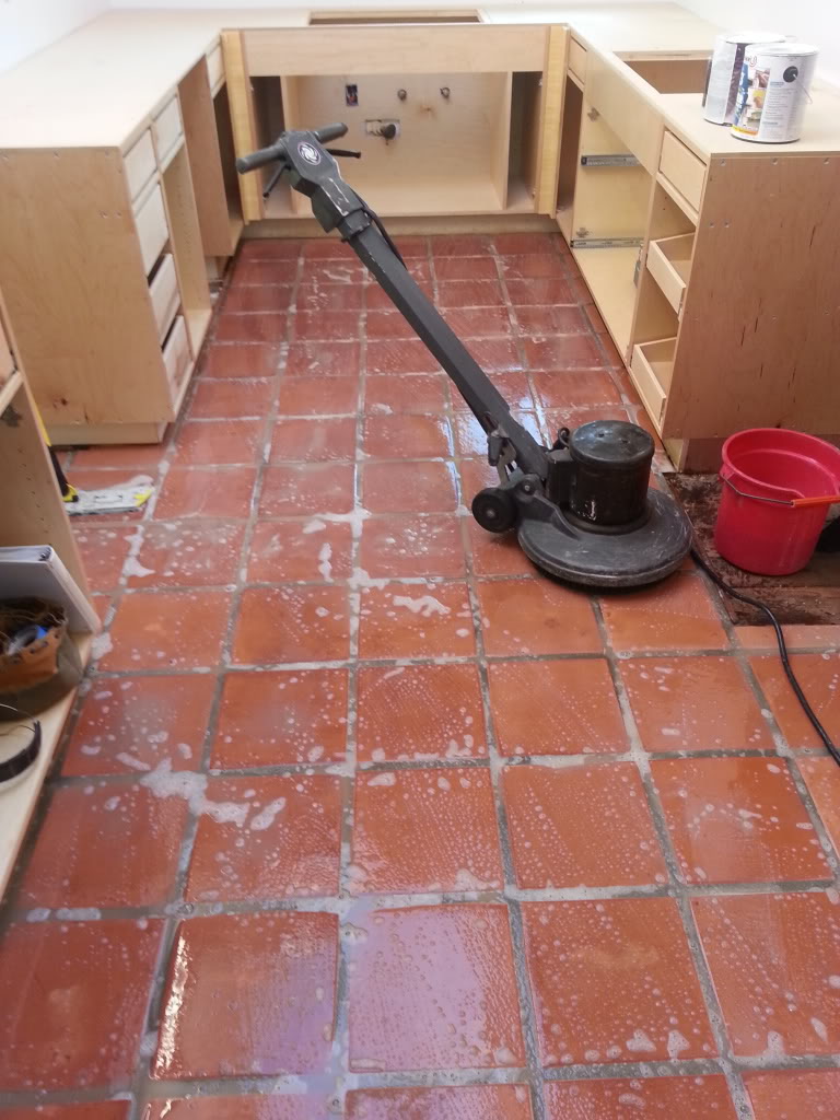

soaking in Zep stripper

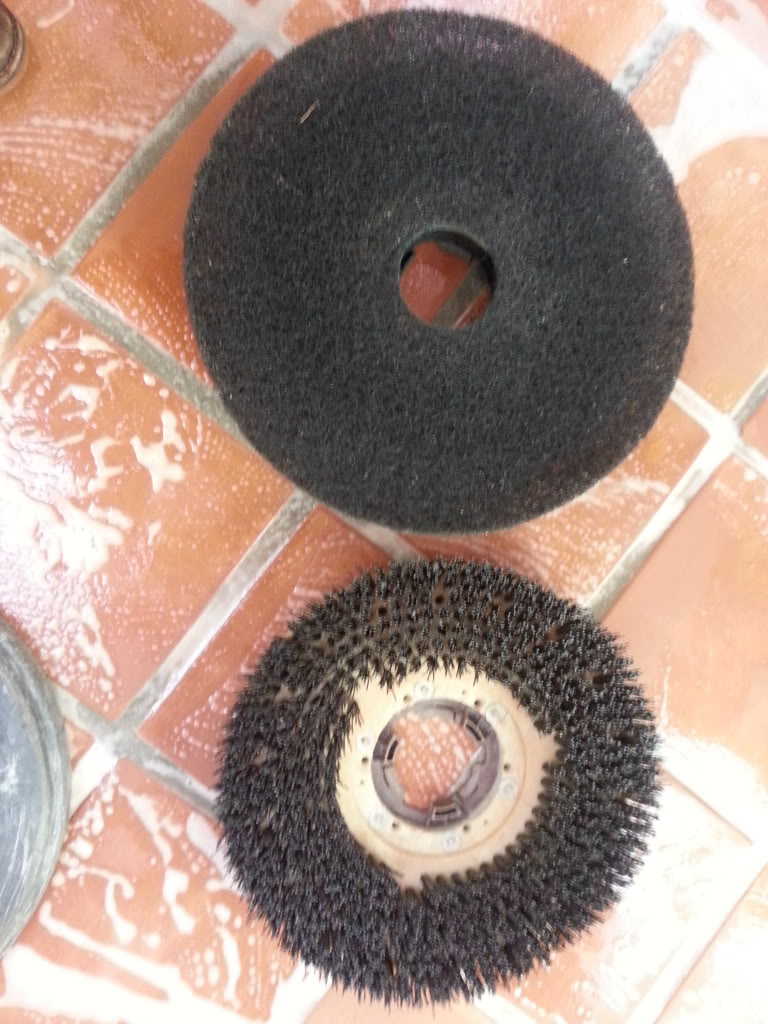

Went over and over and over with a Malgrit brush and a black pad..

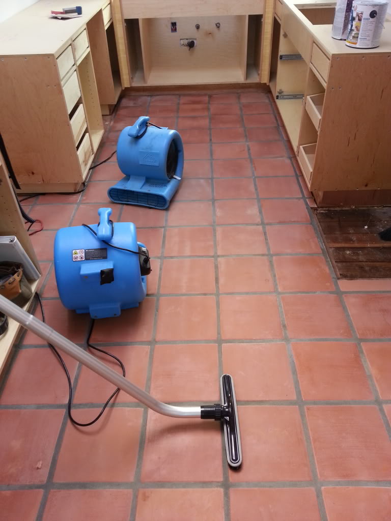

fully naked and drying..
more pics tomorrow..

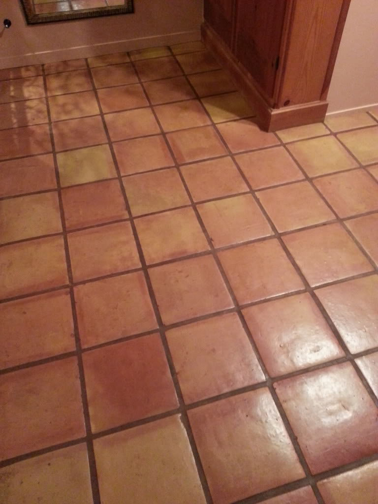

let me get this straight, polished marble looks "better" than honed or tumbled?
I guess that explains the bald head look...lol
I personally don't like an ultra glossy floor, and neither does this homeowner..

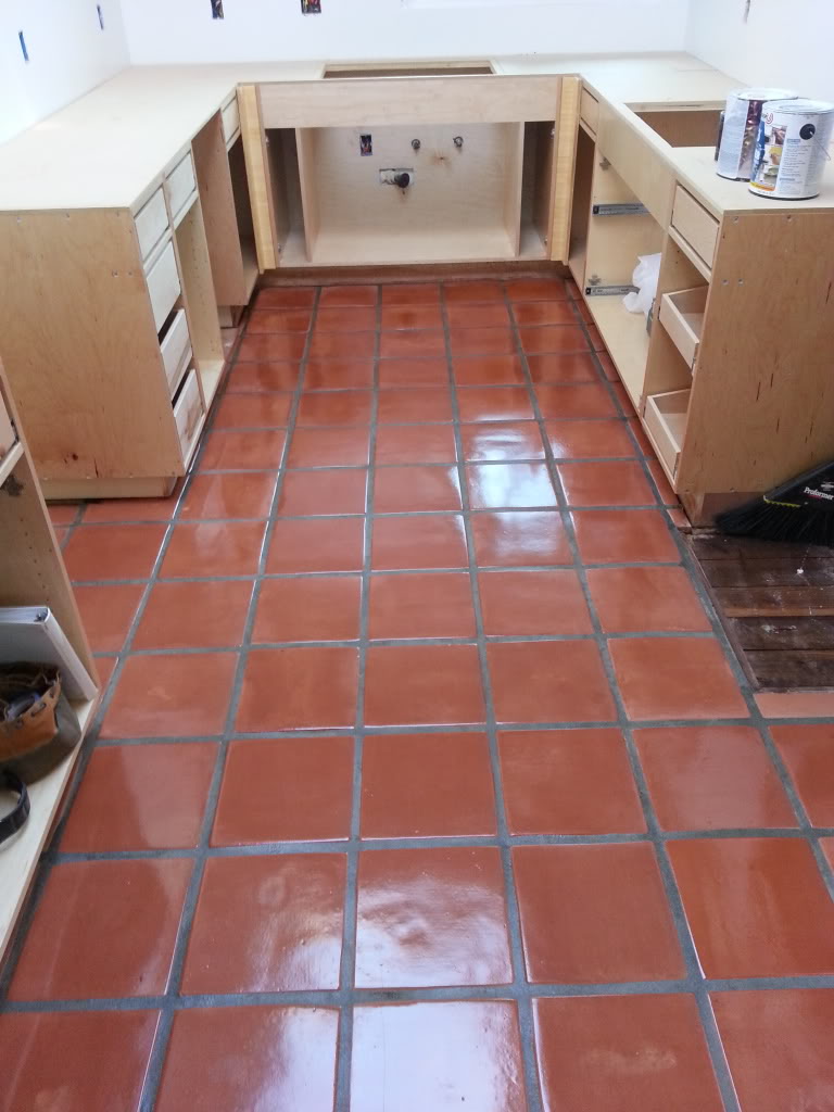

flat mop it on Dave.
good finishes self level and dry in 10 to 15 minutes.
thats the easy part.
getting the old stuff off can be a nightmare, especially if different products were used over time. If some idiot put an epoxy or lacquer finish on it, run like hell.
strong stripper, scrub scrub scrub rinse repeat...

I like the flat look also. Too shiny and you are blinded at certain times of the day.
117,376
Its a house brand product called Brilliant Shine. Its the janitorial shops highest solids product
