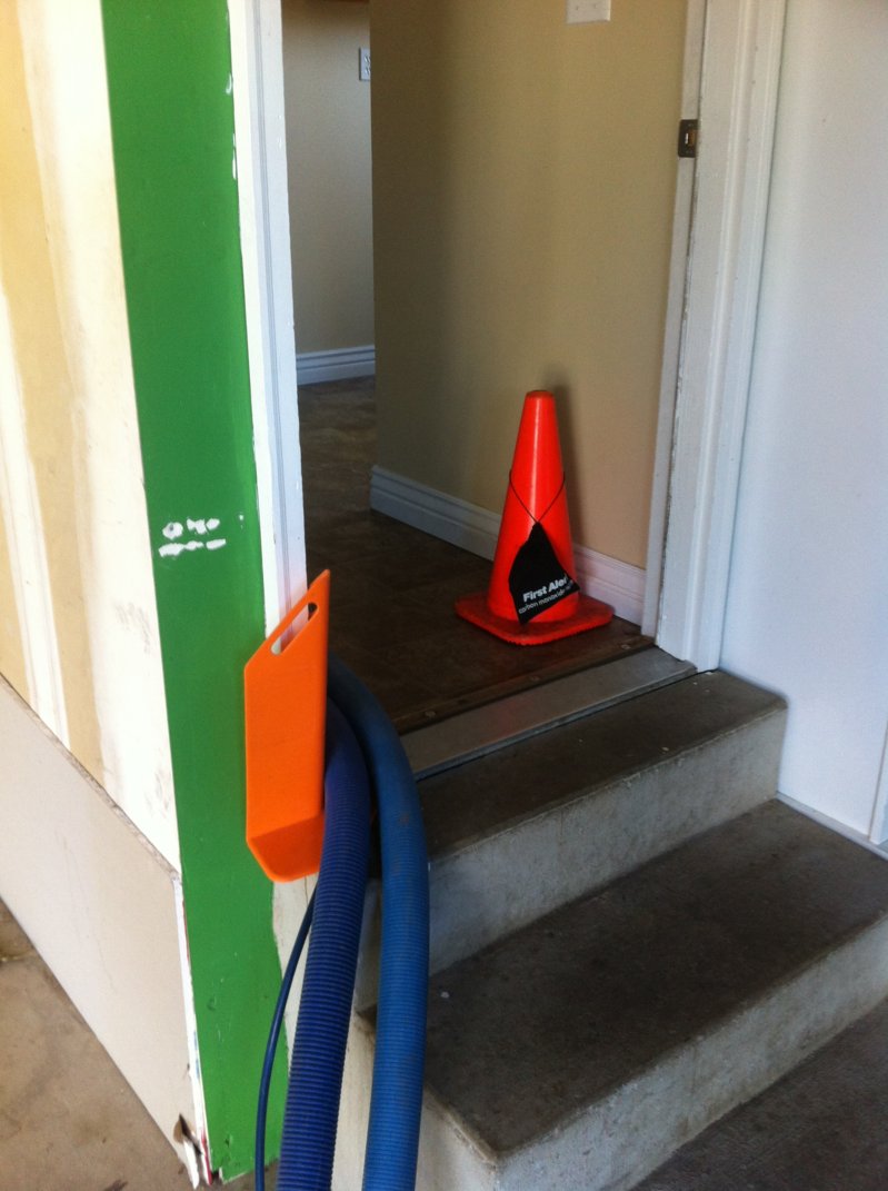

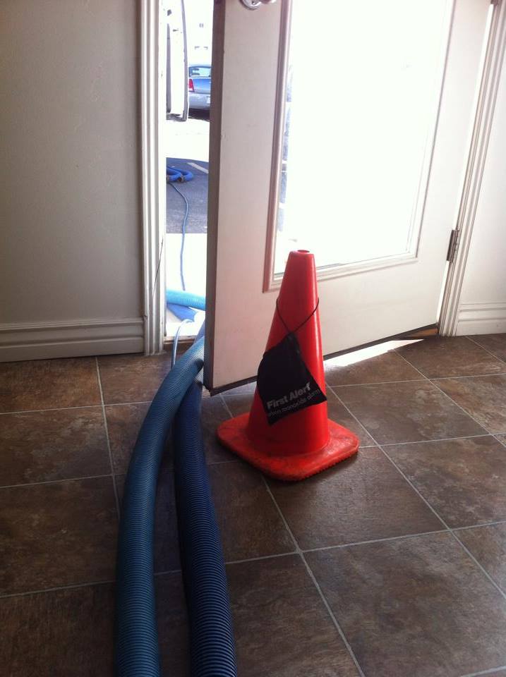

I would always carry a CO detector inside when you are running LP there.

Like Bob recommended, a CO detector is essential. https://www.aircraftspruce.com/cata...M_BC-V5MZTzfXTkkmIsCfkwY06k_W-HYaAg3SEALw_wcB
I just ordered a few of these. Thanks. Where is the best place to set these to be most accurate while I'm working in the building?
