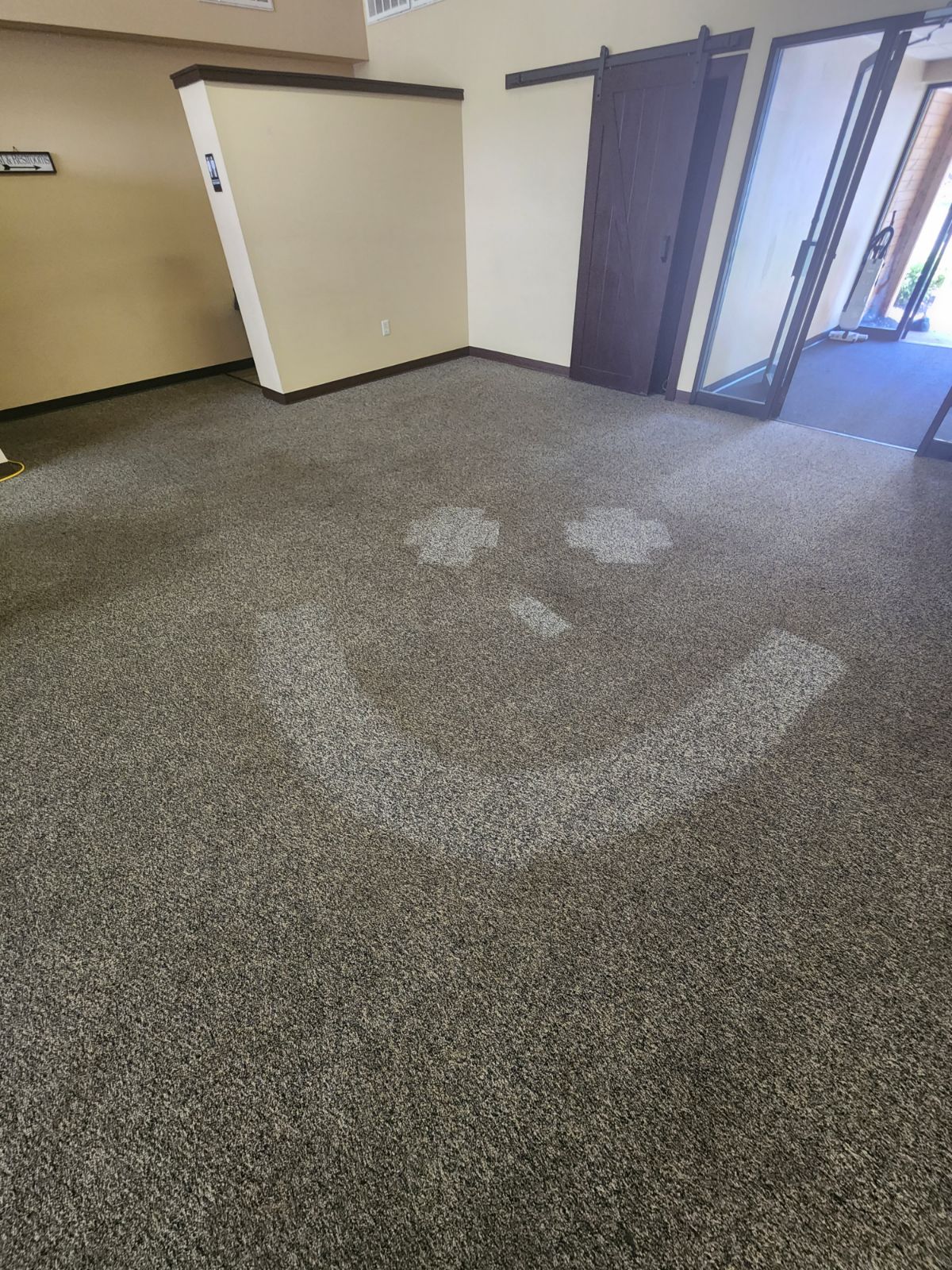

Our best customer yet found us searching the web last week. The roof leaked last month and soaked the carpets. All was repaired and dried out but the carpet looked terrible. She thought it was water damage because the dark area was exactly where the water was. When I met her and took measurements of the space I brought in a spray bottle of encap and a terry cloth. Sure enough the dark area wiped right up. It was soil wicking from where the water had drenched it. The manager was very happy with how it all turned out today. Cleaned up nicely.

The place only had cold water while we were there. I was worried it would hinder cleaning it well. Bridgepoint Flex powder is awesome stuff. I am really impressed with that prespray compared to everything else I've used.

Did you find out how long the carpet had been wet? You mentioned it was drenched. My concern would be what's under the carpet and in the padding.
When trying to correct wicking I always try to be on acidic side. I agree Flex is a good prespray, but this situation you would have been better off with Flex Ice or an Encap.
I'm not trying to take away from your good day, just some of my opinions.
If you have all your bases covered and your customer is happy that's all the matters.

Thanks man I appreciate the helpful critique. They had insurance and a third party take care of the water damage and restoration over a month ago. The floor sits on cement. Insurance just didn't pay to replace the carpet so they wanted us to clean it. Place seemed bone dry. The guy that used to do all of their carpet cleaning recently retired.
I didn't feel compelled to check under the pad because of the situation, maybe I should have? I was just called for carpet cleaning though and it seemed like there weren't any underlying issues.
About the potential for wicking. I have Encapuguard by Bridgepoint which is 3.5 pH and designed to help prevent wicking. Maybe I should've used that? I've never even opened it yet. If one speed dries with multiple air movers like I do (used 3 today) is wicking ever really an issue? I haven't come across it yet. But I always use a bunch of air movers....
Sounds like all your bases were covered and your customers are happy. Job well done.
Encapuguard is a great product for wicking. I used to post bonnet every carpet with Encapuguard, it always left the carpets looking great. If you got the wicking to go away and stay away, that's all that matters.
Even when speed drying and perfect wand strokes, some carpets are just prone to wicking, but thorough cleaning and removing as much moisture as possible is your best defense.

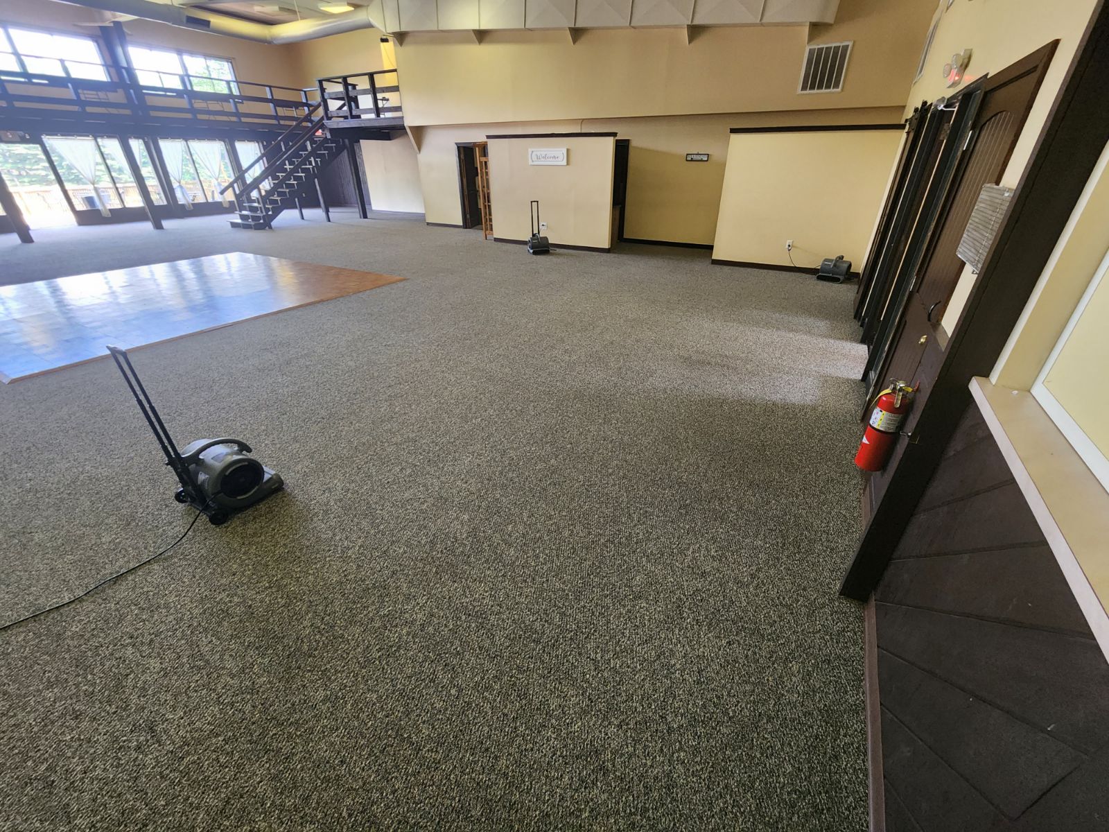

I think it was @Mikey P Had a good thread here once about the importance of placing an air mover down as quickly as possible once finished wanding. The carpet drys so much quicker if the moisture isn't allowed to soak down in. I find the same with dry strokes. That if you dry stroke immediately vs doing half the room and going back. The quicker you extract the drier the carpets.

Excellent. I'm learning to be up front not through my own experience but rather pre-empting through others mistakes and advice here on the boards and elsewhere. Wicking still hasn't happened yet, even once as far as I know. Which I find really interesting looking back because my portable is sweet but in regards to vac is stunted. The PEX 500 has both it's vac motors on 1 circuit, well designed to be as much as can be on 1 circuit but weak compared to a portable that has 2 larger vac motors on different circuits with no heat (mine has a 2000 watt heater).
My service/travel area is much too large to reasonably leave air movers to be picked up later. This emphasis you share on using an air mover as soon as possible after wanding really strikes a note with me, quicker extraction and drying, critical. I do move fairly slow with my dry strokes in res. Although commercial I have been moving arse and speeding up my dry strokes to finish given jobs in allotted times, which has left me worrying. But also using stronger chems in com to reduce the need for so many wet strokes. So far zero call backs and I follow through with all of our commercial clients to make sure no problems popped up for them later. They are all thrilled. They even write me raving emails and messages. Just got another one from the very client I wrote this post about tonight.
My best guess without having gone back to check on my own work is that I am riding the line, on the edge of wicking yet it hasn't happened. Maybe part luckily and part intelligently due to thorough research and thoughtfulness on the job. I'm on it with cracking windows when the weather is right, using air movers, always doing about 2:1 dry:wet passes (although with the power of my vac it may ideally be 3:1 and a touch slower), not over wetting unless absolutely necessary, etc...
