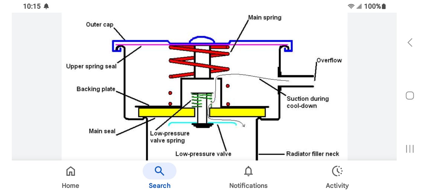

Im 99% sure your radiator cap is the problem. Something is gooping up or somehow not allowing the vacuum check valve to open so coolant expands and moves into the expansion tank when hot and as the engine cools it contracts creating a vacuum and is sucked back into the radiator. If the vacuum (return check valve) doesn't open than the coolant is trapped in the expansion tank. Now the other 1% can be a leak in the system where as the engine cools it draws air in instead of the coolant. Also compression leak can over pressurize the cooling system and blow coolant out. I would've been 100% sure that it was your cap had the hoses been collapsed but if you fix the leak at the thermostat and your oil doesn't have any coolant in it(be sure to.look inside of the oil fill cap )if inside the oil fill cap has a little moisture probably no a problem could be short trips motor didn't heat up enough to evaporate moisture pulled in thru the crankcase ventilation system. However I don't believe this is the problem because of the fact that temperature remains normal and additional coolant doesn't blow out during normal operations. But if there's alot of white greasing goop there could be signs of bigger problems. Im not telling you this to frighten you rather more of an opportunity to educate in trouble shooting so if this is a simple fix maybe the sky won't be falling and expensive parts aren't dying be the frist thing that comes to mind next time

Running the TM would definitely over fill the tank every time. Constant water being pushed into the cooling system. I'v had to replace radiator caps. Make sure you don't mix gm coolant with non gm, it will gel up.

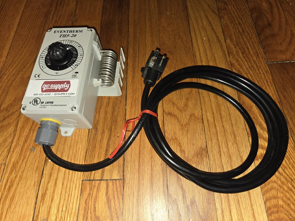

I am heating both my van and my trailer when parked at home now. I got 2 of these sweet greenhouse thermostats to turn a small space heater on and off at whatever temp I set it at, I'll probably go for 45 degrees. I know from experience that electronic appliance thermostats fail randomly and regularly.
And I have 2 of these Marcell wireless temperature and power monitors that send alerts to my cell phone if power goes out or the temp drops below whatever range I have it set to. I used 1 in my trailer last winter and it worked great, just got a second one for the van. They operate on cellular networks and cost about $10/month for each unit. I subscribe to it from October until April. Setting it all up this weekend. Looks like the temps will be well above 40 degrees the next several nights here.

Sounds
Sounds like you gotta solid plan
  • Love
Reactions: Bryce C

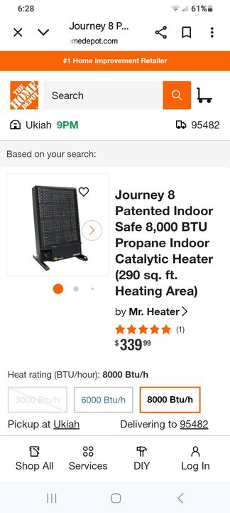

If that works for you, as I've said i have no experience with extreme weather too hot or too cold. But. I personally couldn't go back to operating a portable after running a truckmount. Even back in the 80's when my backup was a portable. I never used it after running a tm.
Dwain Ray
Jul 22, 2020
702
Ask around , how do other cleaners do it in the winter? Im pretty sure they don't just shut down? I doubt if many have portables settin around?Do they carry small propane heaters in case of a breakdown? Maybe setup to blow air thru the system to flush out the water? Propane heater on a 20lb bottle would be my first thought
I'm thinking of shutting the van down mid November. The thought of my van breaking down on the road and freezing bothers me. I built my business with a portable. I think I'll run my portable operation from my insulated trailer for the coldest months of winter and fire the truckmount up again sometime in April. I'll run windshield washer fluid through the system but still keep the heat going in it all winter.
Screenshot_20251011_183102_Chrome.jpg Screenshot_20251011_183044_Chrome.jpg Screenshot_20251011_182853_Chrome.jpg
Bryce C
DFW
Feb 9, 2024
1,135
Bryce
I haven't used small propane heaters like the Mr Buddy, just full size ones in my garage. I bought a brand new Mr Buddy for my trailer and portable setup a while ago and the thing didn't work right out of the package. When I went online reading about them it seemed like they can be counted on to fail. I don't know what was wrong with the one I purchased but I returned it. It was a disheartening experience and since then I have just checked off small propane heaters as a possibility. I think the safety features on them often cause them to fail.
I'd probably have better luck carrying around my Honda 2200 watt inverter generator and my electric space heater. Although that is heavy and takes up quite a bit more space.
